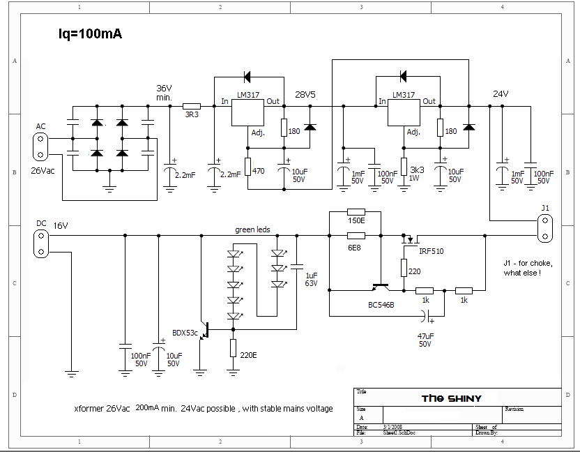

Should I expect higher noise and THD figures, if I use LM 317 regulator with CRC filter for PSU instead of discrete one?🙄
supernet said:Should I expect higher noise and THD figures, if I use LM 317 regulator with CRC filter for PSU instead of discrete one?🙄
use stacked 317s , with both heavy bleed and mucho uFs on output
( in that case with all necessary diodes for chip protection)

OK.
I will use two separate regulators for each channel. I was thinking to use 2X4700 uF 35 V before LM 317 and 100 uF at the outout. For the buffer, I will probably use two 4700 uF caps / mono channel instead od 15000 uF.
Should this be OK?
supernet said:
OK.
Should this be OK?
when I wrote stacked , I meant as in attached schm . - cascaded 317 , with ref leg of input one connected to output , not to ground ;
that way input one is prereg for second 317.
heavy bleed - I meant - put resistor load on output of reg
in fact - you can pretty easily use exact schmtc
