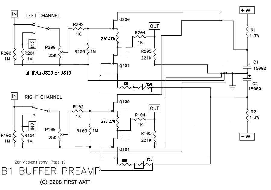

Since I was too late to buy the board (oops!) I decided to build it p2p.
Lesson learned - don't attempt p2p layout/soldering when dog tired - mistakes abound, and i have given up for tonite!

the sk170s don't need to be matched in that they do not form a balanced LTP stage.
However, it seems that much of the reported excellent performance comes from operating the stages at the correct Id and this requires that the CCS allows the upper device to stay within it's optimum range.
Some minor tuning of the lower CCS resistor could bring the upper device back to it's sweet spot.
The easy way is to select sk170s that are close to each other to get what Pass is recommending.

why don't you use 24V , with any 3-legged reg chip ?
It might even turn out to be better😎
Magura 🙂
merlin,
there is a guy on this forum (actually he posted it in this post only a couple of pages before this one) who measured distorsion depending on the value of this voltage. According to his measurement you get better distorsion value with 25 V than with 18V ... So do not be afraid ...
LSK389 suitability
I have 4 LSK389A devices which are listed as IDSS 2.5- 6.5.Are these suitable for the B1 ??? Or am I better with matched 2sk170BL???
Hi Sandy,
you will need to measure all eight FETs in those 389s.
The B1 does not need exactly matched FETs, but close Idss is desirable.
If you find that all your 389s are at the top end of the A grade range then they will work in the B1.
The big and only advantage of the 389 is the thermal coupling.
It is a waste to use these pairs for this B1 duty.
Otherwise no work? Why not?
