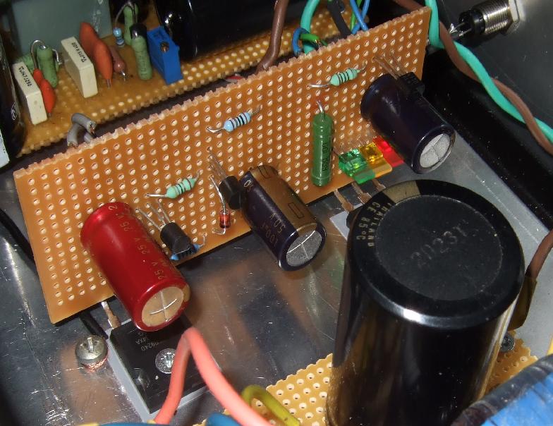

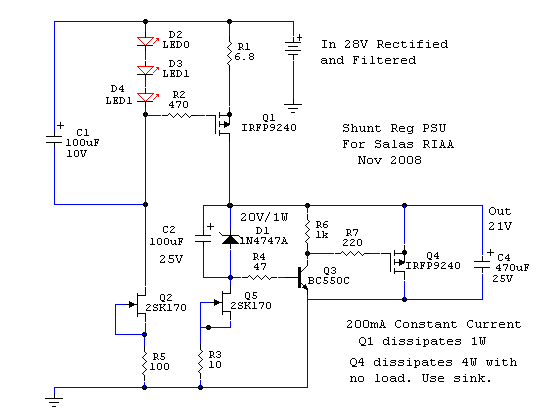

Compact enough, just warm, won't oscillate easily, readily available Mosfets, leftover unmatched SK170s. Iccs = (Vleds-3.4)/R1 (1W resistor). Start with 10R. Led string of 3 gives different Vdrop total depending on color and maker. Use green ones, more constant. I wanted it ''Kitsch LED Shunt'' so I used tricolore.😀
Haven't made a negative side. My Riaa is positive only, B1 is positive only with caps, you want to make a capacitor-less one with symmetrical PSUs like I did? I can try to mirror it on the simulator if so.
Neg reg
That would be nice, if you don't mind Salas.

OK, I posted negatives. If you ever make any, just let me know about the sound in comparison, since my shunt subjective experience is limited. They are posted in my RIAA thread, and here is the
link.
