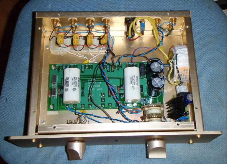

B1 Buffer
Mine...working great!
20k attenuator, relays for input-switching.

improve the supply
Arne,
Suggest you improve your basic supply....
As you already have the 317, simply add the parts to build a Teddy-Reg (on the "pinkfish media" diy section) on some strip board. Quite simple really and quite a change in behaviour.
On the NS-10 thread, the CE Toole shunt reg is coming together very nicely and appears to be even better.
