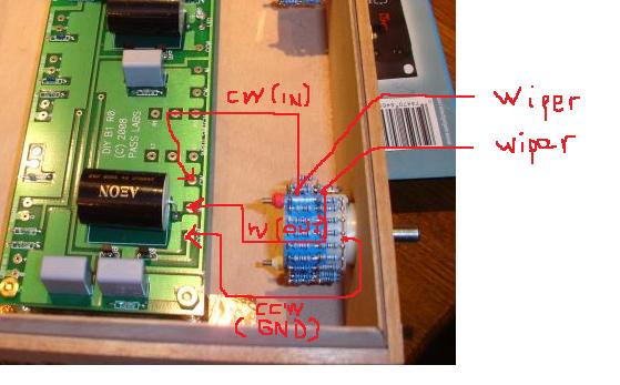

... B1 buit in a wooden cigar box.

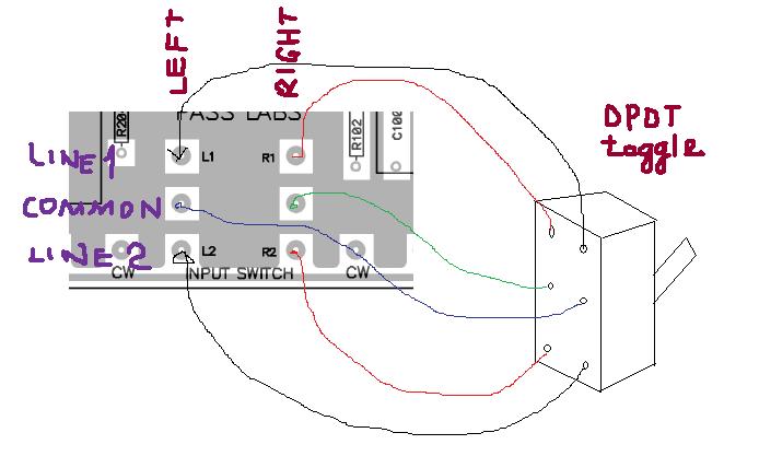

... how to hook up the six poles of the DPDT switch ...?

My biggest question right now is how to hook up the 6 poles of the DPDT switch to the 6 connections on the Pass-DIY PCB. Could someone enlighten me on this?
I have not yet added the DC jack. I intend to use a 18-24V AC-DC wallwort. Also I have not added the DPDT Switch to switch between the two inputs.
the 4 fixed contacts are fed from the two 2channel sources.
The two moving contacts feed the L & R channels.

My DPDT switch says 123 on one side and nothing on the other side. There are 6 poles on the bottom. On the Pass-DIY B1 board it say L1 and L2 with a blank connection in between, and it has a R1 and R2 with a blank connection in between. I was hoping that some one could tell me exactly where to make the connections. Like I said, I am sure that this is obvious to most of you, but it is not clear to me.
I have searched and googled this issue but I have been unable to find a clear explanation or diagram.
Thank you for trying to answer my question. I am sorry to say that I don't understand what you mean.
Looking at the bottom of the switch you see two rows of three pins. Let one row be right, the other left. Connect L1 to the left hand one, L2 to the right most one and middle to the middle. Same for the R1 and R2 pins.
Basically, the board layout is the same and the pins on the back of the switch. On a normal DPDT switch the handle position is the opposite of the pins on the bottom for contact.

Sorry . . . I misunderstood . . .
I was looking for DPDT switches. Some are On-Off-On and some are On-(On)-On. Which one with switch between two positions without being momentary or other.
Thanks,
Vince
Thanks,
Vince
Thank you hayenc! Thank you Babowana! That makes it clear.
What do you think about my grounding the PCB to the two strips of copper tape in the bottom of the box below the PCB? I used bronze bolts through the corner holes with bronze washers and nuts to secure everything.
Could I use copper tape in the same manner to ground the rca jacks and dc jack? This would seem like Babowana did in his B1 with a metal plate to ground the rca jacks.
