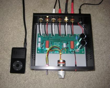

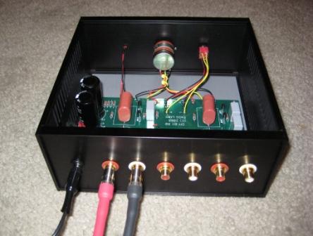

I just finished my first B1. It sounds great so far. I do have one problem with it however. If I touch the chassis, source switch or volume knob I can hear a faint hum with the volume set above 12 o'clock. Any ideas what could cause this? I searched this thread but didn't find any related posts.
Thanks,
Bill
Thanks,
Bill
Try taking all the insulation washers out from under all the rca's, it looks to me that your chassis has no reference to system earth. By removing the plastic washers your chassis will then be on the same ground potential as the interconect sheilds form the power amp which will then be the same as the cd player.
Then the only component that should have an earth conection to mains earth via the mains lead will be the power amp, the cd player should not have a mains earth conection as it will get the earth then from the interconects again, via the B1.
Cheers George
Cheers George

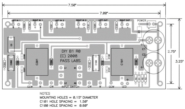

i would not remove all the rca insulators because you already have individual ground wires going to the circuit board. doing this would create a loop.
i would place a single wire from the chassis to the ground plane/star ground. you can easily test if this will work with a wire with aligator clips.
you may want to check that you pot is not electrically isolated from the chassis as your chassis appears to be painted.
Please look at the attached B1 board artwork. To me it looks like the chassis has 4 ground/chassis connections via the 4 mounting holes. (Assuming metal standoffs are used on all 4 corners, which I did.)
Again, it's not a usual ground loop issue. This thing is dead silent at full (0 dB 😀) gain. I only get a slight hum when I touch metal....
Also, my chassis is anodized aluminum, no paint.

anodized aluminum would have same effect as paint - it is an insulator.
use a circuit tester to check for continuity between the pot knob and ground.
Ah ha! That was it! I had continuity between the switch and the volume knob, but not between them and ground. I ran a wire from the front panel to ground and all is well!
Thanks for the tips! I appreciate it!
Bill
Bill
