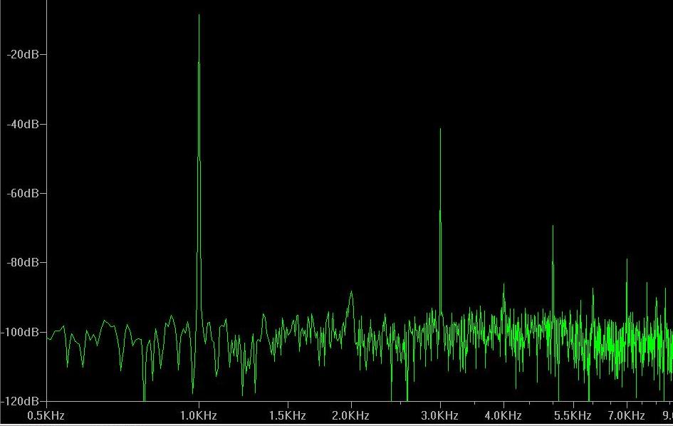

LT Spice
I am learning LT Spice at the moment.
So I decided to a spice model of the B1.
However looking at the distortion profile, their is mainly 3rd Harmonic distortion with no 2nd Harmonic.
This seems a little strange as I didn't see Nelson talk about their being any 3rd Harmonic.
Anywy has anyone else modeled this circuit?
The way I measured it, was with the following parameters (feel free to correct me on anything):
- Voltage input amplitude of +/- 1V (ie 2V p-p)
- Volume setting at 12 O'clock using 25k linear pot
- Load = 47k resistive load
- DC Power = 18V
I am a little unsure of the CD Player spec. Is it 2V rms, 2V amplitude, or 2V p-p?
Anway have a look at the attachment.
PS This is an awesome tool for understanding circuits.

Re: LT Spice
- DC Power = 18V
I did run some actual FFT through B1 when I made mine and the even order was dominating odd order in all orders. It also distorted the less, the more I turned the volume clockwise.
CD is about 6V P-P.

Did you use LTSpice to do your FFT measurents, or were they real measurements performed with a distortion analyzer?
Anyway here is the attachment.
