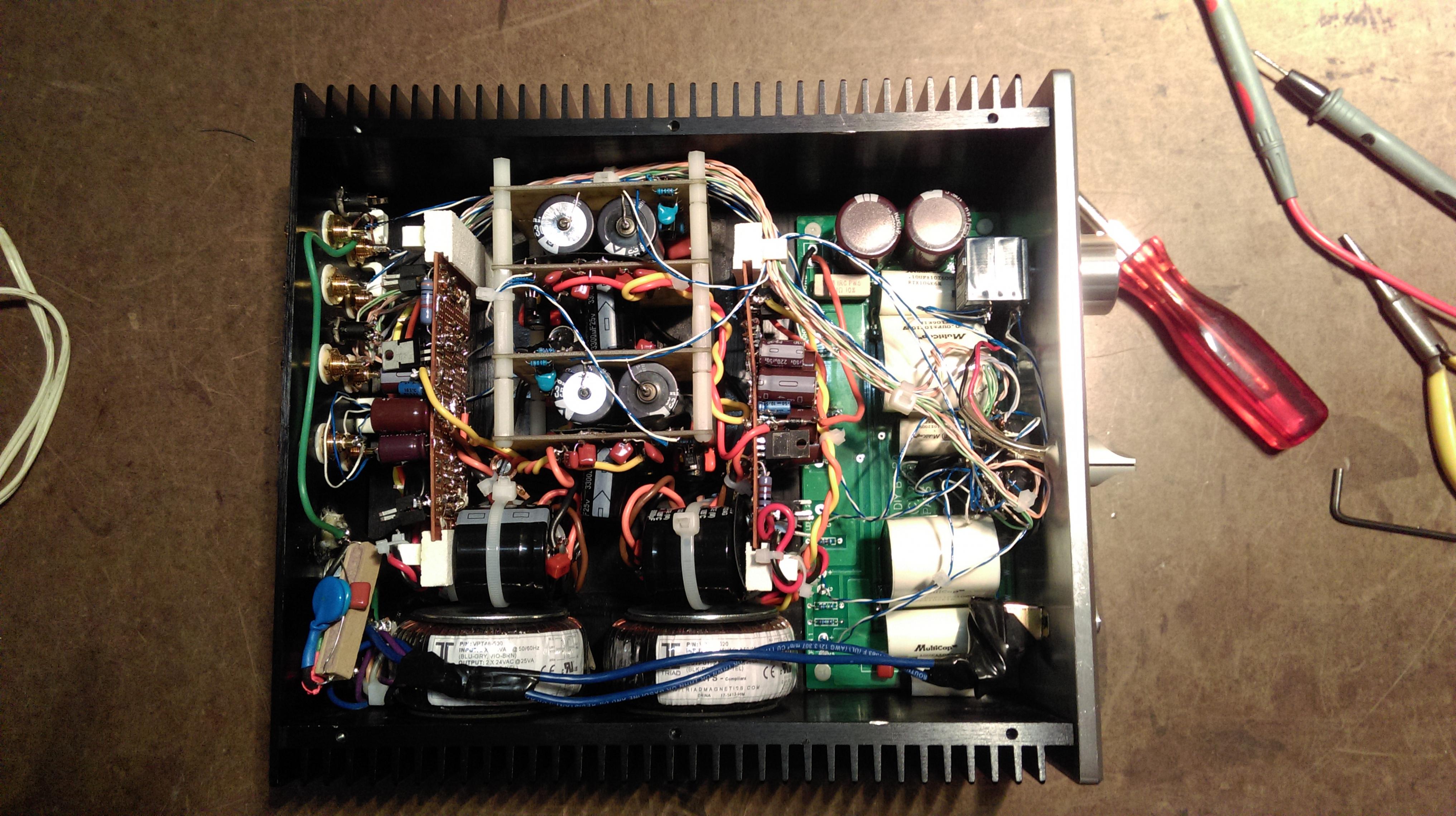

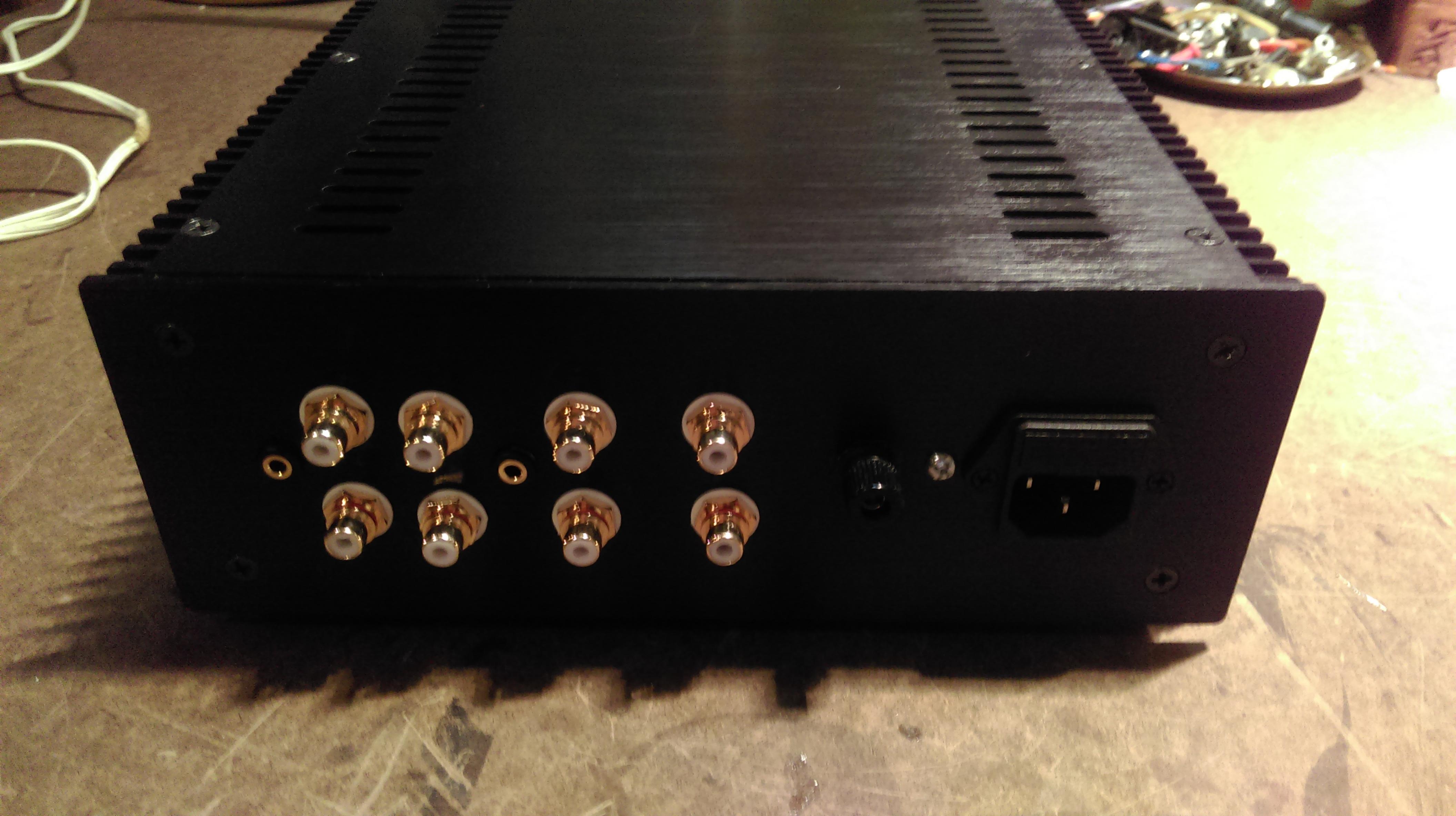

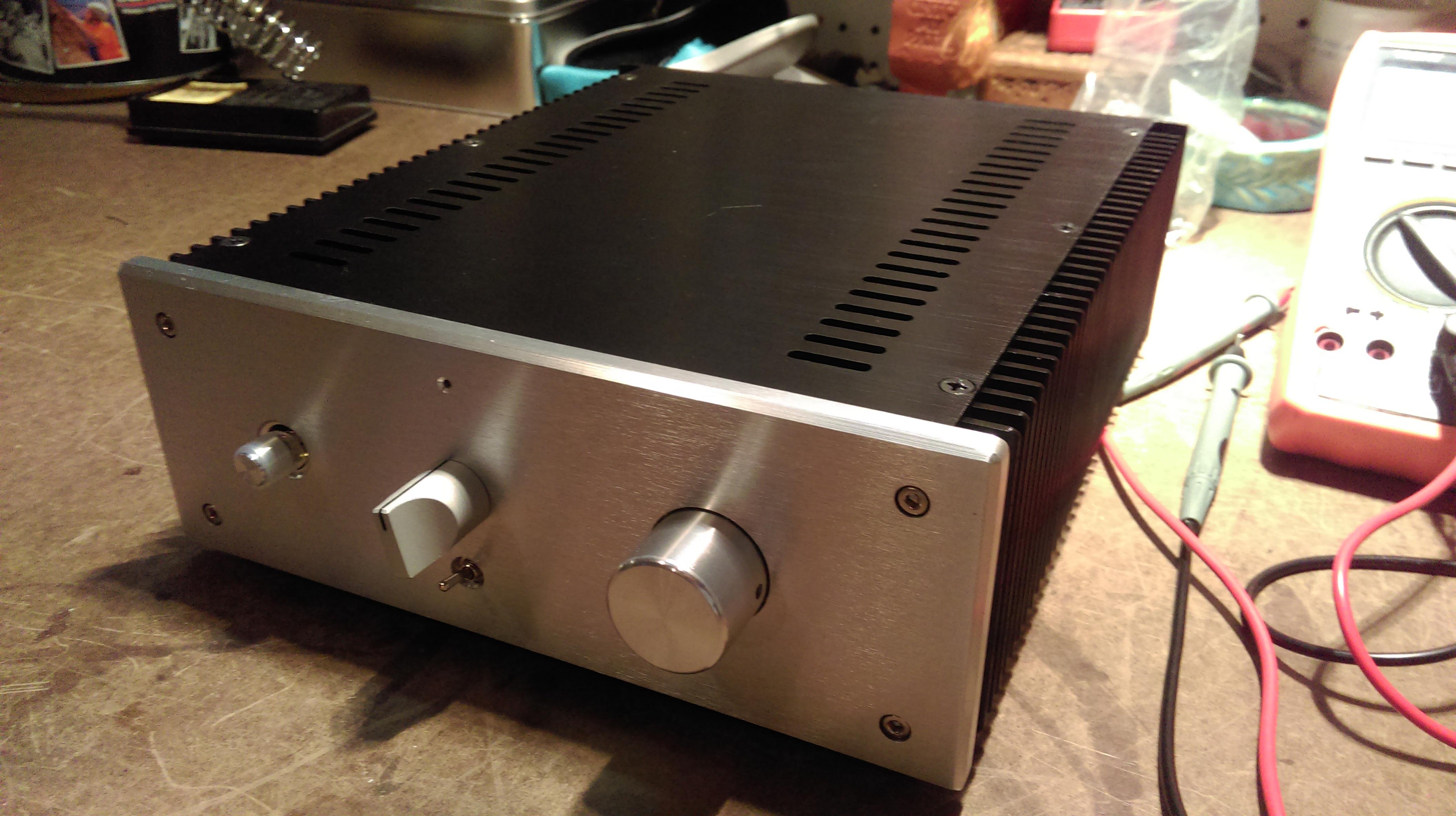

I used a simple zener voltage reference with a follower on mine. Lots of filtering too - but it sounds fantastic!
