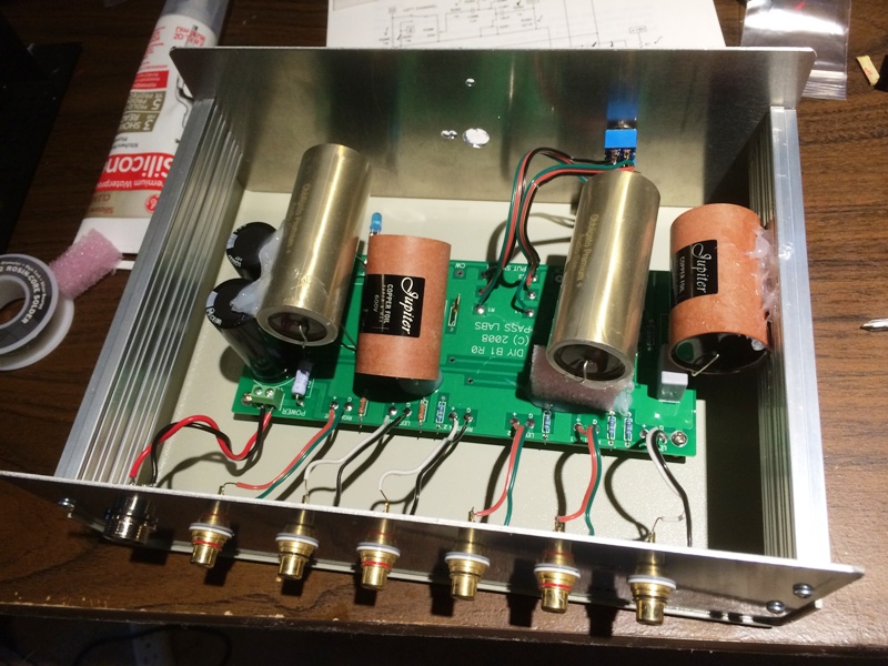

A B1 Story
I was debating, since this past Saturday, whether or not to post on my findings. Might come off as rude, pretentious or crazy by some or simply unnecessary. But, it is rather cool in my opinion.
A friend of mine had a ASL Flora preamp go dead. It now has to go to the factory. My friend can't live without his music. He gets pissed if he goes too long without listening. Knowing this, I volunteered my B1. I said, "...give it a chance". I wasn't using it at the moment.
My B1 contained a Blue Alps pot, generic 1% metal film (MF) resistors, Jentzen Cross Caps, Dayton audio 1% bypass caps and some other generic film caps. The wiring is Radio Shack 4-color rainbow wire used for telecomm purposes, I think. It's solid core.
Not thinking he'd like it much at all, my friend said he really liked it. He was surprised it could "drive" his system, which include, tube mono-blocks and 7 ft tall ASL panel speakers. He said there was a bit of an edge to vocals and needed a bit more body.
He decided he wanted one as a "backup" to his Flora, but wanted more exotic parts. In lieu of buying his own chassis, he wanted to try it first in my chassis with the switching power supply. If the changes were not good, he'd just scrap the idea.
After about 6.5 hours, I had his version ready, which included new boards and jfets from Pass Labs site, Jupiter copper foil caps, "Obbligato Gold Premium+ caps, "naked" Vishay resistors in the signal path only, a ladder attenuator with 1% MF resistors. All costs added up, not terrible more than my B1 build.
I ran a burn-in track over night and listened on Sunday morning. Using basic 8ft AudioQuest ICs and AQ speaker cables, Linux music server, Voigt Pipe 6" speakers and F6 amp. Other than the F6, not an extraordinary setup.
My BOZ-J was always tiny bit better to my ears over my original B1. The results were stunning with the new, more exotic parts. In comparison, my BOZ-J makes me feel like I'm listening with cotton in my ears. The results were stunning. 😱
If my original B1 was transparent, the new version is even more transparent.

The end result is that my friend really loves the B1, a preamp that he probably never would have considered on his own. I was happy to push him in this direction. 😉
