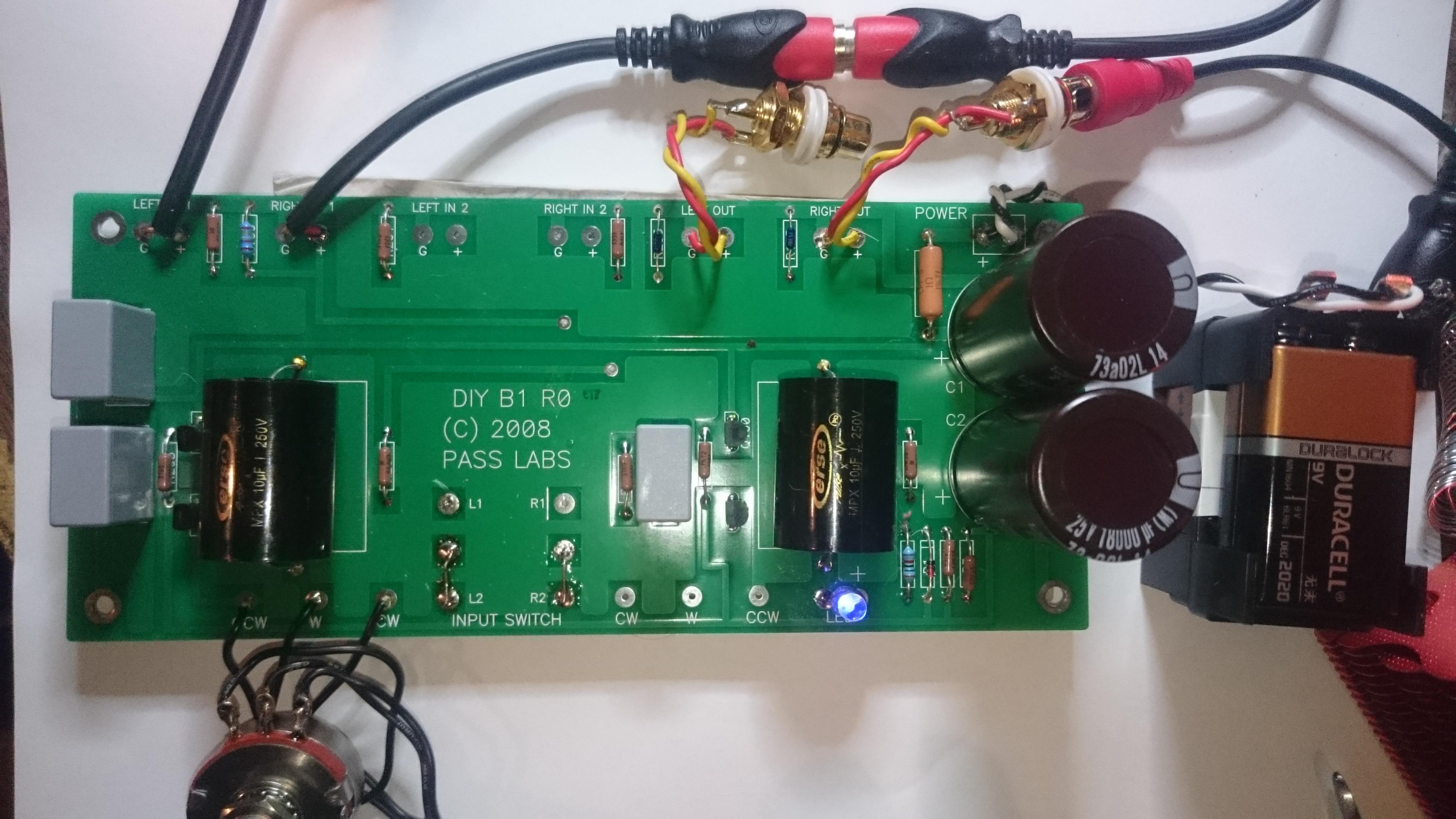

It looks as though you are using the first set of inputs, but the bypassing of the switch connections is for the second input. Also, from your leads it looks as though you are testing the right channel, but the input volume pot is connected to the left channel, and I can't see the right channel connected.
Hope this helps.
Hope this helps.
