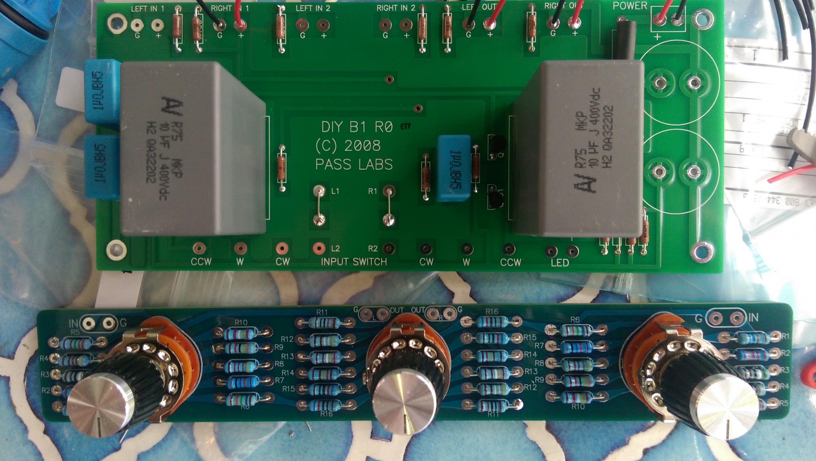

I just got my B1 Buffer board with matching JFETs.
Question: Can this be modified to eliminate the extra input (really only need one input) and avoid the selector switch and extra wiring? Is it a simple matter of a few jumper wires or something? Just wondered if someone has done this as a simplification.

I just soldered a permanent jumper wire to input 1 where the selector switch would go -- others have done the same.

Disabling the external switch actually requires adding 2 small jumpers. So nothing is being deleted... 😀
Sorry for the tiny photos, it's all I can find...
The jumpers are the bare wire bridges in the middle, from R2 and L2 to the unlabeled pads in the middle. Mostly obscured by blue wire... :/
And you can see where the inputs attach, above those pads coming from the rotary switch.
EDIT - here's a bigger photo -

1) Please look at the traces on the a3 and see if each channel's G are connected.
2) b1 W and a3 OUT are connections. That I'm sure of.
3) b1 CW is most likely a3 IN
4) b1 CCW is most likely a3 G
Do this on both channels.
the worst that will happen is the pot will act backwards, if so, swap CW with CCW

Thank you 6L6 I will try that. Looking at Ground it looks like each ground goes to a separate set of resistors and are not connected. I will try just hooking up one ground to see what happens.
The G are not connected? Strange.
Can you post the schematic? I'd like to see how it's made. I suspect it may not work properly with one set open...
In the time being, use the G near the output.

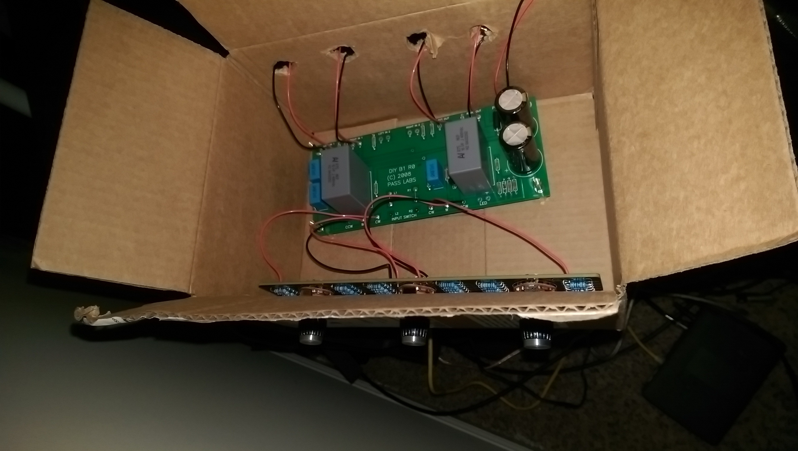

6L6's wiring directions were spot on for the A3 attenuator. I'm powering mine with two 9v batteries wired in series and it sounds phenomenal. I only have 9400uf and will have 30,000uf when my Digi-Key order gets here. Much better than my old Denon 2808CI running as a preamp which died.
So far what I noticed immediately:
- The B1 just gets out of the way
- Sounds more dynamic when the movies/music calls for it.
- Chimes, bells, buzzes, swooshing of a coat. They all sound more noticeable and distinct.
Using a Luxman M-02 as the amp and Pioneer BS22 speakers. Must say I am impressed as I know these are not the best speakers yet I was able to notice the difference quite easily. Curious just how great it would be if I finished my DIY speakers or still owned my Energy Reference RC70 speakers.
Must admit though I think I am the first to use a cardboard box...
Just thought I would add that I would not recommend 9v batteries wired in series. It sounds phenomenal but not for long. The batteries will only last 1-2 days if not disconnected at night. Also, common sense for most but turn off the amp first or experience a large pop...So easy to accidentally forget that lol
