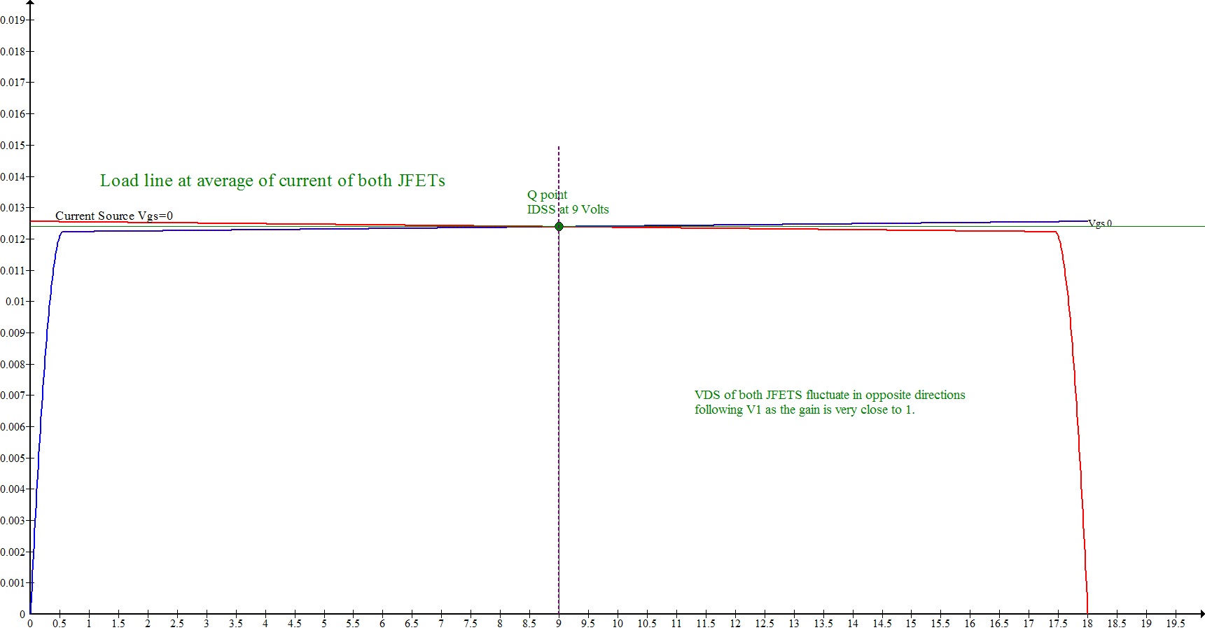

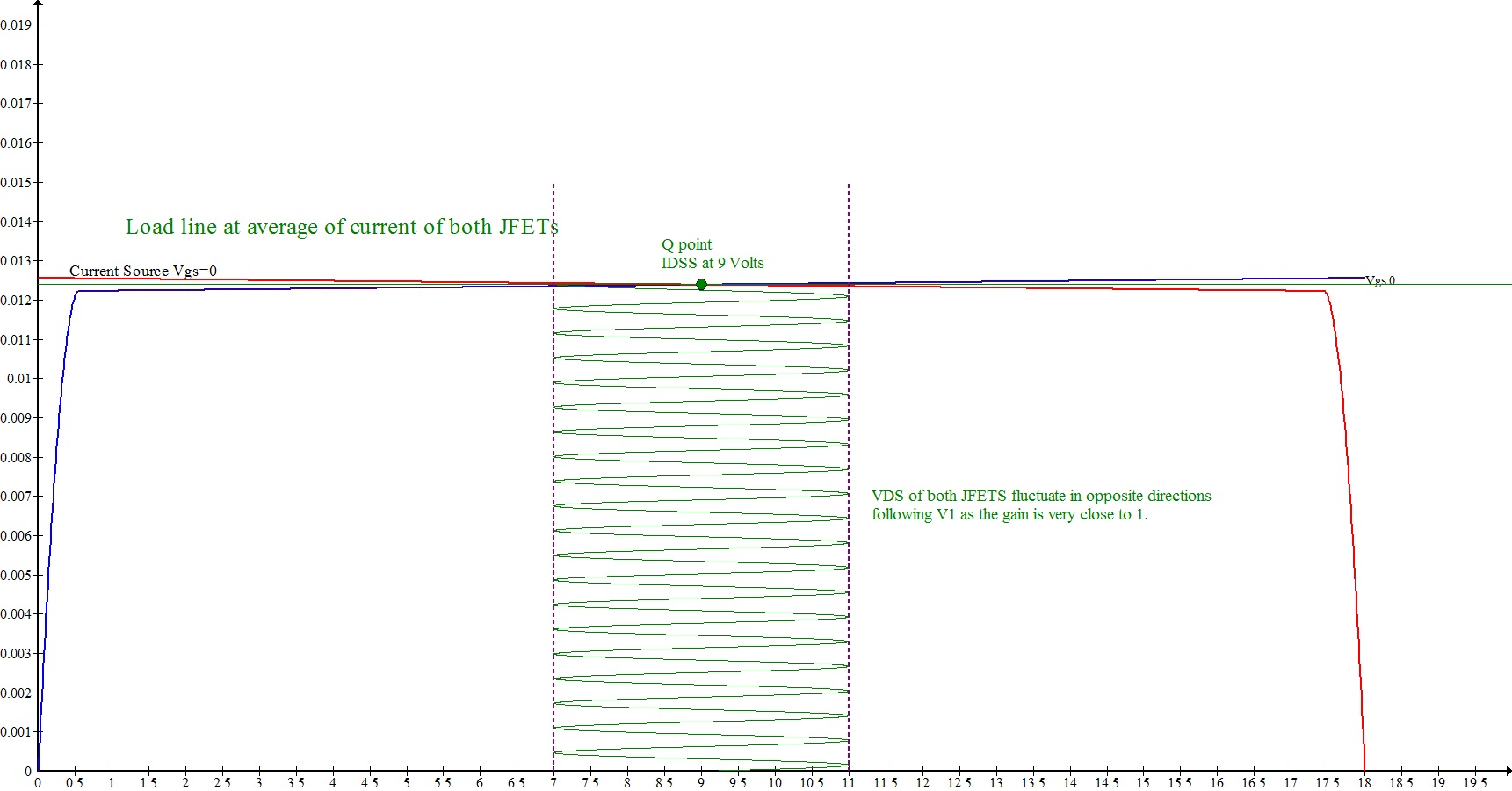

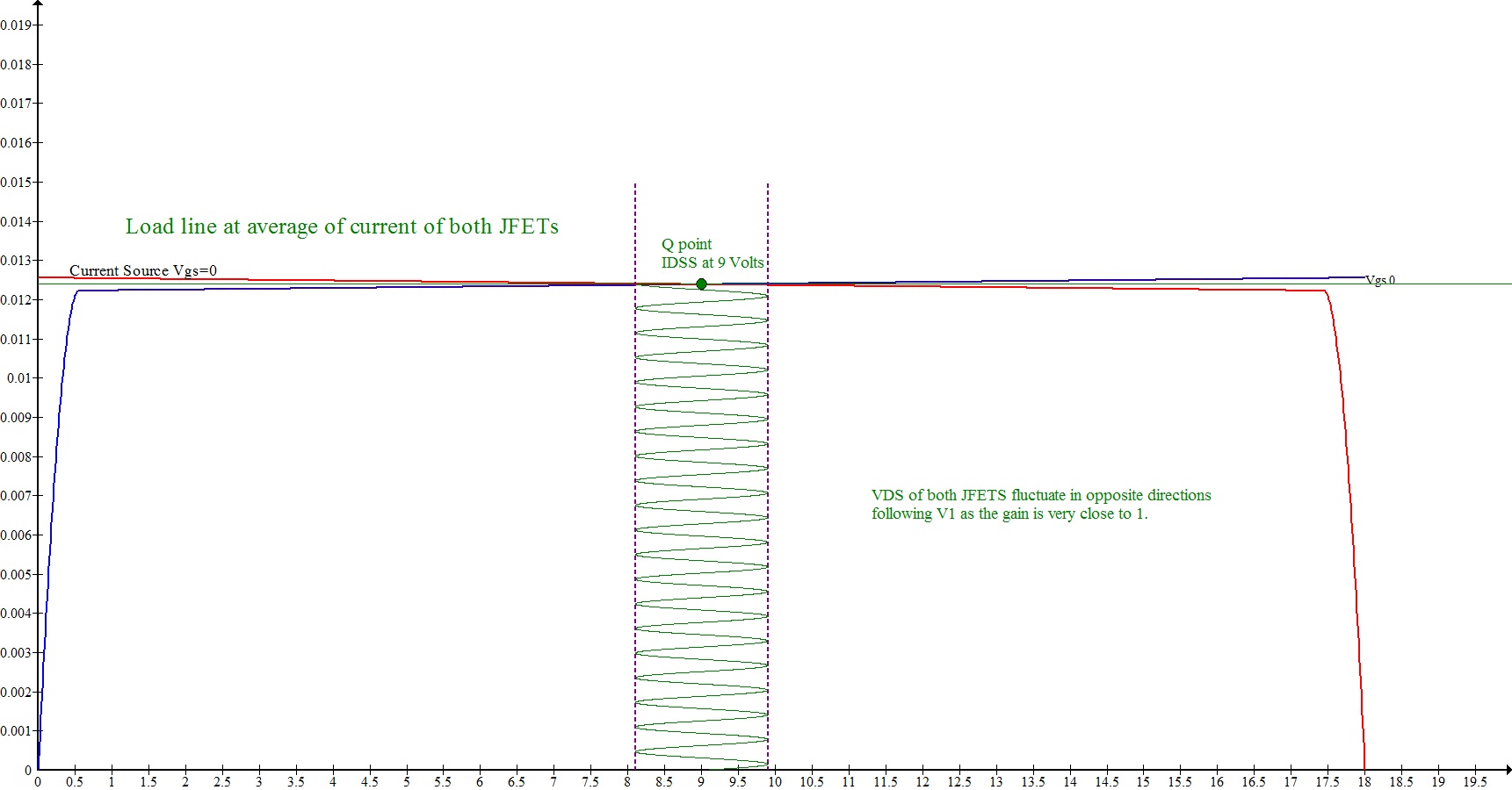

I am in the process of building a B1 Buffer and want to understand what is going on with the JFETs as the CCS is forcing the upper JFET to work at Vgs=0
I got some curves from the generic 2sk170 in LTSPICE and drew what I think is the load line.
Can someone confirm if indeed this is the case?
Link to short animation
Yes, the lower jFET (the CCS sink) has G connected to S and that sets it up to pass ~Idss when the voltage of Vds is ~10V
This current is pulled through the upper jFET (the amplifier).
When the upper device is selected to have the same Idss as the lower, then when Id is = Idss then Vgs must be zero. That is what you have measured.

So even though that the Vin swing for a single ended 2SK170 is approx .5Vpp, the nature of the operating line of the buffer will allow passing an input signal close to 18vpp (not that we are using sources that high). Is this correct?
The supply sets the limit for the maximum output swing.
If the supply is 18Vdc then expect output swing to be <16Vpp.
If you increase the supply to 24Vdc then expect output swing to be <22Vpp.
This is exactly the same as for power amplifiers and for opamps and everything in between.
If you have a buffer that has a gain of ~1, then the max input swing will be <Rail to Rail voltage less a bit.
BUT !
The second harmonic starts becoming enormous as the output approaches the rails.
That's where the voltage overhead gives a big benefit to music reproduction.
I try to get near 20dB of overhead from max signal to max not clipping voltage, in stages preceding the power amplifier. I would suggest a minimum of overhead of 10dB.
i.e. if you use Sources that can output a 0dBfs signal of 2.3Vac, then the Buffer should be able to handle ~7Vdc unclipped and that requires ~21Vdc for ~19Vpp. The DCB1 uses +-10Vdc allowing +9.2dB above 2.2Vac

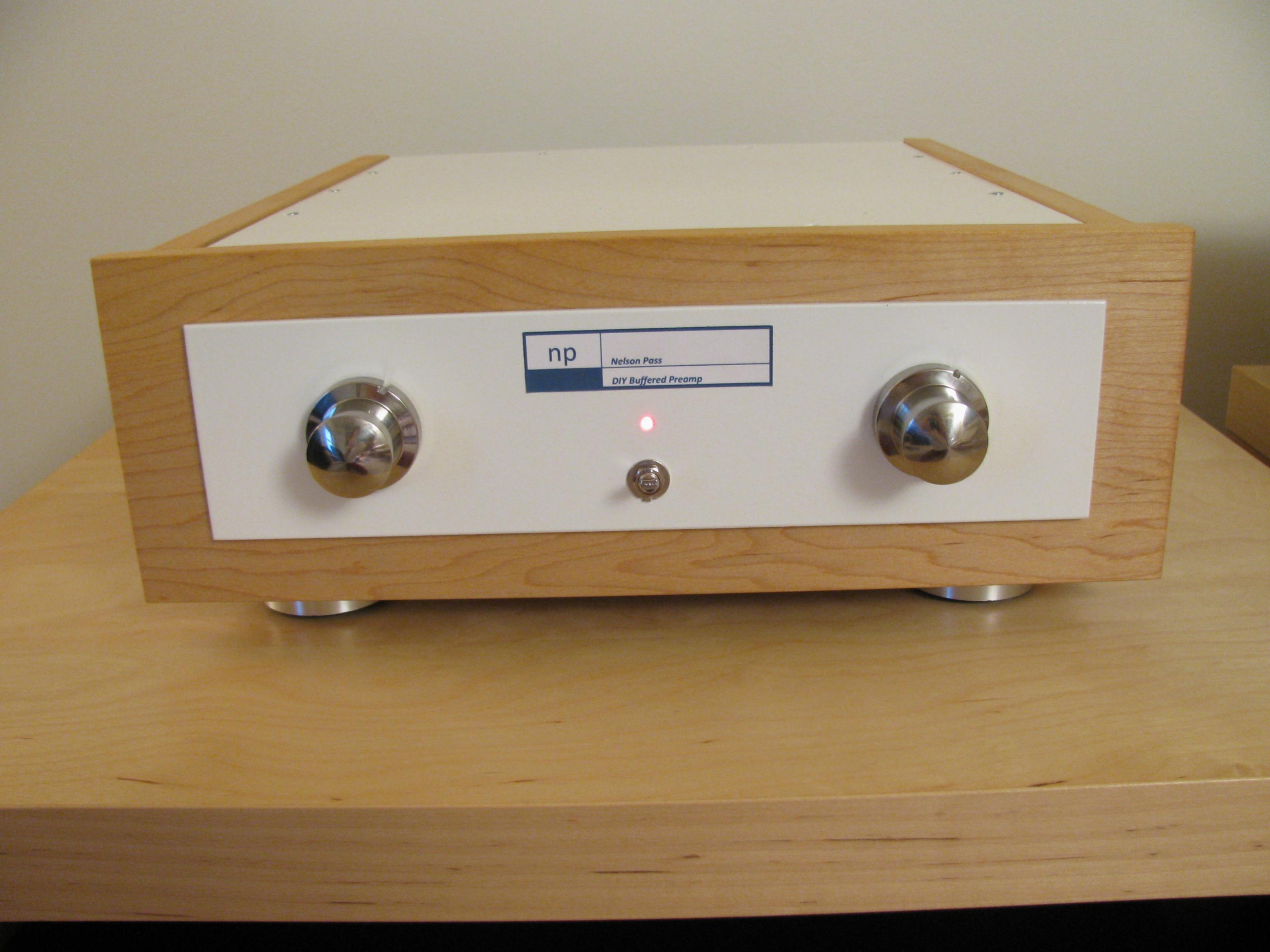

Nice looking B1 Mark.
I am guessing the audio store in Michigan is Audio Dimensions?
-Bill
Mr. Nelson Pass
Hi Bill,
No...it was a crazy name. A store in Kalamazoo called Mr. Toad's Sound Concepts. I swear to God!!!
I'm not making it up!
Nelson had DARK HAIR and was SKINNY! 😎
Mark
