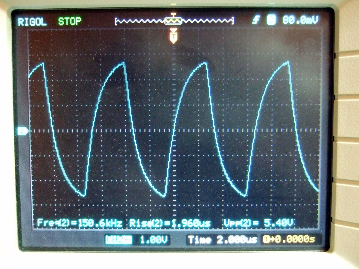

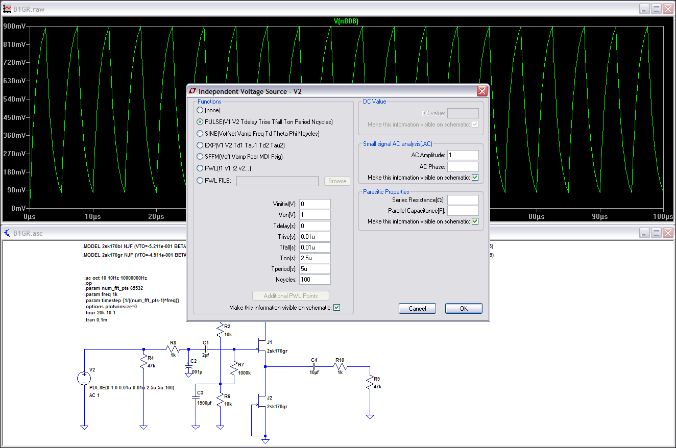

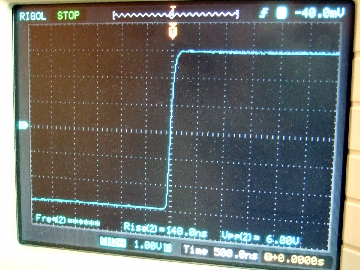

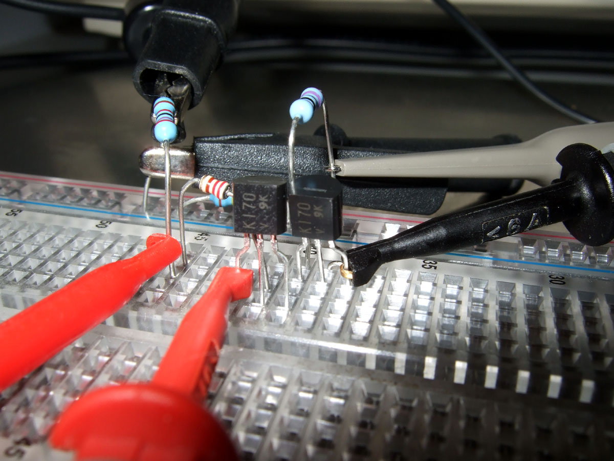

My function generator puts out its best SQW at 1/20 its nominal -3dB high band ability, rounds slightly at 1/10, and gradually loses performance to obviously rounded the higher I push it. It was the same for my older analog one not only the newer DDS which has to be filtered for ringing at a point, its the same ratio from its rougher but best rise time TTL output. Any 3MHz-5MHz decent generator will do fine for audio, will give 150-250 kHz most excellent SQW.
To put some hardware in this spice infested world, here is what a quick B1 symmetrically powered with 220R gate stopper can pass @150kHz with budget 3MHz gen to a budget hacked scope. Well, I aim for AIM TTI gear when better heeled after the next aeon, LOL.😀

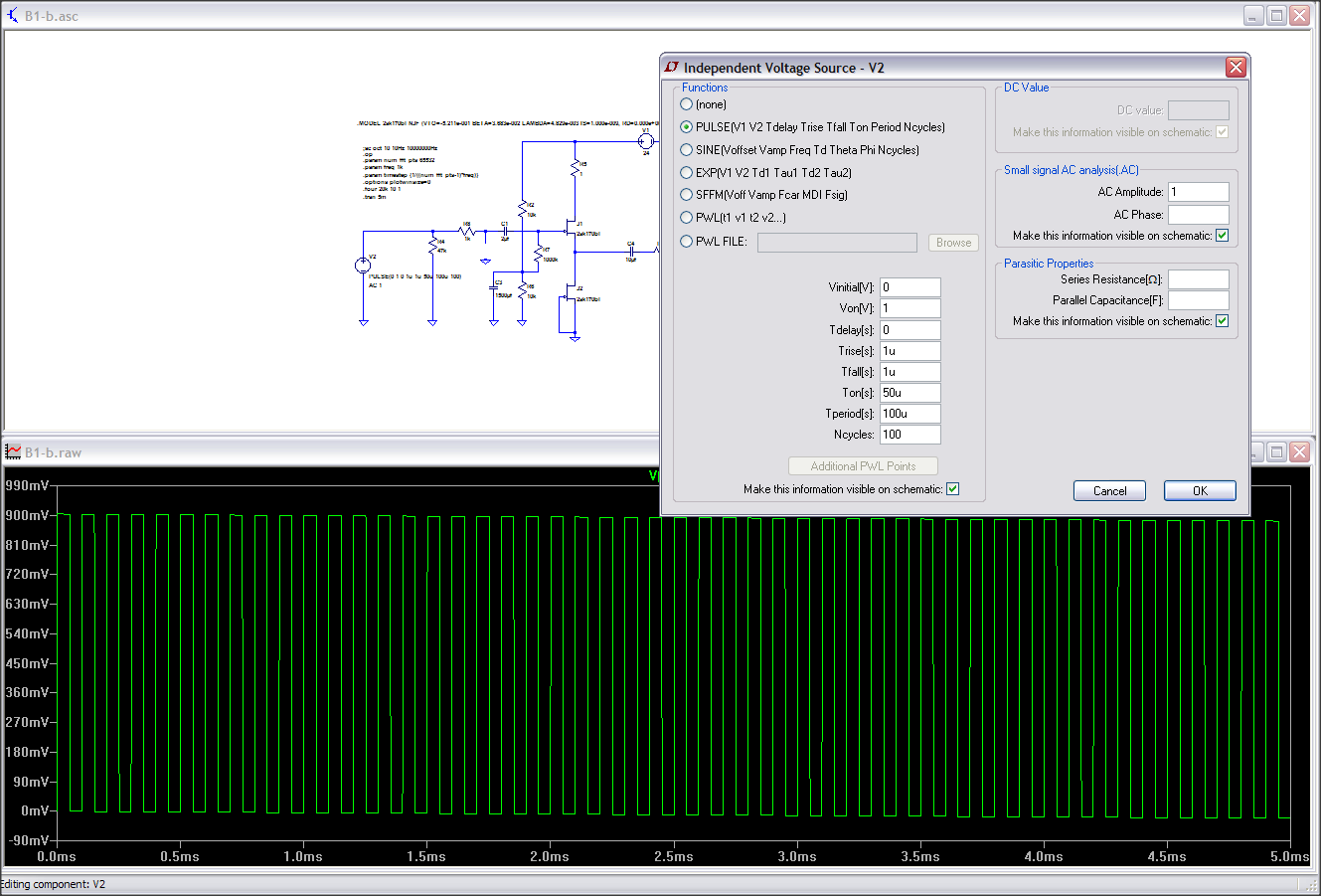

I note you have used 150kHz sq from a 3MHz gen, just as you described for your 20:1 ratio.
Could you add a 1us filter in between the gen and the B1 so that we can see the difference in the sq shape?
I just fully dismantled it to bits and back to parts bins, sorry. I used the higher Ciss 2SK170V to give it its worse spec possible for RC with gate stopper though. You may spot them in the first macro picture.

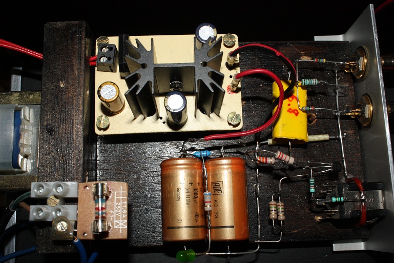

Hello Andrew and alls.
I´m thinking put this PSU for my B1 (I´m waitting for the parts at this moment).
Do you think I´ll have problem with the noise? Will the rippe enoght low?
Thank you very much
Jose
I used a similar regulator with a 30VA transformer and it was silent.
The B1 isn't super sensitive to PSU choice. I used 4700uF + 2R2 + 4700uF CRC into the LM317.

It will be in place of the 1000uF cap. For a demonstration of what this does see my blog post 🙂 http://www.diyaudio.com/forums/blogs/wintermute/574-yarps-finally-some-progress.html look at pics 1, 2 and 3 which show the ripple accross the first cap, 2nd cap and third cap. The caps in this test were overkill and I ended up going with 4700-3r3-4700-3r3-1000 (which is probably also overkill) but it substantially reduces the ripple before the regulator, and since the regulator only reduces the ripple (doesn't eliminate it) making it smaller before makes it smaller after 🙂
The other thing I found was that having 5V difference input to output voltage resulted in the lowest noise on the output. Increasing over 5V in - out differential didn't make any further improvement.
Note that using a resistor in between the caps does drop the voltage, and that drop is proportional to current draw, so the more current your circuit pulls the bigger the drop, a standard B1 won't draw much current though 🙂
