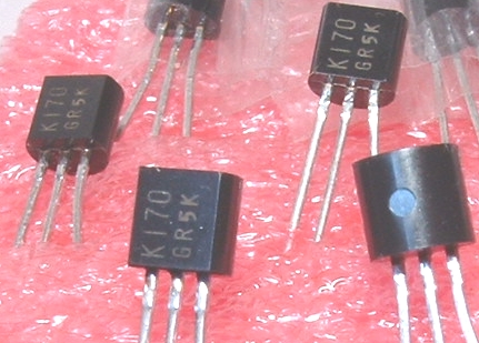

Here is the photo of my 2SK170.
If it's not toshiba, could it be genuine 2SK170 from another maker ?
Thanx
Paul

They look Toshiba.

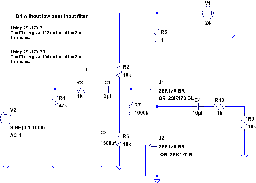

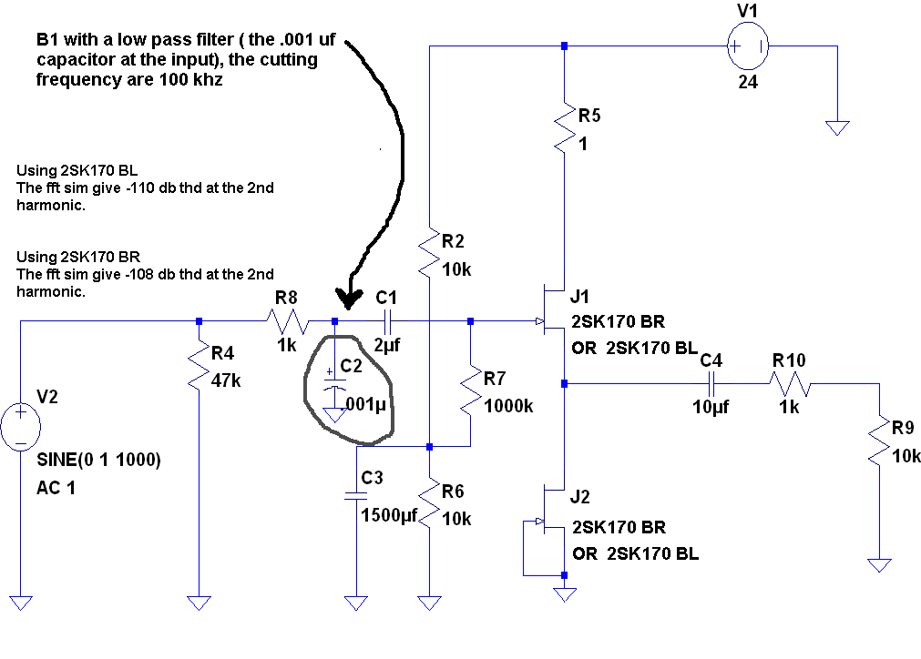

Hi
I've done Ltspice simulation of the B1 using those two model to compare.
The BL type of 2sk170:
.MODEL 2sk170 NJF (VTO=-5.211e-001 BETA=3.683e-002 LAMBDA=4.829e-003 IS=1.000e-009, RD=0.000e+000 RS=0.000e+000 CGS=5.647e-011 CGD=2.562e-011 PB=4.860e+000 FC=0.5)
The BR type of 2sk170:
.MODEL 2sk170b NJF (VTO=-4.911e-001 BETA=1.983e-002 LAMBDA=4.829e-003 IS=1.000e-009, RD=0.000e+000 RS=0.000e+000 CGS=5.647e-011 CGD=2.562e-011 PB=4.860e+000 FC=0.5)
I simulated with a 1 volt 1 khz signal at the B1 circuit input.
Adding a low pass filter capacitor at the input did cut a lot the thd of the BR type of 2sk170.
Thanx
Paul
Thanx
Paul
