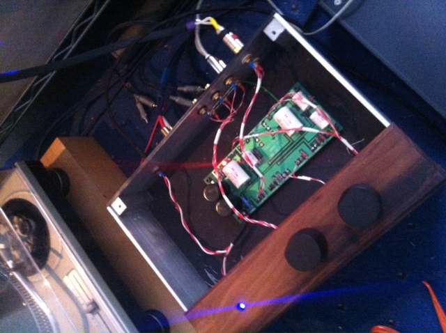

Rich, that looks fantastic!!!!!! Bravo!
Are those wooden knobs? Beautiful!
What are you powering it with currently?
Any issues with the Pearl through the B1?

Thank you .... the knobs are aluminium .
I'm using a regulated PSU from a door entry system that I had kicking around .
17.71 VDC .
The sound of the pearl is not great , I have my phone on the other input for comparison and it sounds much .much better .??????

Lol... I'm saying don't worry about it. Caps don't make anywhere near as much difference as people like to think they do. Use whatever nice film cap you can get of the proper rating and voltage. Get the circuit working. Listen to how good it is. (And it is quite fantastic 🙂 )
Then, if you want to mess with it, spend a ton of money on whatever audiophile approved caps you want and then see what kind of difference they make.
If you are talking about the 10uF caps I believe the original used axon's. Partsconnexion don't stock the 10uF size but do have 11uF which I think should work fine. cheap too. AXON True Cap Metallized Polypropylene Capacitors at only $2.88 each 🙂

Output caps does make a difference in B1.I have replaced AXON true caps with cheap Russion K73-16 caps 12x 10uF 63V PETP K73 16 Capacitors | eBay
Believe me there is a great improvement in SQ.

Yes I do favour 75 cents/per Polyester over some expensive PP caps.Try it to believe it.There are also few threads here suggesting the same http://www.diyaudio.com/forums/parts/143675-petp-capacitors-one-best.html

Papa Pass himself suggested in B1 artical that Polyester would be just fine.They sounded better than AXON PP caps in my B1.

Hi everyone, I was hoping someone here could clarify if I would be able to use 2 x 12v sla batteries in series as 24v to power the b1 buffer. In the description it says 18-24v but since the fully charged batteries output a bit more than that, will it still be fine?

Another question I ran into is regarding the 1uf and 10uf caps, how important is the voltage rating here, I see some use 1uf and 10uf 400vdc, but would it be fine to use 1uf and 10uf 200vcd?

If the worst case battery voltage is 13.8Vdc and you have two connected in series, then the capacitor voltage rating never needs to be above 35V. 25V rating might work in all locations but there may be a few location that could just exceed that lowish rating in exceptional operation.
