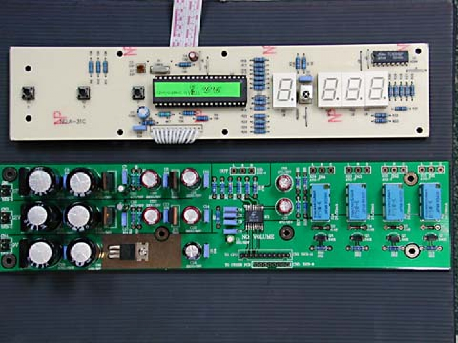

input selector and digital pot
Ive search this thread to find a clue to use the B1 together with a Input selector and Dig. pot. I'm in the process of building the F5 and wonder if I should use the B1 or can use the BZLS which now plays in combination with Aleph 30.
with the BZLS I use this input selector/dig pot. from Lite Audio. the Z-inp. is 47.5K.
My question is Can I use the Selector in front of the B1?
Hi Wijgers,
I own the same Dig pot, I used it with success for a past project and recently swapped for the R2R discrete one, same manufacturer, it uses same remote control and display unit but instead of the CS3310 chip it is made with a resistor ladder. I am running into some issues for the implementing, as the card of the R2R has two grounds, one for IN, one for OUT, I wonder which one to connect to CCW on the B1 board? or maybe rather connect both + the CCW to the star ground?
Another option is to put the Buffer after the Dig pot just using it as pure buffer, but then what about the impedance match? Maybe would it be preferable to solder a 100k resistor instead of 25k as a pot on the B1 board?
Many questions..
Many questions..
