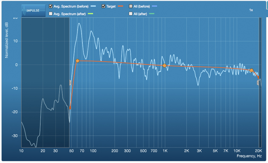

I attach what Dirac+UMIK measured far-field. Besides the room augmenting bass, there is a bulge from 700 - 1500 Hz followed by a dip at around 3kHz.

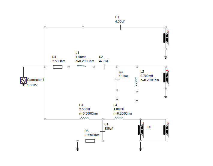

Congratulations! Great work on xover design.And fwiw, here's the crossover schematic before and after the changes:

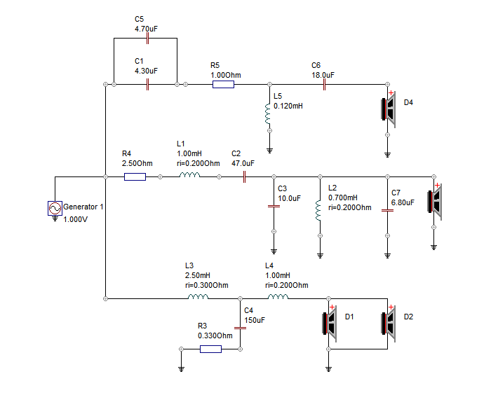

Here are the schematics for the original and modified CM9 crossovers. Tweeter at the top, woofers at the bottom.
The modifications are implemented in a way that permits easy removal. I was originally going to make one concession and solder-in the C5 caps but access to the crossover board is quite awkward when it is in the enclosure. I didn't want to remove the boards so I soldered a couple of big alligator clips to each C5 and clipped it across C1. 😱 Not quite mil standard construction, but they haven't fallen off yet.
The other four components (R5, L5, C6 and C7) are mounted on a small piece of 1/4" ply located inside the midrange chamber. Faston connector tabs are used for the board inputs and flying leads and Faston connectors for the outputs. The existing speaker leads connect to the board and the flying leads to the drivers.
Original:
Modified:

Thanks. First order networks are hard on tweeters because of the slow roll-off. The B&W tweeters seem to be designed accordingly. The CM9 tweeter has a compliant suspension and a resonance around 650 Hz; by conventional wisdom they should be OK above about 1.5 kHz. At 1.5 kHz the tweeter input level is 10 dB lower with the third order 3 kHz network than with the original first order ~5 kHz network.Bravo! I wish I had some of your skills to tame my B&W 685s. I think they have a very similar tweeter to CM9. I also want to lower the crossover frequency from 4kHz to somewhere between 2.5 and 3 kHz. Is it safe to run those tweeters that low with second or third order crossover?

The CM9 uses a third-order network for the woofers, a second-order bandpass for the mid and a first-order for the tweeter. The bandpass network has a phase response that approximately matches that of a third-order low-pass or high-pass, which is why the first-order tweeter network is not a good match.

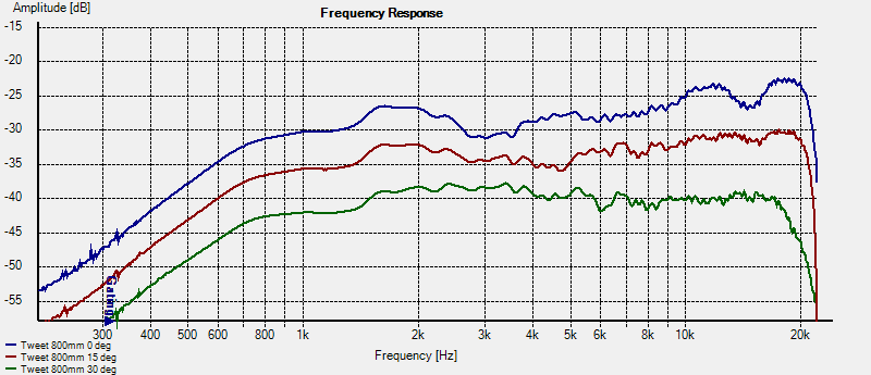

Would you share the tweeter measurements (FR, phase ...)
CM9 tweeter responses at 1m. Top to bottom: on axis, 15 degrees off horizontally, 30 degrees off. On axis, the bump centered on 1800 Hz and the dip centered on 3 kHz are due to baffle edge diffraction. So is the dip at 6 kHz in the 30-degree response. Sample rate was 44100, hence the 20 kHz limit.
ZMA and FRD files are here. Phase is measured with the peak of the impulse response centered on zero time. The average file is the average of the 0, 15 and 30 degree responses. Levels are arbitrary.
