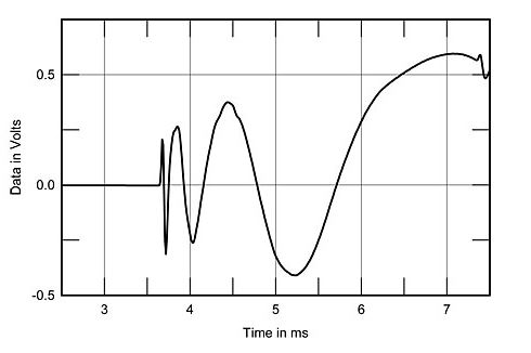

Here is Stereophile's measured Step Response for the 802D - a total mess as far as proper impulse time alignment:
Compared to a transient perfect speaker (link here) that has a step response like this, the percussion will just not sound right:

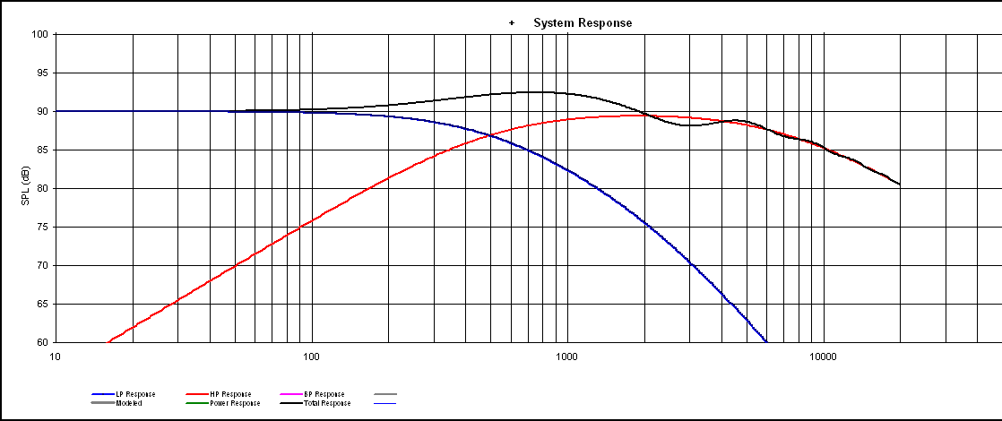

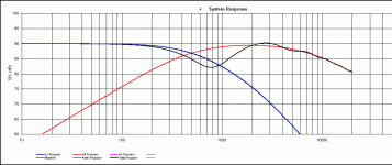

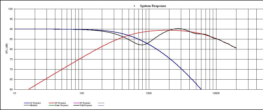

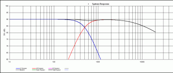

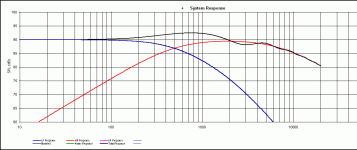

Sometimes DIYers are over enthusiastic about a certain
measurement aspect, in this case, the step response.
BW1 and LR4 are both flat on axis, not so off-axis.
For two drivers crossed over at 500 Hz, vertically
5" offset, +40 deg vertically from tweeter axis,
polarities in phase. The response with a hole is transient
"perfect". BW1 with polarities out of phase shows the last
graph. Is that the improved percussion?

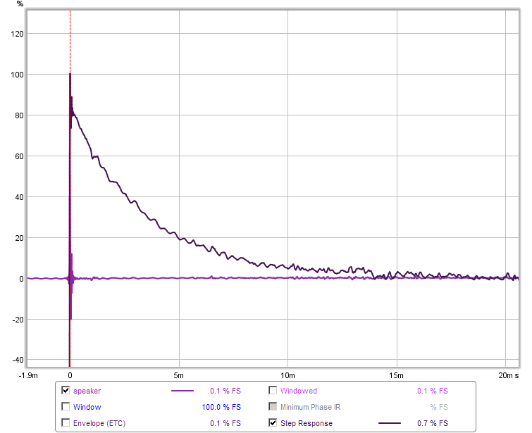

Why so hung up on that single point;
While I could post impulses from my line arrays which hold up of axis, up and down vertically I'll show an example from Mitch's 3 way instead:
(as posted here: http://www.diyaudio.com/forums/multi-way/100392-beyond-ariel-1157.html#post3939813)
Overlay of 6 IR's at the LP around a 6' x 2' grid with digital FIR correction:
Seems more valid in a multi way discussion to show a 3 way sample. The example isn't the best one I'm sure as in that thread we can see that the particular AD/DA is partly responsible for some ringing after the impulse. See the digital loopback:
But the STEP still is pretty much the same in those 6 spots:
So please tell me where that rumour came from that such an impulse or time coherence behaviour can only be valid or happening at one point. You would be right if you do the processing the wrong way though . Is it because of the single point measurements in the process that you guys assume it will only be valid at that one point? The example from Mitch is a good example to debunk that story. Invest some time yourself and you'll see and learn more than simply arguing with unfounded opinions.
Will a 3 way hold up that impulse in vertical measurements? Neh... but will the passive crossover have the same results in vertical measurements? Neh...
Now a floor to ceiling array, that's a little different. But I won't go there
So it works in more than one spot? Who would have thought that!
