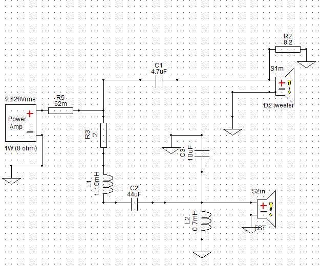

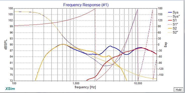

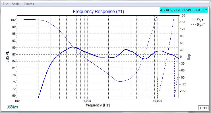

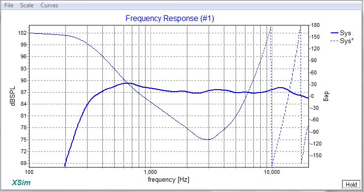

I did eventually get around to creating FRD files for the FST and the diamond tweeter and also finalised the crossover revisions.
Here's the xsim response - on tweeter axis, before and after the crossover revisions. (FST+tweeter)
When I've implemented them I'll repost the measured responses - before and after with the microphone in a fixed on-axis position.
Art Vandelay,
Looks good and worth it calibrate electric network to improve acoustic precision, thanks sharing plots and schematics.

Thanks, and only too happy.
The improvement is mostly due to improved phase alignment above and below the crossover frequency, so the off axis response is also smoother and the primary lobe is slightly wider in the crossover region too - in the vertical plane.
B&W's decision to align the phase at crossover by moving the tweeter forward by a half wavelength creates problems above and below the crossover frequency which are not really trivial IMHO. There's no 100% cure but it's possible to make significant improvements by adding a few simple networks, which makes the speaker more engaging and enjoyable to listen to.

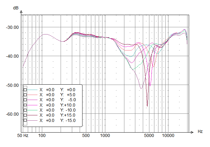

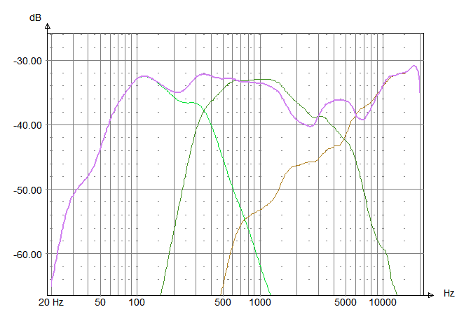

I just stumbled across this thread and am having a serious attack of deja-vu.
I recently came into possession of a pair of CM9s, played some familiar tracks through them and my immediate reaction was "you must be joking". I did not expect to hear such obvious faults from a $3k pair of speakers. Investigation revealed two main problems.
1. Insufficient damping in the midrange/tweeter chamber. Reflections from the back of the chamber resulted in obvious wrinkles in the measured response and an unpleasant boxy quality to the sound.
2. As others have observed, the crossover design is rubbish. There are all kinds of phasing and summation problems between the midrange driver and tweeter.
So, I relined the midrange chamber to eliminate the reflections and made some crossover additions that changed the tweeter network to 3rd order and lowered the crossover frequency to 3 kHz from roughly 5 kHz. I'll post details if anyone is interested. The before and after simulations (and measurements) are pretty much the same as those shown in post 332. Sound is remarkably improved - they are actually a pleasure to listen to now.
What is it with B&W? The drivers are very good, construction and attention to detal is excellent, crossover components are very high quality. Why compromise all that with poor crossover design?

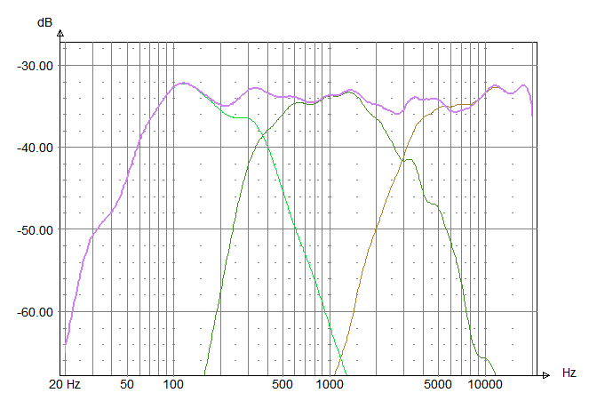

Definitely interested, yes.

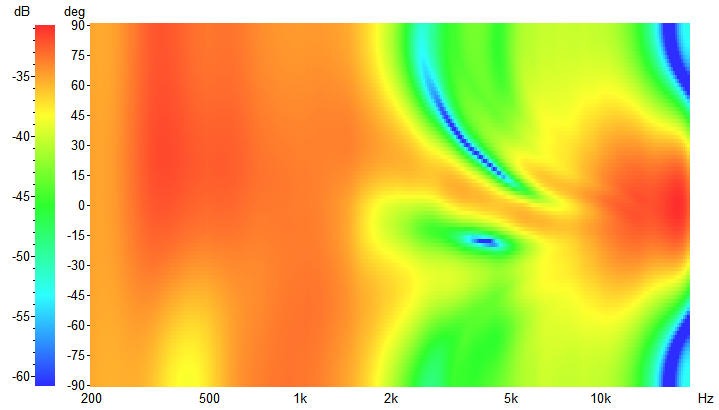

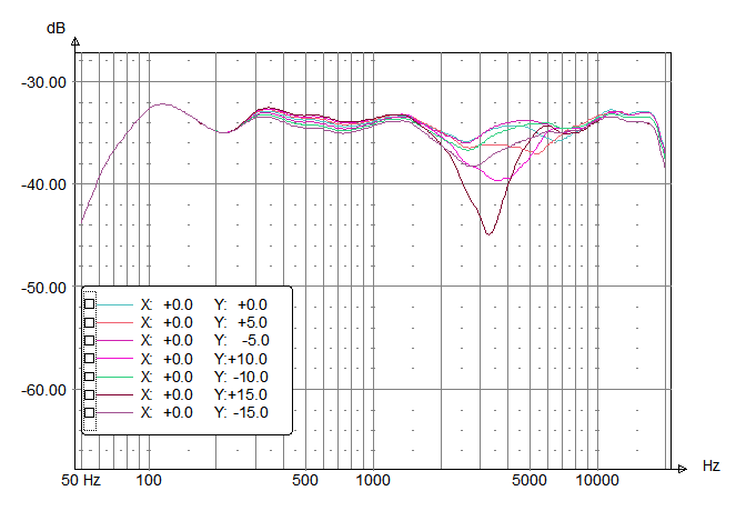

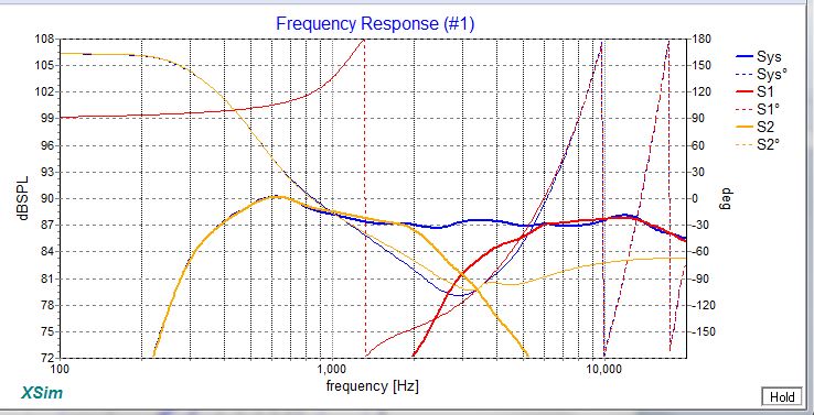

Likewise, my crossover is now slightly lower than before and the (destructive) interaction between the drivers at <=0.5xf and >=1.5xf (above and below) the phase crossover point has been reduced significantly.
See here the summed vs individual driver amplitudes. Not only is the response flatter but the drivers are no longer adding destructively.
Hopefully the before/after plots are self-explanatory. Pay no attention to the low-end (below, say, 500 Hz). The similarity to your plots is what first caught my eye.
I traded off some response flatness for an improved radiation pattern. The main lobe tilts down a couple of degrees. That's OK if you are seated because the CM9s are quite tall. I would prefer the lobe to tilt up a bit so there is less sitting/standing variation, but it is hard to accomplish that when the tweeter acoustic center is forward of the mid center.
Re-lining the midrange chamber reduced the mid level by about 1 dB, which shows how much rear wave was being reflected back through the cone. I wanted to pull the mid back a little anyway to reduce the mid-forwardness. It sounds about right now.

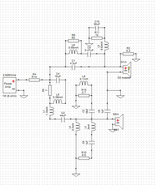

I'll draw up the crossover modifications tomorrow.
Thanks for that. That is an excellent result and the phase coherence in the 1-3 kHz region has obviously improved markedly. No wonder it sounds better.
I considered a 3rd order filter too but in the end I opted to create a 2nd order response below 2kHz and fix up the coil resonance with a conjugate network, because the resulting tilt in the polar response didn't match my listening height.
Although undesirable from an integration perspective, the forward alignment of the tweeter does at least have the effect of completely removing baffle edge diffraction effects, which are more difficult to predict and control when the tweeter is mounted atop a box enclosure.
