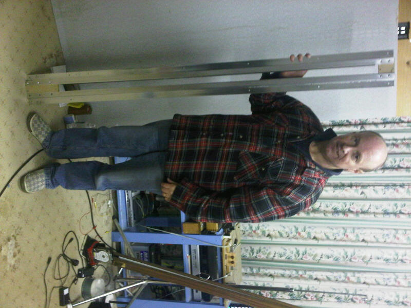

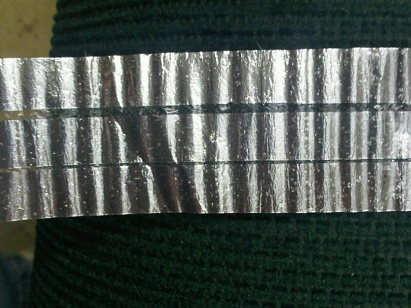

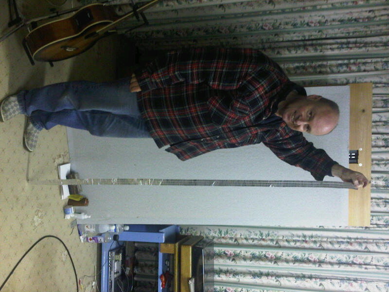

StigErik - this is a story of my two audio friends Steve and Chris. They both had magneplanar tympanies, like me, albeit they had original maggie tweeters and knew that my RD75 was superior to the original tweeter. Steve also had a pair of Trevor Lees ribbons (trevor is a local Melbourne audio manufacturer) which were made especially for Tympanies. Only problem with them is a low 2 ohm impedance which didn't go too well with Steve's AR valve amp.Yeah, please post pics and some info about the ribbon tweeter. I'm very interested, since to be honest, RD-75 is the best tweeter I've heard.... and if anything potentially better is out there ...? 🙂
So they decided 2 build their own 65 inch ribbons to match the height of the Maggie bass panels. They managed to do this, the clever boys and the resulting ribbons sound absolutely brilliant - they kill my RD75. So I need to build a pair as well. But I have gone a low cost route - Steve has sold me his old Trevor Lees ribbons and I am now pulling them apart and re-building with a new improved 4 om ribbon.
So my ribbons are not yet complete but I can say that the ones made by Steve and Chris sound brilliant. Chris uses the same 50 watt class A mosfet amps that I do, in bi-amp mode, so I am able to make very good comparison. While the RD75 is very good (excellent) in all regards, these ribbons are better in every way and I have not found a weakness. They have incredible speed and air, and while I have not measured the response I am sure that it does have a more extended HF than the RD75. A great project for anyone. I can get details magnets etc if anyone wants.

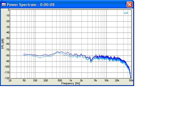

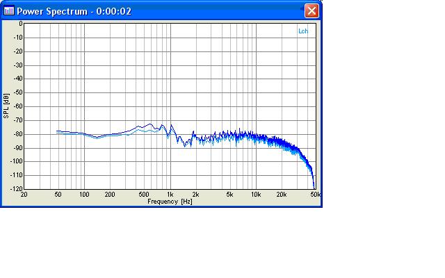

Yes, please share.
Measurements would be very nice to see. Is it possible for you to provide any?
The reason I ask, is that I've seen a few DIY ribbons, and they all measured badly. One pair was -15 dB at 20 kHz...

Try this - Chris not sure but thinks he used software called WinMLS, and a panasonic microphone. Very flat up to 20kHz then a roll-off after that. Not sure if the roll-off is a function of the software, or a function of my power amp design (output stage is a mosfet in common source configuration, it will suffer higher input capacitance than a source follower which is more common, but I've never actually measured the response of the amp).
