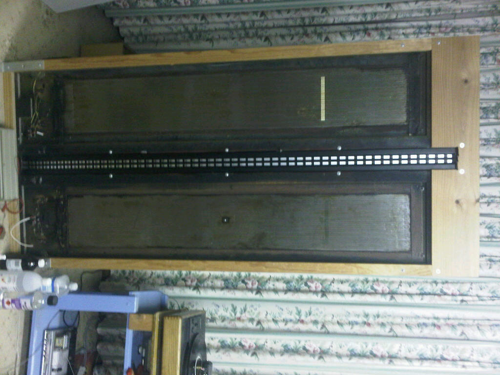

Hi folks...
The BG's run free from ~600 hz up....with Peerless HDS
mid-woofers for 600 Hz to 50 Hz range, Peerless silk tweeters (one firing forward, one backwards) from 3500Hz up, EAS-400 leaf-tweeter as super tweeter from 7000Hz up. The bottom end is augmented by a Titanic 12" sub in a 5 ft^3 sonotube, pretty much from 100 Hz to < 20 Hz. all @ 2nd order
RD 75 has the notch filter... dipole baffle roll off compensated and levels matched for all drivers...
I'm still tweaking 😉 (does it ever end?) The baffles are 1" cherry and the mid woofers are housed in mdf enclosures tuned to ~48 hz.
another pic earlier while building...

not so complicated... and got results
Actually, it started out as a 2 way at most (BG-75 plus 2x6.5 peerless woofers)... baffle width 21"... if I recall, the BSC starts around 270 hz or so
I added the additional speakers to improve the sound and power handling, but the original RD75 + 2 woofers sounded pretty good on its own. The high end super-tweeter addresses the beaming and dropoff of the BG's > 12 Khz quite nicely, uses a simple 1st order xover.... no high end xover for the RD75's... the bass bin is xover 2nd order LR.... and the baffle step helps the transition zone at the low end

I've seen your design before over in my own dipole thread. Nice build, but quite different from my own.
I have lifted the top end 12 dB at 20 kHz with EQ. Without EQ a super-tweeter would probably be needed.
Here is my solution to a baffle for a RD-75 - magneplanar bass panels either side. They fill in the bottom end nicely, same fast speed as the RD-75 (I could never put a panel with a cone) and make a handy baffle. Crossover is first order at 660Hz, achieved by a passive filter in the input of each amp - speakers are bi-amped so I have a dedicated amp for each driver - so each driver is direct coupled to the amplifier. I have a notch filter according to the BG recommendation. I an very happy but to tell the truth I have heard a better tweeter than the RD75. SOme crazy friends of mine have designed and built 65 inch ribbon tweeter to match their maggie panels. Sounds simply magnificent. That is next on the DIY list.

Back on topic - yes I know that the RD-75 needs a bit of top-end lift. As much as I love what it can do matched to the Maggie panels, I have heard a true ribbon and it is a big improvement on the RD-75. Rather than build a super tweeter I have decided to build a ribbon tweeter. Pic.s to follow tomorrow night. Oh and I know that I can't even hear 15kHz, so maybe no point to a super tweeter!
Your question about LF extension - never measured the maggie panels. They are reputed to go down to 40Hz, not super low but it is the quality of the bass that counts. I can't stand listening to box speakers after using the planar bass panels. There is absolutely no boom or overhang with maggies, so I have become hyper sensitive to those when I listen to boxes. I have 3 other friends who have replaced the Tympani tweeter with ribbons in a layout the same as mine, we have a small cult on our hands. Amaing how good 40 year old bass panels sound (though one of the boys has replaced the wire on our bass panels - a very clever boy).
Yeah, please post pics and some info about the ribbon tweeter. I'm very interested, since to be honest, RD-75 is the best tweeter I've heard.... and if anything potentially better is out there ...? 🙂
