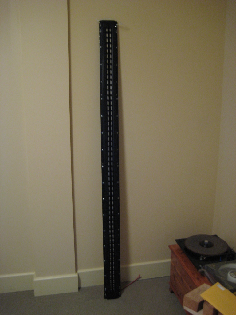

Hi Guys,
I just received my pair of RD75 planars from PE over the weekend, and I'm excited to start measuring, testing and building!
I have access to a large anechoic chamber and some very good measurement gear, so I plan to run a full gamut of tests on these to see how they measure up. I'm particularly interested in THD performance and characterizing the 5kHz resonance.
Although I'm very intrigued by the idea of a dipole implementation, my listening space really isn't going to work very well for that as I don't have any space between the loudspeakers and rear wall. As a result, I'll be building an enclosure that follows the suggestions in the white paper as closely as possible (10" deep, 6" wide, very well braced and damped).
Has anyone here tried a sealed enclosure? Any success or suggestion?

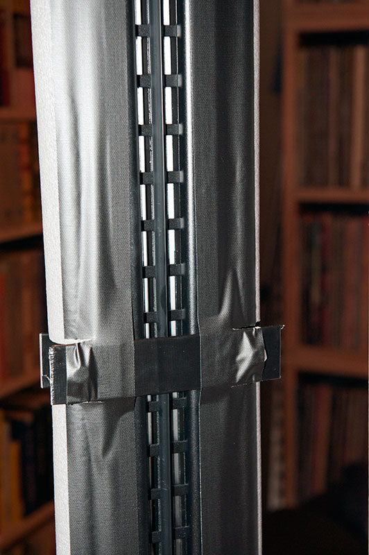

StigErik:
A while back in this thread or your other one, you mentioned that one of your two ribbons was buzzing, and that you were looking at returning it. After that, you never really mentioned it again.
Can I ask how you resolved the issue? One of my two ribbons is buzzing about 1/3 of the way down form the top at frequencies between 1 and 3 kHz. I was running 1kHz tones to see if I could get a rough frequency response in-room and noticed it right away. It's less noticeable with music, but it's still there.
Did your buzz go away with time, or did you exchange your driver? I checked the driver closely and don't see any signs of damage, but I did notice the foam in the rear outlets was a bit uneven. I carefully straightened it with some plastic tweezers, thinking maybe it was contacting the diaphragm, but it didn't help.
I did not return the drivers - too costly to ship them back and forth across the Atlantic.
I never really found the real source of the buzzing, but I discovered that applying pressure to the front waveguide stopped it. It seems that the buzzing has little to do with the ribbon itself, but rather a mechanical problem with the waveguide. Anyway - installing a clamp solved the problem....

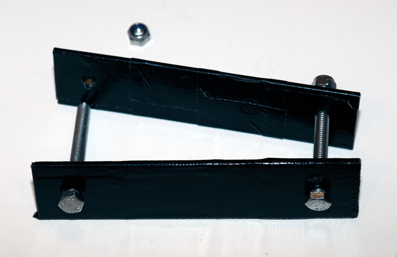

I friend of mine who also has RD-75's solved it this way:

thought I read that the foam baffle StigErik added to his RD-75's cut out the buzzing? Can't remember, will let him chime in on that one.
I added the foam baffle to round off the edges and reduce diffraction. It did not affect the buzzing.
I did add a clamp between the front and rear side of the driver at the point where the buzzing came from. This solved it, and over time the buzzing got away, and I removed the clamp. I have no answer to what was the the exact source of the buzz and why it want away.
