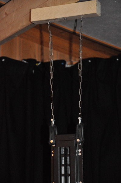

StigErik, do I understand your physical implementation of the RD-75 right: in the pictures where you show the curved edges it looks like you attached some chain on top of the unit. Did you just attach the other end of the chain to the ceiling or some frame?
Yes I did. Its simply hung from a beam going across the room. The beam can be moved back and forth to make it easier to change the placement of the speaker. The chains are attached to a smaller piece of wood, that is easy to move across the beam, and it can be rotated for easy adjustments of toe-in angle. This is really very simple, I guess it took me less than half an hour to build it. 😛
I have some more detailed pics below, taken before I put on the curved foam edges.

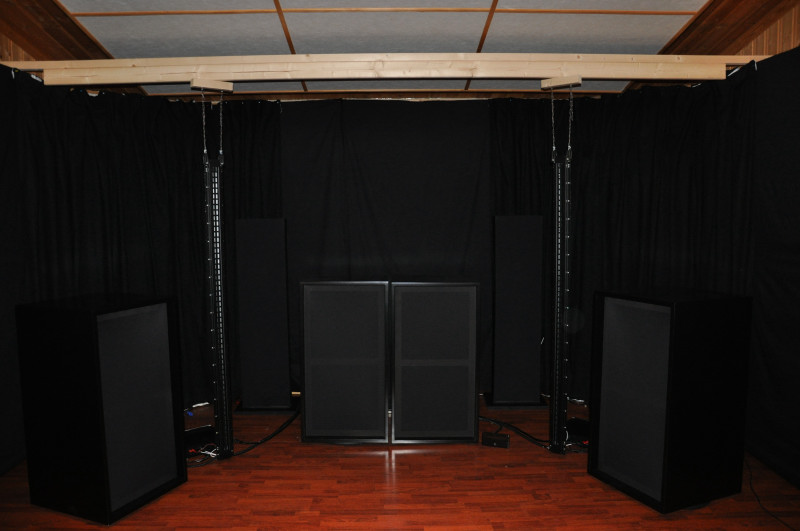

I believe the RD75 has a fantastic impulse response, do you manage to keep that quality in the bass with the 4 subs? How did you place them, same distance and/or delayed? I can't make up the angle for the subs in front, do you seat right between them??
See the pic below.
The woofer towers are delayed to get the same arrival time as the ribbon. Impulse response of this system is pretty clean if you ask me. Will try to find a measurement ... if I bothered to save any measurements....
This is NOT how the room looks now, but the speaker arrangement is the same.
