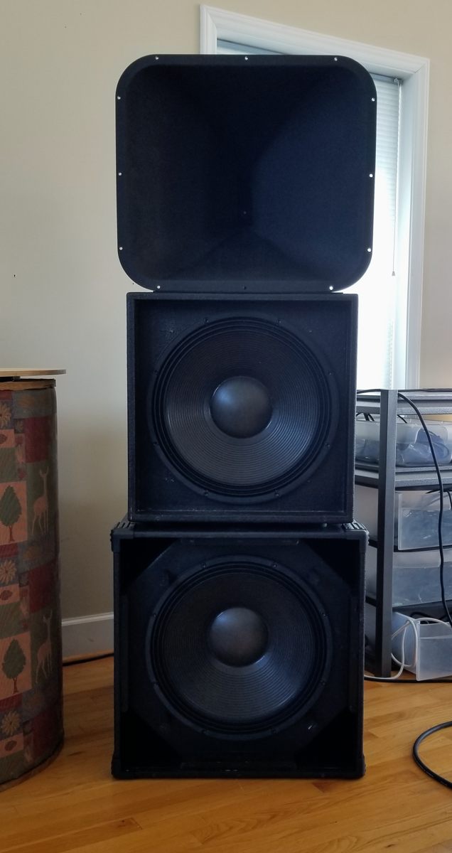

The 464 horn going down to 300Hz does pose a dilemna how to use it.
I want to go straight to an 18" too, but a single 18 isn't high enough (i'm not a seated-type listener)
So right now it's stacked like this, on two 18s with the bottom being vented.
Still totally in the tuning/experimentation stage. I have no idea what I'll end up doing...maybe put the horn on a pair of 12"s...plain dunno.
It doesn't look like it in the pict, but the bottom sub is about 3/4" wider than the 464 horn.
I think you could make a nice size matchup with a vented 18..
(i really like 4 corner ports for vented. Ports double as bracing, and have a balanced loading around the driver.....they work imo/ime !!!)
I wish i could just put the 464 horn on top of my 4ft tall PPSL sub, but the sub isn't built for even close to 300Hz (due to the slot effects).

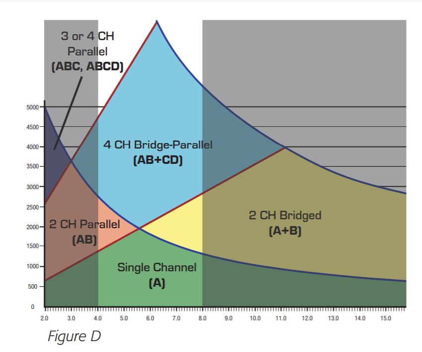

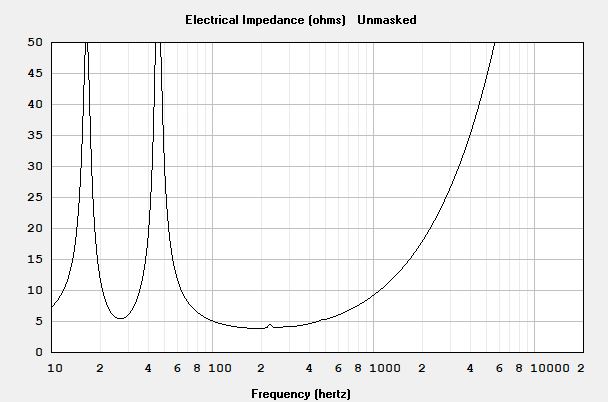

I figure you're familiar with all the below, but curiosity has me researching with you ..
Hornresp with 7.5 cu ft volume and two 6" pipes 20" L.
Those 2 ports are for single driver with it's own sectioned off box, right?
Looks more like an 8 ohm nominal to me; so it makes sense AB+CD made it come alive, especially with the tall peak spanning 35-75Hz.
But I can definitely see the PLD4.5 being too small for 4 of those monster 21" drivers.
It's been too small for four of the bms 18n862 @1500W AES each, under every configuration I've tried.
(The four 8 ohm drivers come alive with two in parallel, on each channel of a PL380.)
Amp might even be too small for just two of the 21"s, given the need for both massive current and high voltage.
Power chart comes from https://www.qsc.com/resource-files/whitepapers/q_wp_sys_amp_flexibleamplifiersummingtech.pdf
Plain dunno if the PLD's were really made for heavy sub duty...
