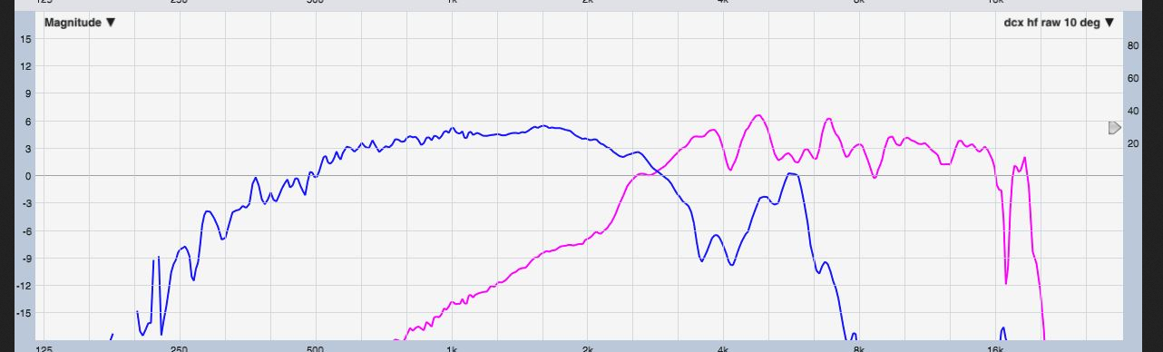

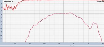

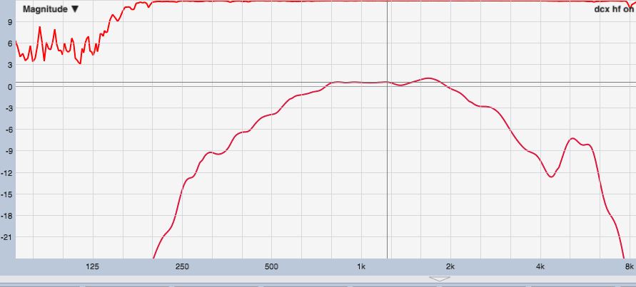

Mark,Here's the lower CD section raw, to help you judge whether you think it might work....
I think the previous raw response of the DCX464 on the ME464 with less smoothing is more telling. The response is within +/- 1.5 dB down to 315Hz, then degrades rapidly below.
Excursion should roughly double per halving of frequency down to the horn cutoff around 300Hz, but since the ME464 is (more than) -6dB at 250Hz compared to 500Hz, equalized flat, the excursion would be at least four times at 250Hz than 500 Hz. Considering Xlim is probably under 1mm for the DCX464, I'd expect it to sound "distressed" at relatively low levels below 300Hz.
I'm curious as to what the distortion looks like down low at various levels, and whether the DCX464 annular diaphragm suspension self-limits excursion down low, or the diaphragm hammers the phase plug as is typical of most dome shaped diaphragms.
I recall the upper section of the DCX464 was running into what looks like displacement distortion when crossed low, but don't recall seeing distortion measurements for the low end on the ME464, have you done them?
Art
I agree Art, the raw unsmoothed doesn't look at all usable to me below 300Hz....not really sure why i posted 1/6th smoothed.

Mark,I agree Art, the raw unsmoothed doesn't look at all usable to me below 300Hz....not really sure why i posted 1/6th smoothed.

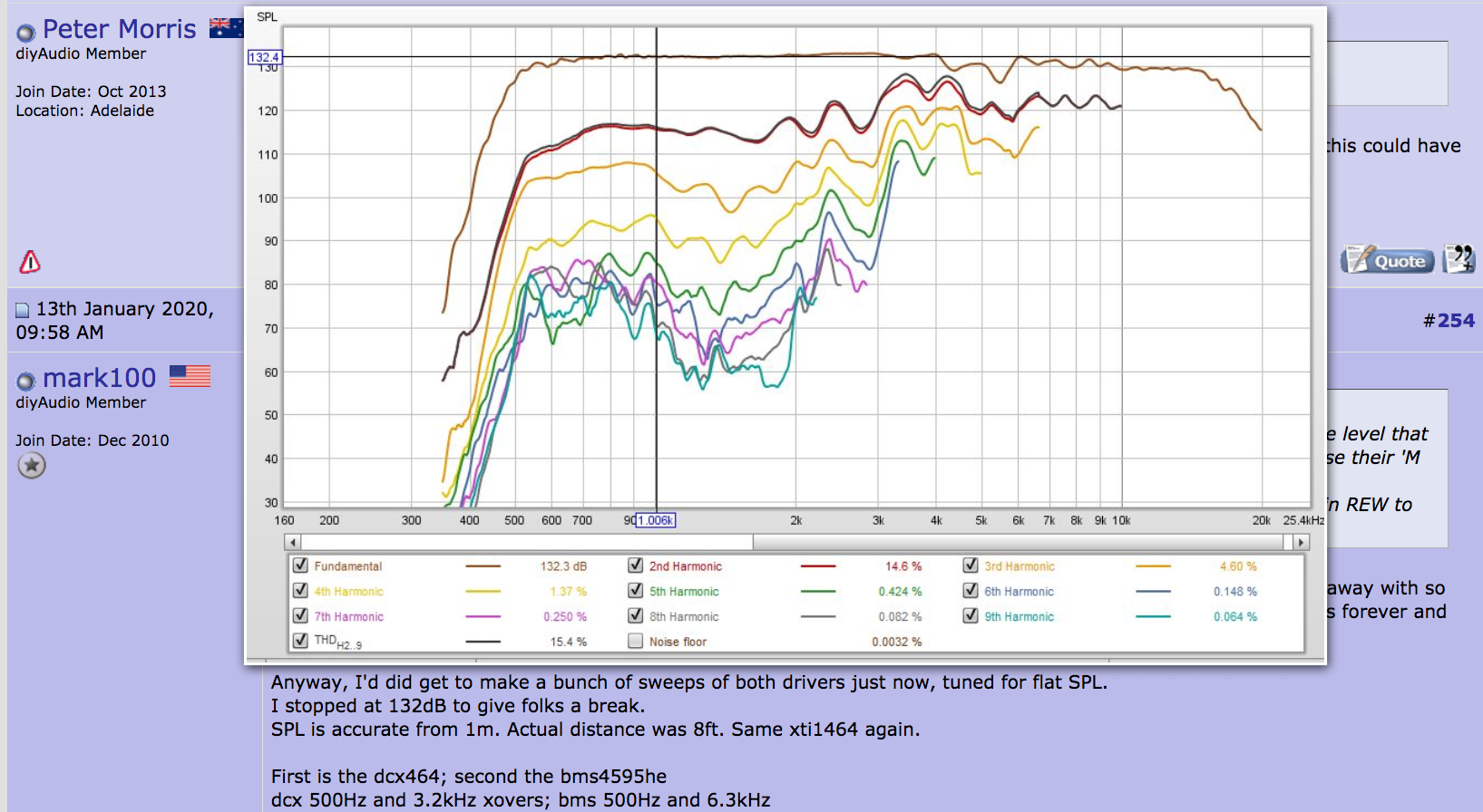

You did post distortion results for the DCX464 on a different horn on 1/13/20, it showed it's low frequency portion to be capable of more SPL with less THD than the upper section. Below 300Hz the DCX464/ME464 distortion would look quite different than above.
That said, THD alone is not really a great indicator of determining "bad sound". As you wrote in post #83 "I changed the top one for use as a low-mid only, 120Hz to 300Hz... it was simply cleaner sounding..no sub should be asked to pull duty above low-to-mid 100Hz"
Your listening tests with a single or dual 18" below the DCX464/ME464 crossed at 300Hz point to intermodulation distortion, (the addition of two fundamental frequencies, 30Hz+250Hz creating a third frequency at 280Hz, etc.) being the sound quality issue. The IMD issue is worse in HF compression drivers, possibly from air non-linearity at high SPL in the inherently limited excursion imposed by the diaphragm proximity to the phasing plug.
With your indoor listening evaluations you probably were not pushing the DCX464/ME464 near the level required for it to sound "bad", the IMD in the 18" sounded "worse".
In my HF compression driver evaluation, I mistook IMD for ordinary HD when reporting %, though the sound of it is quite different than HD, fairly easy to hear in the high power low frequency dual tone tests of the smaller drivers.
Years later, using a 3.5" Tymphony TC9FD-18-08 "full range" driver on the test horn, found that it had far less IMD than the best of the compression drivers tested.
A little IM goes a long way as far as sounding bad. I'm curious how the DCX464/ME464's IMD would compare to cone drivers capable of similar output driven to the same SPL presented with dual sine waves.

Yep, when i said i hadn't made any distortion tests on either section, i meant specifically for the me464/dcx464 combo.
I'm interested in checking out the IMD on the dcx464.
Do you have any specific pairs of fundamental frequencies you would suggest?
I went back and looked at the THD plots versus multiple SPL levels made last year on the XT1464, and it's pretty clear the upper CD section is the weaker section from the gitgo.

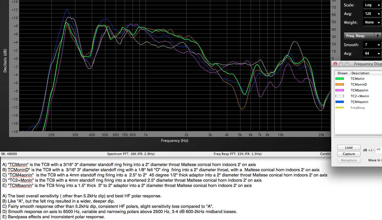

What's the best way you've found to fairly easily match small cone drivers to 1.4" horns?
The bit of experimenting i did today makes me think i need a round throat adapter on one end the full diameter of the cone driver, that flares down to 1.4" on the other end, over who knows what adapter length....
The closer i headed to that idea the better things got.....but totally clueless really....

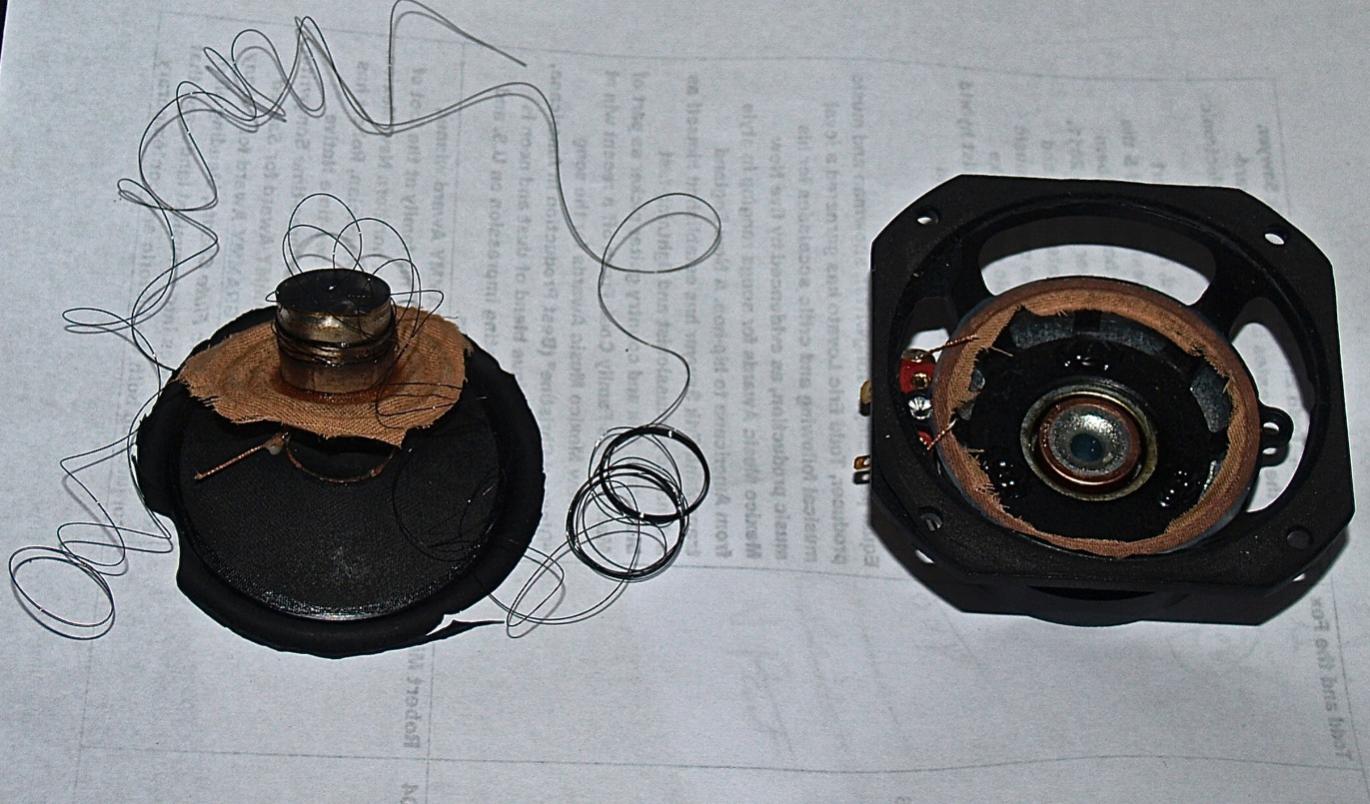

Don't laugh, but i've been testing the little baby doll TC9 with a PL380, at full +32dB....😛
It's just what was handy.
Maybe getting a little overconfident with controlling levels, huh? Lol ...
... can you smell the smoke already ?!

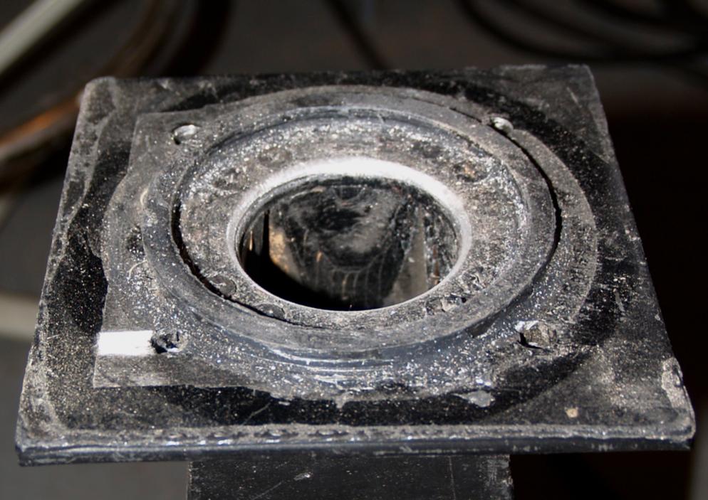

Don't run too many high power sweeps on the TC9....I easily fried a more sensitive Lavoce 4".
At least the TC's cost less than a decent dinner!

Flaring (funneling) down the larger cone to the smaller mouth exit creates a larger throat volume, reducing HF and increasing reflections, making the frequency response choppy (comb filtering).What's the best way you've found to fairly easily match small cone drivers to 1.4" horns?
After far too much experimentation, (AKA turd polishing) the best overall result simply used a baffle with an excursion slot for the surround routed around the perimeter, and the exit cut to the horn throat diameter, the exit rounded to reduce diffraction at the entrance point.
That worked only was a tiny bit better than the simple 1/8" stand-off made from a PVC pipe I used for initial testing, shown below with a 2" exit.
IIRC, took upwards of 250 watt music peaks to smoke the TC9...
More heroic measures would involve design of a proper phase plug, but the TC9's large excursion (compared to HF compression drivers) would still require too much throat volume to have extended HF, don't think results would be worth the effort.
Art
If i understand you correctly, the turd polishing is what if first tried today....a flat baffle, with a 1.4" exit in center, and a ring of relief for the surround's excursion.
It was awful...butt ugly bad ! No HF response at all.
Then i went to a baffle with a full 3" hole for entire TC9, firing into a 2" to 1.4" throat adapter.
Clunky step from 3" baffle hole to 2" adapter for sure, but still much better response.
Albeit with both a strong positive and negative notch.
That's what led me to thinking i need a smooth adapter going from 3" to 1.4"...to keep the decent response and get the notches gone.

Mark,...the turd polishing ..a flat baffle, with a 1.4" exit in center, and a ring of relief for the surround's excursion.
Dunno.....
You are already well down the 3" cone horn adapter rabbit hole journey- beware, what looks decent on axis may be far worse off axis.
See my "E" notes in the condensed (and highly smoothed) version of my journey below. Ended up junking that project, re-used the TC9FDs in mini-monitor boxes that clamp on the boom of mic stands.
Art
