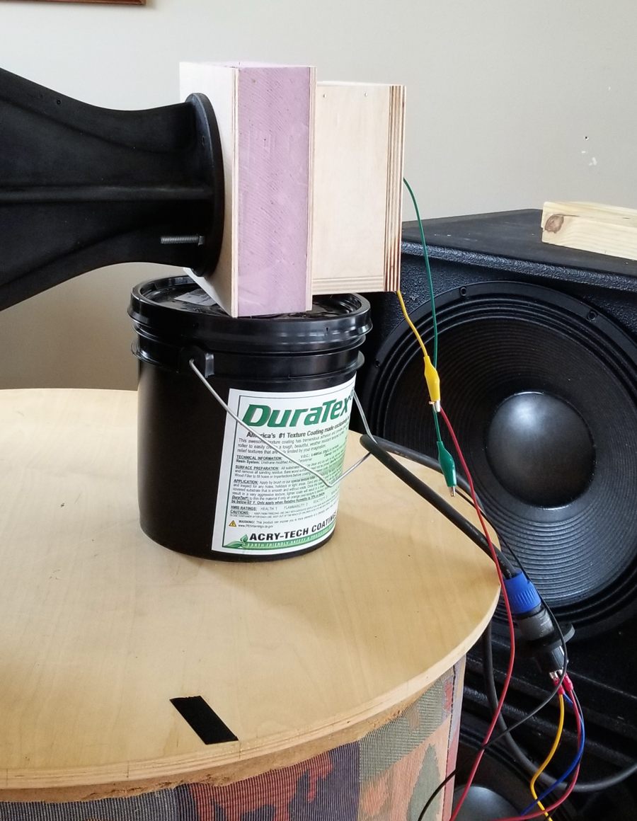

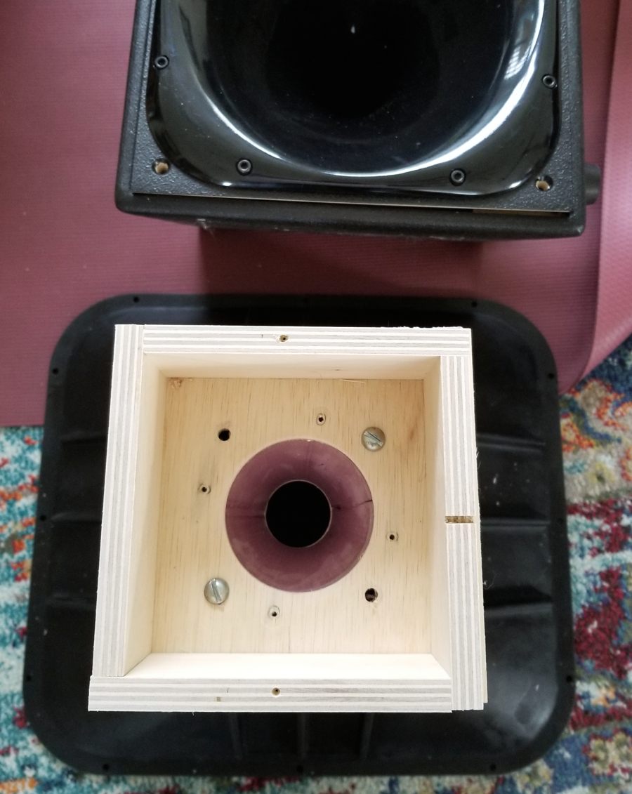

Earlier today, i made a 2" long conical adapter, out of two inch think foamboard, 1.4" to 2-13/16" holes. Pretty easy with a cheap hot-wire table.
Twas 2-13/16" because i switched to a faital 3fe35 which is easier to mount and seal up.
Should have time to test tomorrow...

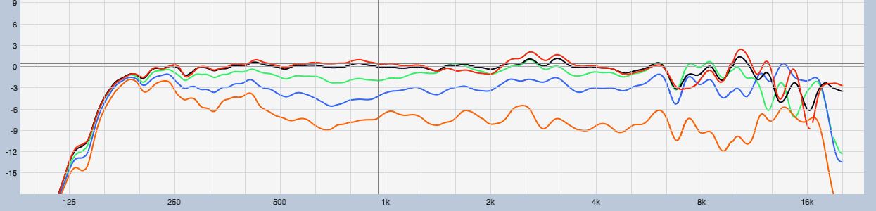

Here's today efforts from the previously described 2" long conical adapter, mating a 3fe35 to the horn.
Used my standard technique..... tune to 10 deg off-axis, see how it holds up off-axis, and then try to adjust where it falls apart.
Horiz polars 0 thru 40 degree, 10 deg steps. 1/6th.
Horn is 80x60. 50 deg H was below -15dB everywhere after 500Hz, not worth plotting.
Vertical polars looked very similar.
I kinda think they are ok, as far as low signal goes.
Time to smoke one and see what's under the hood I guess...😀

It was one of those projects that's a lot easier than it looks, provided you have a hot-wire table. Highly recommend this low dollar guy. Hot Wire Cutter THERMOCUT 115/E – PROXXON Inc
You can see the hot wire, if you look closely in pict below. It's easy to set the angle needed to make the cone cutout. And then just rotate the foamboard on a thumbtack. The gaskets and painters tape were only to shim up the table surface to the level of the thumbtack body, so the foamboard wouldn't wobble when being rotated.

The polar response looks quite good up to 10kHz, and the bottom response impressive, what does the EQ look like?
Did you seal the foam core before measuring?
Art

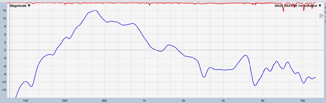

Here's the raw response.
Amazing how much dsp can fix when the response anomolies are minimum phase, huh?
The dips at around 2.7k, 6.8k, and generally everything north of 10kHz, did not not take to correction well...so very little attempted there.
I simply figure if corrections hold up both on and off axis, they are minimum phase and valid. If they don't hold up both on and off, they are bogus and don't make them.
Seem like a valid approach to you?
No, I didn't seal the foamcore, and suspect that may have a negative effect.

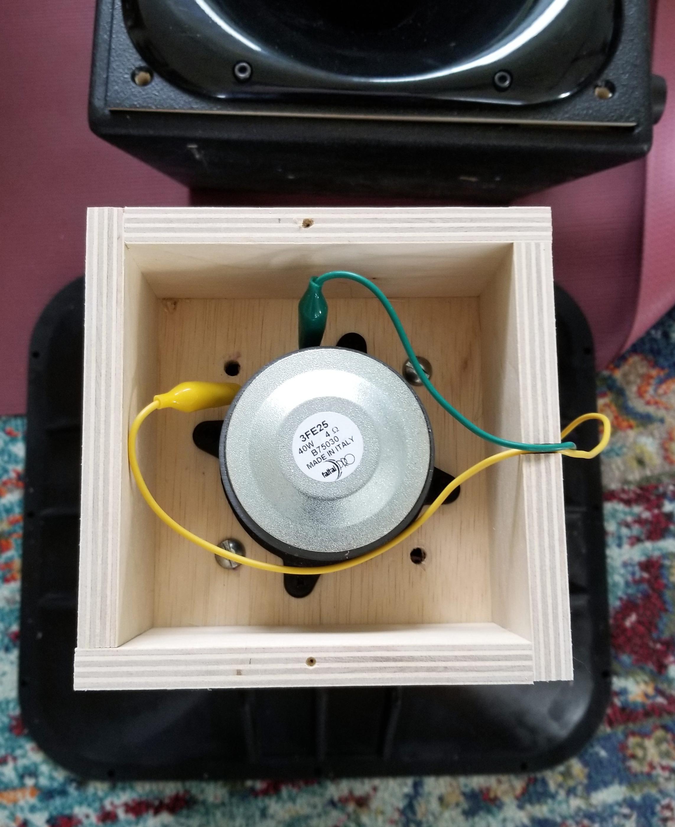

Hi Art, Not sure you saw I switched to using the 3fe25 instead of the TC9, because it is much easier to mount to the adapter i made.
It specs at 91dB 1watt, so dang close to the TC9.

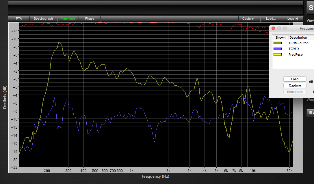

My tests from that time period are "lacking due diligence 😕", but to the best of my recollection/reconstruction, the TC9FD had over 10dB gain below 2kHz on the Maltese horn, dropping to no gain at 16kHz, quite different from your ME464/3fe25 results. The screen shot below shows the front loaded TC9FD response in the lower trace, the horn response upper trace.
The IMD at the low end of the DCX464/ME464, and it's difference compared to large (10"-18") cone drivers capable of similar 125-130dB output in the 300Hz region was my interest, as that may inform the crossover frequency choice more than SPL alone would suggest.
