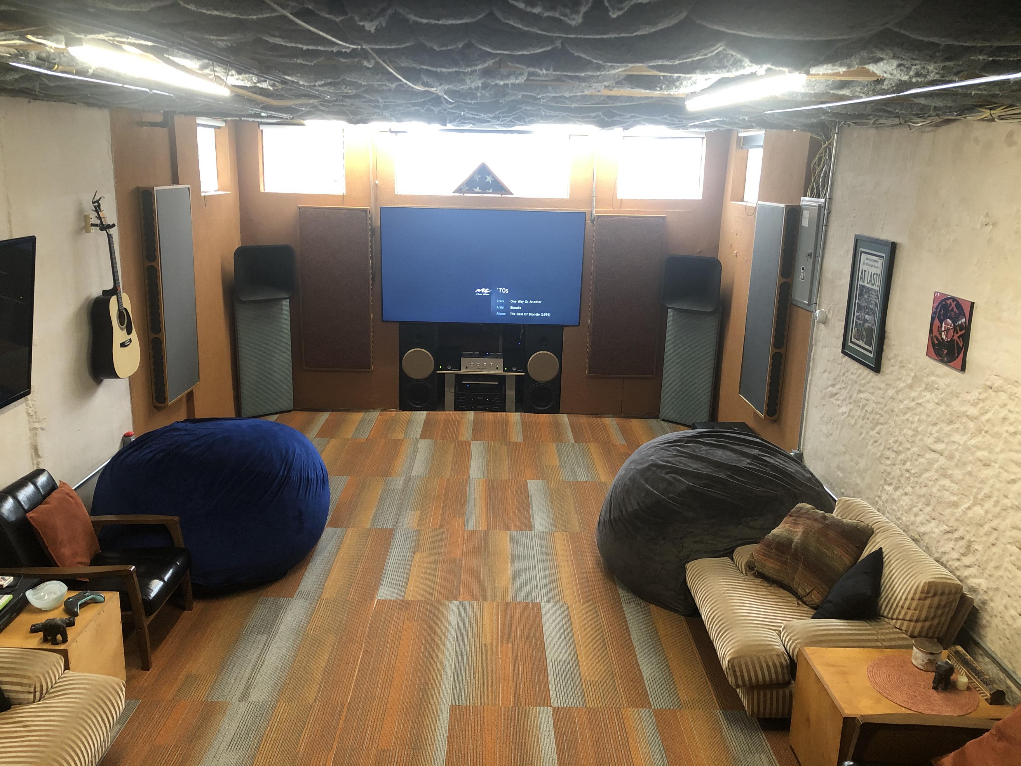

I did finally get the DCX464/ME464 combo up and rolling!
I considered doing an MTM set up as well…having many 15” midwoofers available for this purpose.
In the end I chose to go with a TMM like Mark (sort of). I’ve had the “wall of woofers” setups before, and as fun as they can be, I’ve come to the conclusion they’re just not necessary in my room (fairly well damped at 14.5’ x 28’ x 8.6’).
I prefer a simpler/smaller design nowadays.
With some EQ and crossover work I’m glad I did, it’s really all I needed in this (not large) room of 14.5’ wide X 28’ long X 8.5’ high.
After lots of experimentation with DSP I’ve settled with (for now)-
Bottom woofer (sub) carries 0-100Hz, mid-woofer band-passed at 45-450Hz… both at 24db slope.
For now the CD/horn combination uses B&C’s FB468 passive crossover.

how does it sound ? i assume you use EQ with the FB468 . are you crossing at 450hz ? i would be really curious how well lower crossovers work .
Yes the FB 468 is in line to handle the coax CD.
I then EQ’d the CD alone, then added the midwoofers and subs and finish up the EQ.
The mid-woofers and subs are running off of my crown XLS 1002’s, which have their own crossover capabilities.
My DAC is a minidsp HD, which I use for DSP (duhh!) 😂.
As far as the sound goes, yes I think it sounds great right now, especially with stellar recordings/source material.
Things sounded a bit edgy and grainy when I first got the horns going but I expected that.
When I install new speakers I always use the same procedure after initial DSP-
1- listen for 10 or 15 minutes using the same A side of my favorite album, leave it on repeat and leave the room.
2- come back in a couple of hours and listen to the same A side for 10 or 15 minutes. Leave it on repeat and leave the room.
3- come back in approximately 24 hours and listen to the same A side of the same album.
Most of the time I hear an improvement over time in new loudspeakers in each case.
Listening for only 10 or 15 minutes each time and then leaving the room eliminates the BS (IMO) equation of your ears getting used to the new speakers.
I hope I made some sense LOL..
