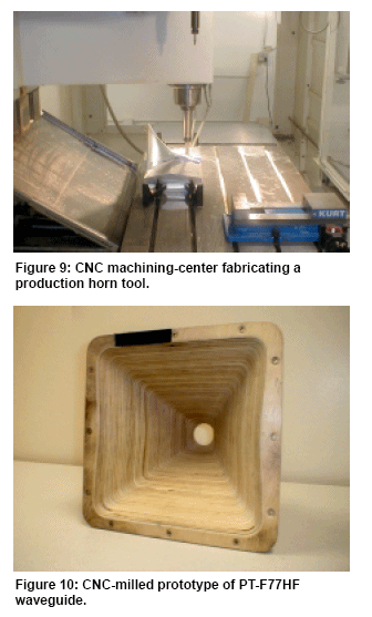

It isn't, not in the traditional sense:tinitus said:Pardon me, but why is it called diffraction horn 😕
By applying advanced 3-dimensional surface modeling, it was possible to create a waveguide surface that eliminates the diffraction slot discontinuity. This allows the expanding acoustic wavefront to remain perpendicular to, and attached to, the horn side-wall at all times
In a PT waveguide, the wave-front is controlled to generate the correct shape to propagate from the waveguide’s mouth. Even though geometrical diffraction is eliminated in PT designs, constant beamwidth and constant directivity are achieved. Improved frequency response, and lower distortion result. PT waveguide design principles are patent pending.

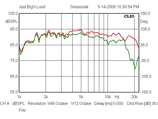

Here's a quick measurement of a PTH1010 on axis Red and 30 degree's off axis Green at 1 meter. Doesn't look to bad to me. They sound good to boot. This is a more expensive waveguide about $100 but the family is certainly are worth a look if you are going to using them above 1K or so.

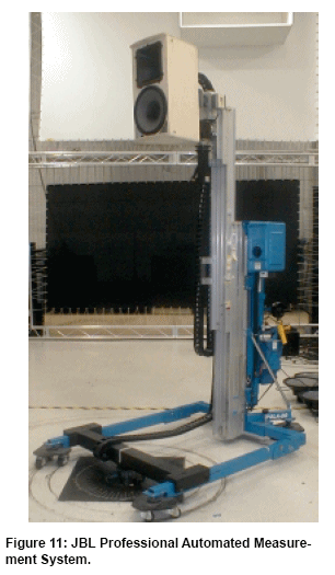

What is the 0deg reference measurement axis for your loudspeaker designs Dr. Geddes?
Always the waveguide center? Or midpoint between woofer and waveguide centers? Something changes in case of a 3 way?
Also for us diyers not having rotation tables, is it best to move the omni mic along an arc, pointing like an arrow in angles, or moving it on a parallel line will be sufficient up to 2m distances?
I am aware that I probably ask obvious things, but I wanna know your input, since I have seen different practices.

No problem with questions.
I use a point between the woofer and waveguide. Its really arbitrary, but can make some small differences.
I really don't like moving the microphone. My rotation table costs about $9.75 (or less than the JBL horn!) 🙂 Really all that is needed are two pieces of wood with a pin in the center so that the top piece rotates. Use melamine for the sliding suraces and I grease mine since the heavy systems can be hard to turn. I build an upright stand about 4 feet tall to put it on. Its all just 2x4's and wood shelving (melamine) - scrap actually. And it works great. In Thailand I used a motorized table - got no better data than I get with the wood plates.
2 Meters is tough to do in a small space. I use 1 meter. But be warned that the distance can make a difference. Closer yields more irregularity than farther away. Many people use 10 meters because it smoothes the curves so much.
