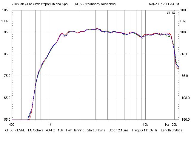

Here are four BMS 4555 drivers on JBL PT-F95HF waveguides, on axis, EQ'd using Altec Model 19 crossover:
Thats a 50 dB spread on the plot. That makes the axial response about typical for an EQ'd unit say +- 2 dB.
But what about off-axis? Its easy to EQ a poor waveguide on axis, but that will usually screw up the off-axis response. A good waveguide has to have off axis control so that it can be EQ'd without serious off axis problems. Axial response curves are just not very useful in determining a speakers performance.

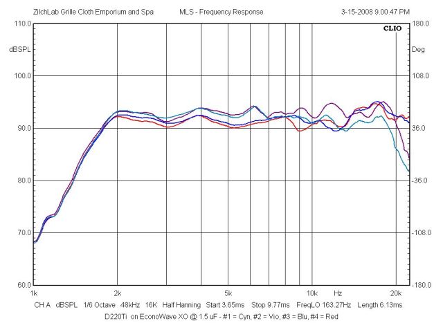

And here's four Selenium D220ti drivers on the $9.90 version of that JBL waveguide, again, on axis, EQ'd using the filter documented in the thread:
Again, about what I would expect for an EQ'd unit, maybe a little worse that typical. Why so much variance in the response from driver to driver? Thats way more than I typically see.
Yes, consistent with your acceptance criterion, in fact.
I can EQ within +/- 0.5 dB, typically, but that's somewhat of an academic exercise, as you know.
Point is, here, in both cases, the "EQ" comprises simple passive HF compensation circuits, in the first case the "Bridged-T" filter in a 25 - 30 year old Altec N1201-8A crossover, and in the latter case, CD compensation based upon the teachings of Wayne Parham on the Pi-Speaker website.
Those are $42 MSRP Selenium drivers in EconoWave, and that's the variability I measure. The BMS drivers, costing fully $100 apiece more, have better uniformity, yes.
The Seleniums were purchased in two lots fully six months apart. Still, even including the unit-to-unit variability, they measure flat within +/- 2.5 dB on axis....
gedlee said:
Only if they also hold that out to 30°!! Thats the hard part, not on axis, thats easy.
Well, for $9.90 plus shipping, you can easily document the polar response for everyone's information.
