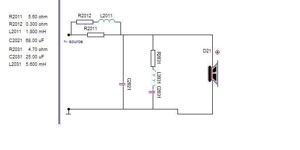

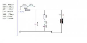

Here is the 2226H part.

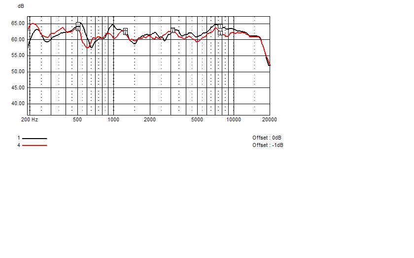

Here is the simulated (red) and measured (black) curve at 1.40m on axis. It looks OK 30 degrees off-axis too.
The reduction of C1031 from 2.2uF to 1.8uF brings the 6-10 kHz level 1-2 dB down.
Use the network as a guideline if you want to. I think the system sound good (and packs tremendous punch) - but I wouldn't be suprised at all (in fact, I almost expect it) if Earl's waveguies will sound better.

I recommend the LRC across the driver not in series with it. In my deisgns I shoot for +-2 dB at all frequencies and all forward angles (and achieve I should mention). This is tough to do as you show.
