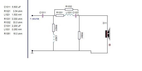

warnsey said:
So could the 2226 be crossed at 900hz with the 2426H? The 2226 seems to have a reasonably flat response to 1000khz and the 2426H looks like it could be crossed at around 900hz. Would I be asking to much of each driver?
Pispekaer P4 cross the JBL 2226 even higher. From memory it is 1200Hz using a passive 3rd order.
http://www.pispeakers.com/catalog/product_info.php/products_id/105
In a word: no.
I have crossed the 2226 with the 2425 (slightly older version of 2426) on the 2370 horn at 1 kHz with a 4th order passive with good results. Personally, I would not bother with a supertweeter, as this combo is flat to 16-17 kHz.
The 2226 is an excellent sounding driver, and can easily reach 1 kHz.
Many comments unfavourably on the 2370 horn. Though I freely admit that there are better horns for the 2425/2426 drivers (the JBL 2344, for instance - and, yes: I have ordered DIY waveguide kits from Earl to try them out) - I rather like the 2425/2370 for hifi.
IMHO, much of the bad rep the 2370 has concerning hifi is because many tries this horn with misaligned crossover networks. The 2370 is a CD device, and for hifi use needs CD compensation. Without compensation, it often can sound very peaky and nasty.
Thanks for the reply. I think that's what i'll end up going for. I may add a super tweeter, such as the Visaton Tl 16 H later as I think designing a two way crossover would be easier.
Any advice on a two way cross over for the 2226J and the 2426J using the 2370 or similar horn?
I have constructed and made a 2226H (nominal 8 ohm) and 2425J (nominal 16 ohm) network with CD compensation for the 2370 horn. See networks and frequency curves below.
I would guess that the 2426J is a drop-in replacement for the 2425J, and no changes in the HF part is necessary. But bear in mind that my crossover uses the 2226H - not the 2226J.
PS: Later, I have reduced the 2.2uF C1031 down to 1.8uF
