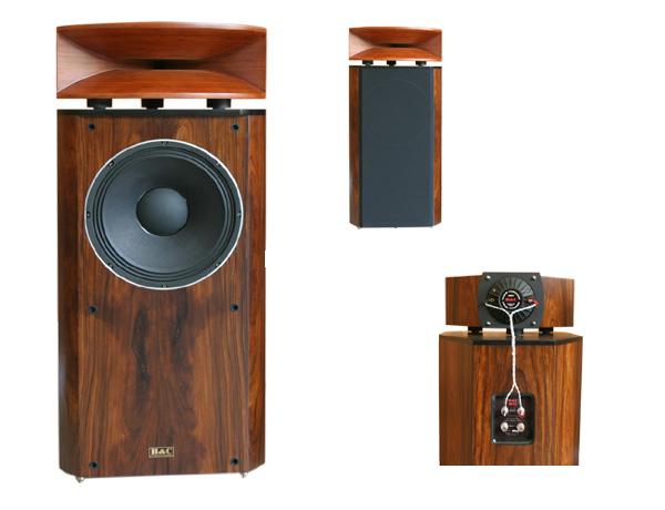

Any sugestion about Box.
Something like on Att.
Thanks in advance.

Hi Guys,
Do any of you have an opinion of the combination of B&C DE250 with the B&C ME45 horn?
The response looks superbly flat, and there are few ripples in the impedance as far as I can see. See DE250 data sheet - http://www.jpleisure.co.uk/DE250.pdf
The ME45 horn is appealing to me because of its narrow height, which should allow it to be used in a MTM kind of arrangement.
