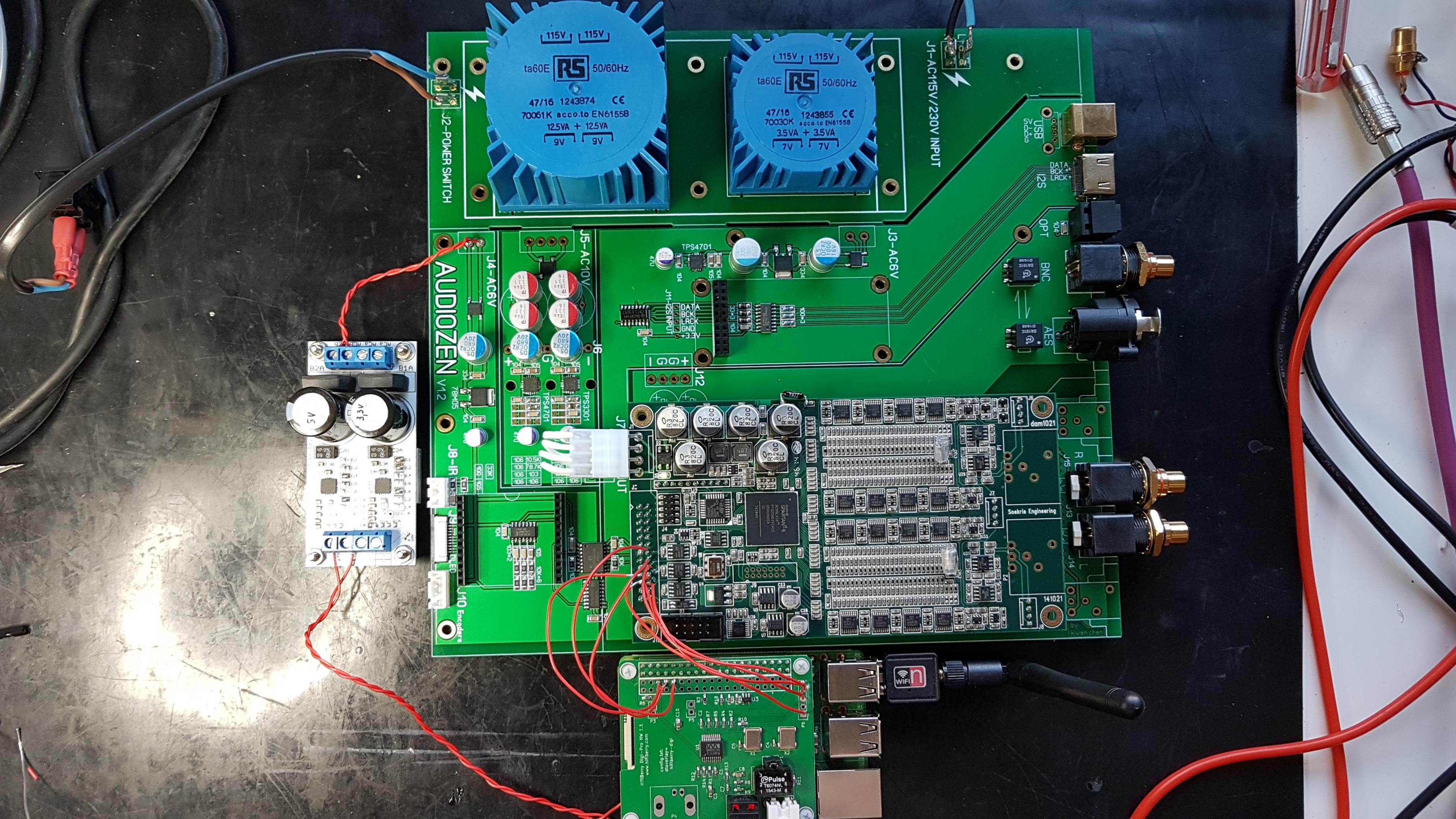

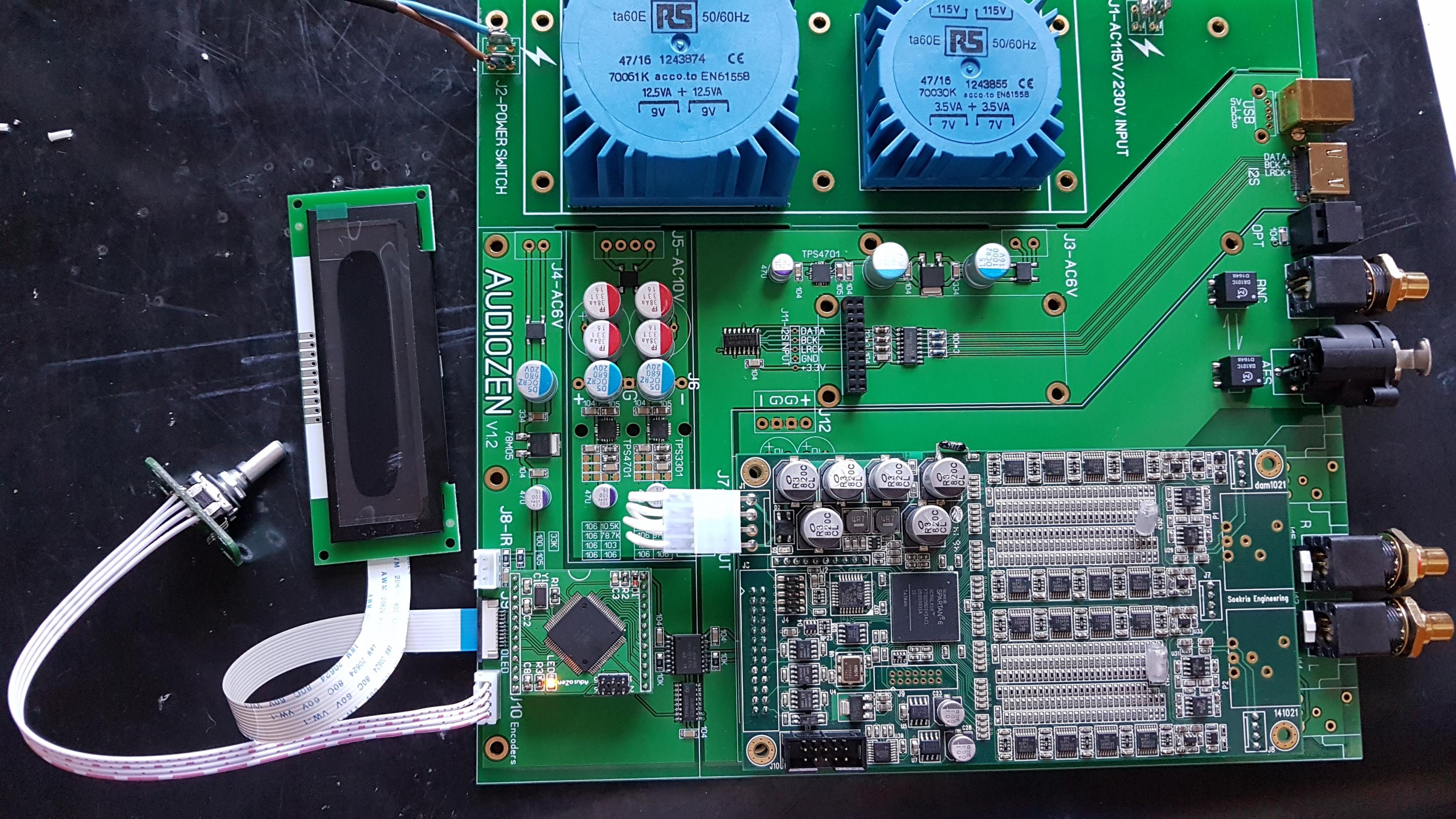

Connected everything. Led lights both on the control board and dam1021 lights up nicely. However no reaction on the OLED display 🙁 Will do some fault digging later. SK version
Disconnected the control unit and just use the sk1021 as PSU for the dam.(and Vac for an rpi) I2s and serial as before. At least it works.. I am not able to get the oled to work

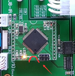

Please change the direction of the control panel. This MCU notch is printed backwards. I'm really sorry. It's bothering you. The MCU is plugged in and won't be damaged. The firmware is up to date. I checked the records and only your MCU PCB needs to be inserted backwards.
