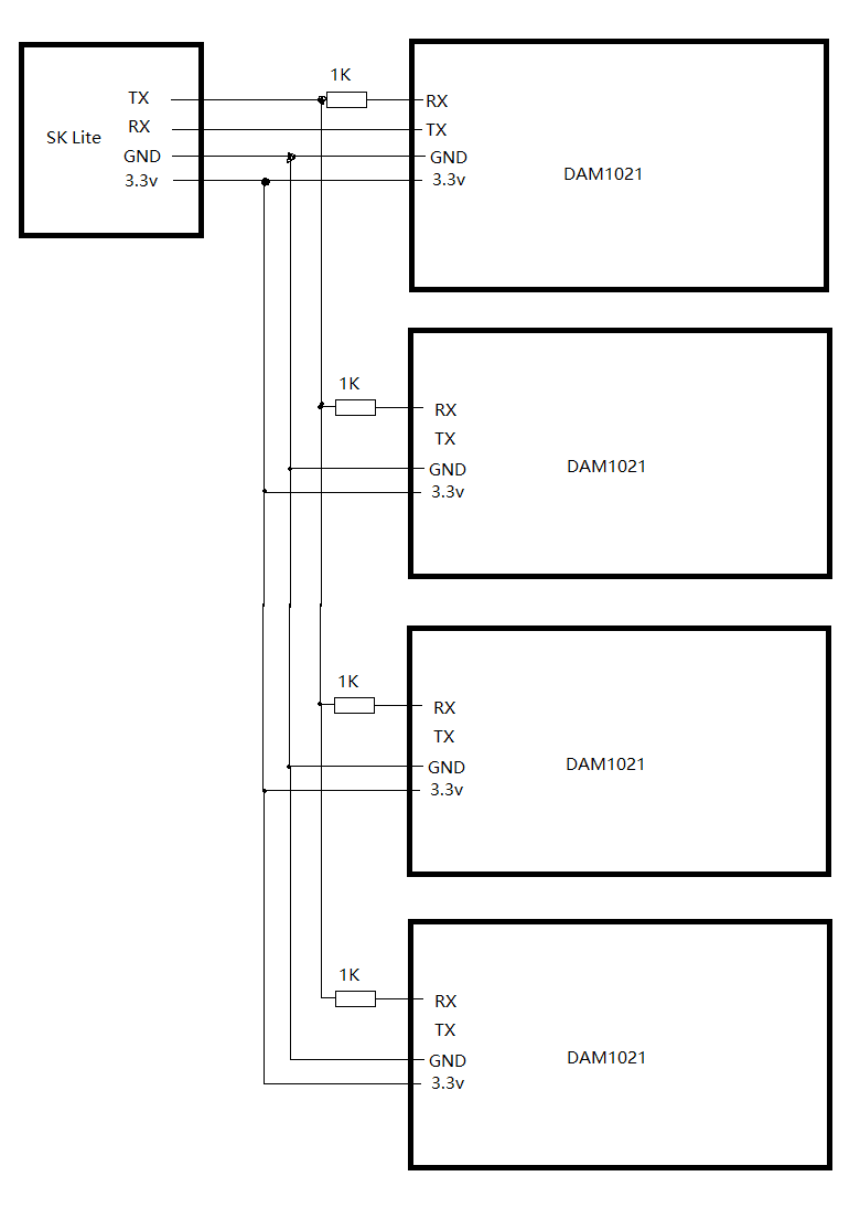

Hi All,
My DAM 1021 is directly connected to RPI configured to output I2S. The I2S lines from RPI are connected to the isolated I2S input lines on DAC. The DAC J3 socket isolator 3.3v leg is fed from RPI and the isolator GND also from RPI.
Is it possible to connect the SK Lite in this configuration together with the RPI?

The isolator 3.3 v can be powered by sk lite. See the attached chart. The single dam1021 does not require 1k resistance.

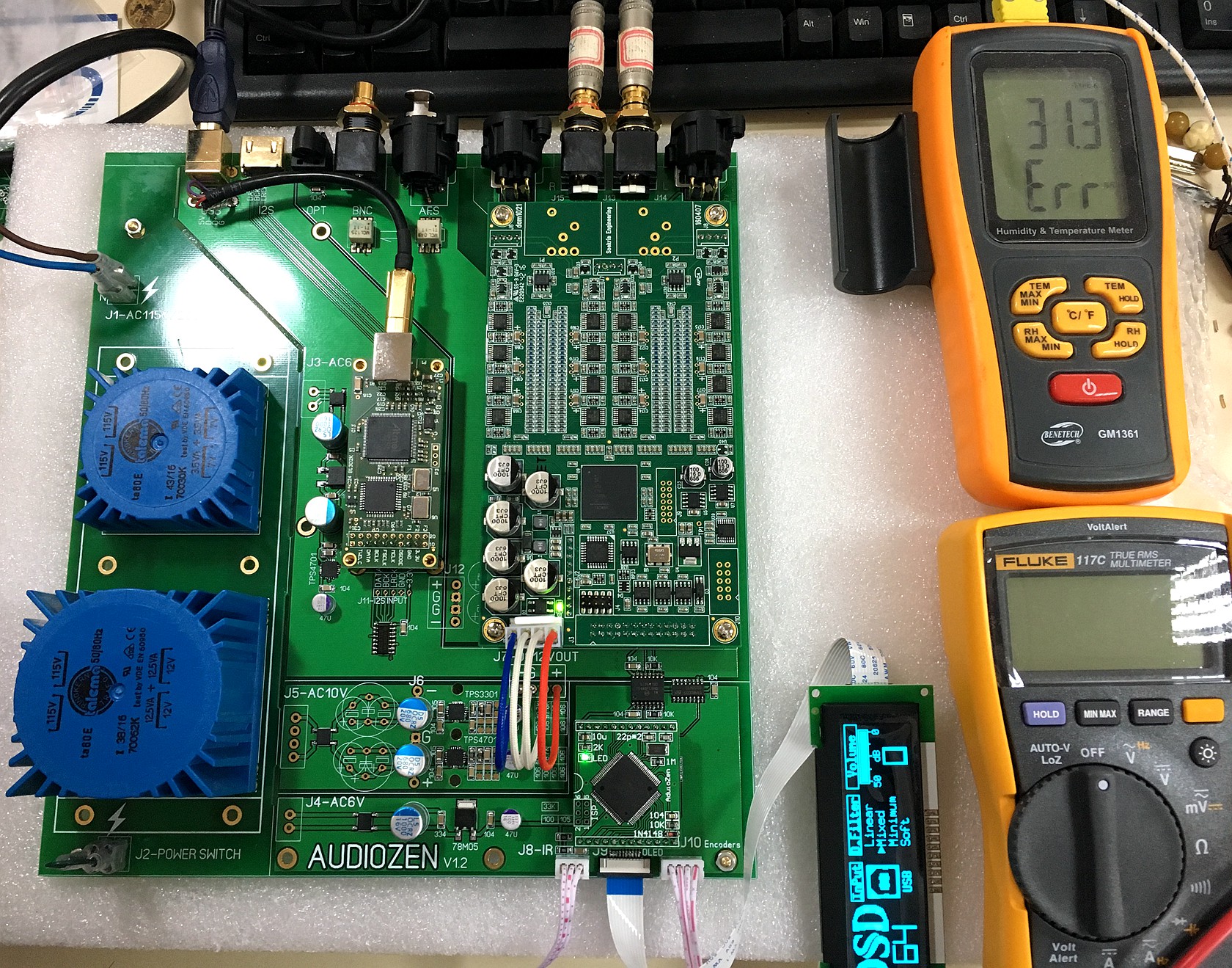

Hi Carsten and the other SK owners
This heat sinks are a great solution. I ordered them immediately to be on the safe side. Enzotech has also other nice heat sinks for other chip packages and as far as I know the double sided heat transfer adhesive from 3M that is included, is the best on the market.

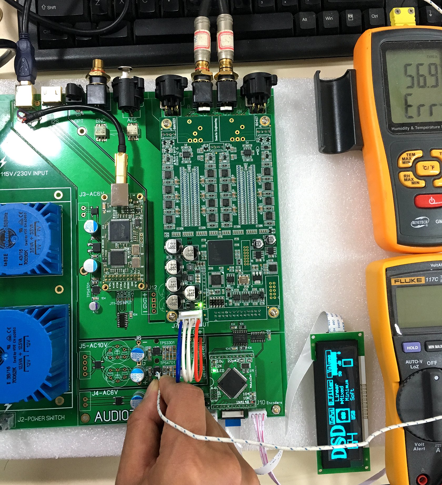

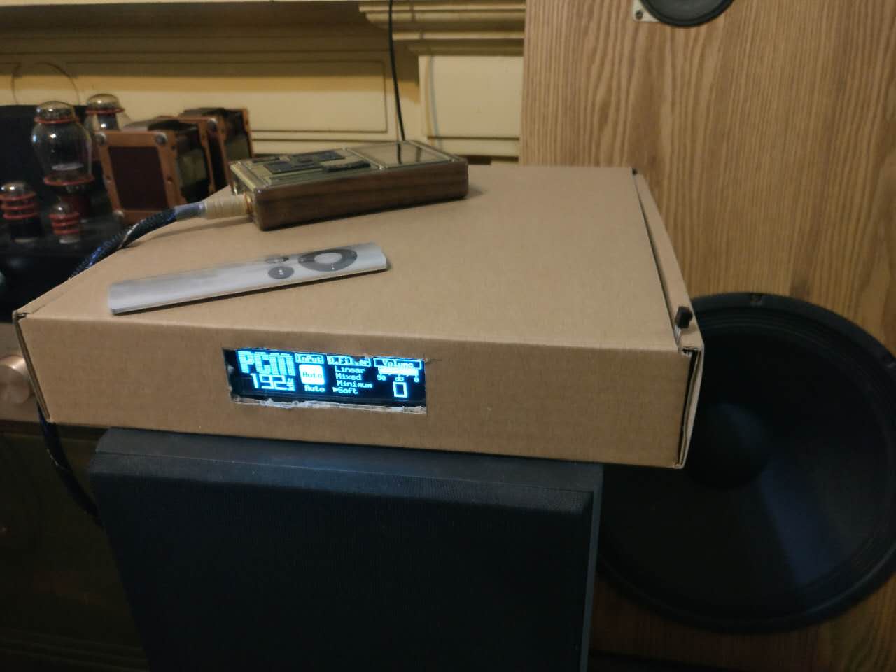

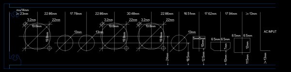

Got the a case from modushop. Next step to make a nice front panel design.
A AZ1021 SK user sent me his picture, very environmentally friendly.

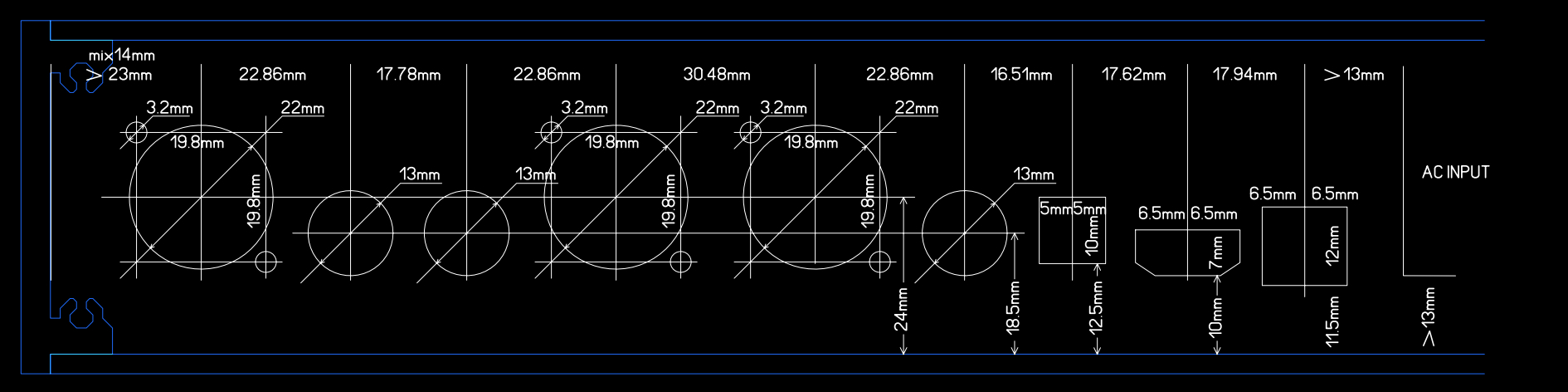

I think I need to reevaluate the matching chassis. Before that, I will share the dimensions of the rear panel as soon as possible.
I use the box too, only I didn't make the cut outs. It would be very nice to know the panel dimension.
Hah, I think I am going to do a cardboard faceplate on mine just to be able to set it up, until I find someone to machine my existing one.

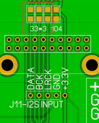

Hi all,
I had a raspberrypi and I2S wiring question, can someone show me the right?
Is that right?
RPI 40 => J11-I2S INPUT - DATA
RPI 12 => J11-I2S INPUT - BCK
RPI 35 => J11-I2S INPUT - LRCK
and GND

The holes for the extra caps. What is the advantage of fitting extra caps?
SK original solid capacitor is 680uf/20v.
