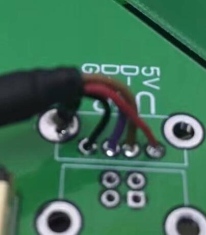

Are the usb wiring colors as in first picture of #1? Or are they random?
5+ (red)
D- (brown)
D+ (purple)
G (black)
I checked with dmm and have 5+ on the brown and D- is red.

My usb isn't working. In the device manager I get the following error: 43 "Device Descriptor Request Failed"

Please connect the usb card to your computer directly.If usb card working well, check if there's a problem with the usb cable.Maybe the usb cable sequence error.
Purple D+, Brown D-. Red +5V, black GND.
I used wrong wiring, fixed: Purple D+, Brown D-. Red +5V, black GND. Working perfect now. Thank you very much.
