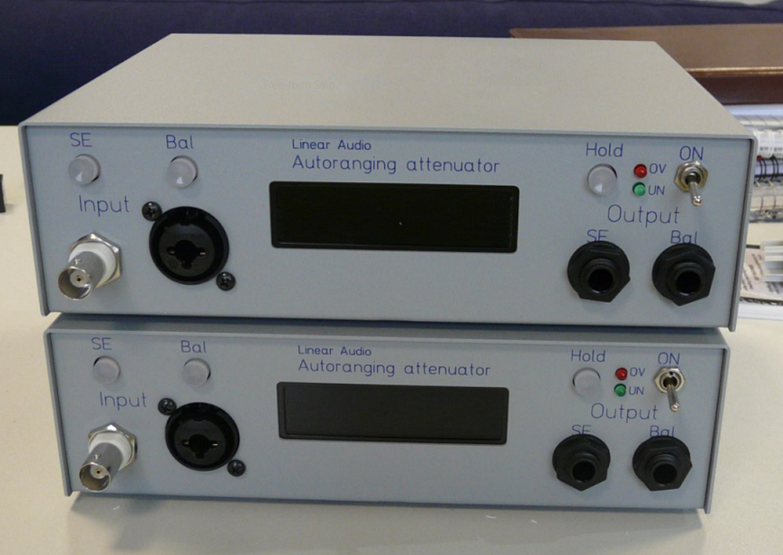

A pair ready for shipment to the beta testers. I actually made my self-imposed deadline 'end of 2016' 😎

Hi Jan,
That is an excellent looking unit. Do you have basic specs for it yet? Stuff like maximum frequency -3 dB point, maximum input level? Stuff like that. I guess we might need the lowest frequency too.
-Chris
I still have to put a spec sheet together, but so far I have:
- a few Hz to 100kHz within +/-0.1dB;
- THD around -118dB (best I could measure with a Sys2722 so could be less);
- Vin max 100VRMS, gain range -40dB to +16dB in 4dB steps at also 0.1dB accuracy.
- The level display is accurate (after calibration) to better than 1%.
There's no minimum level but at +16dB for 1V out the input level is around 160mV IIRC.
Jan
Two units are in beta test with a few people. I am getting some feedback with recommended changes, in particular on the data displayed.
There may also be a review in an audio journal.
I expect to start the Kickstarter start of the summer.
It has taken a bit longer than I expected but functionally it is done and works as expected.
