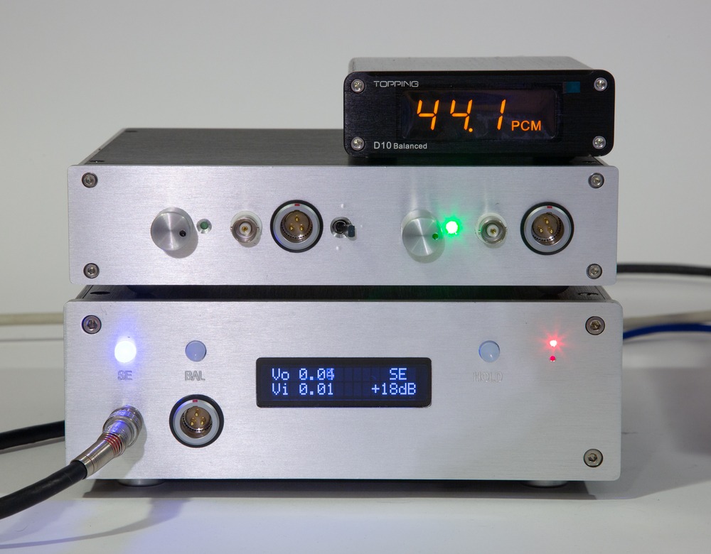

The entire setup.

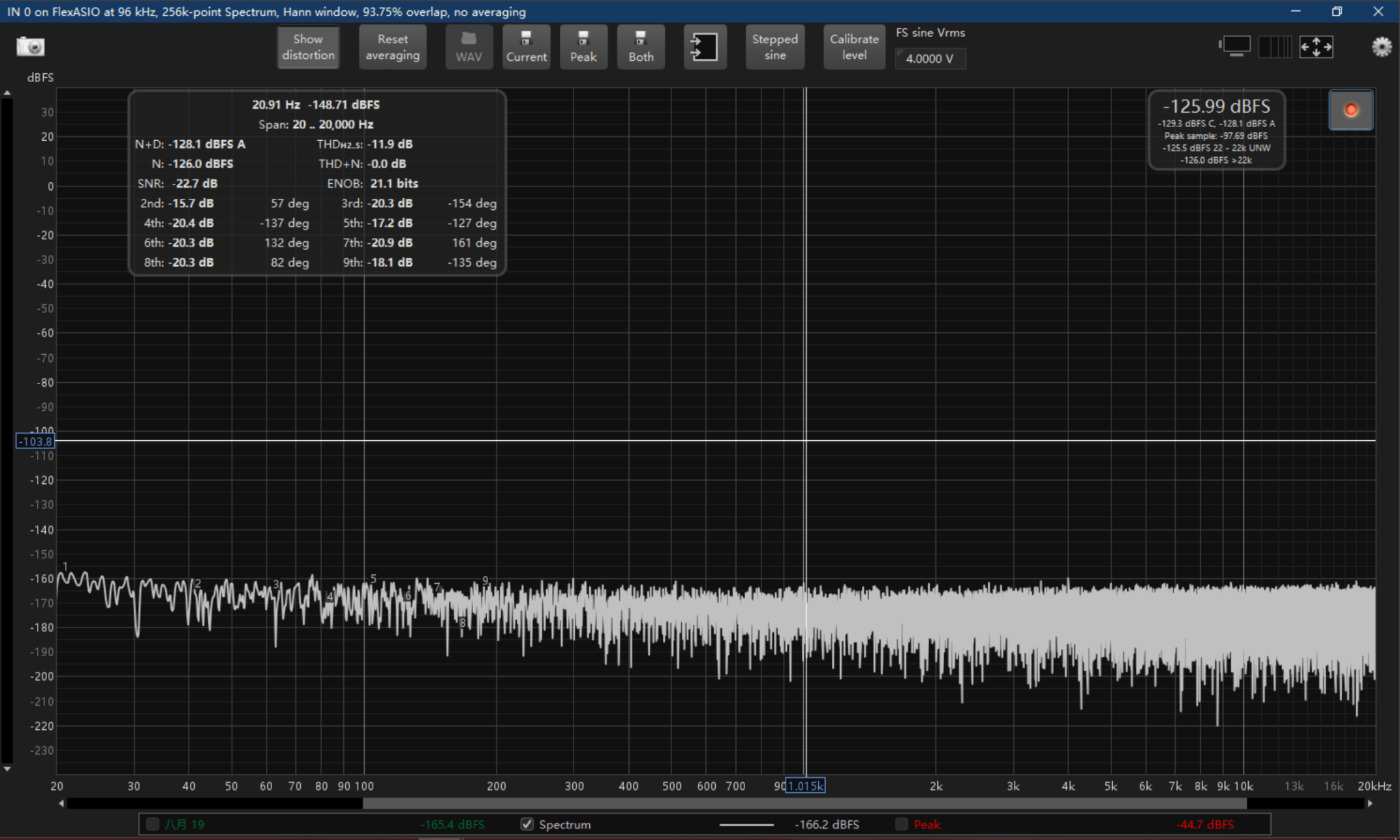

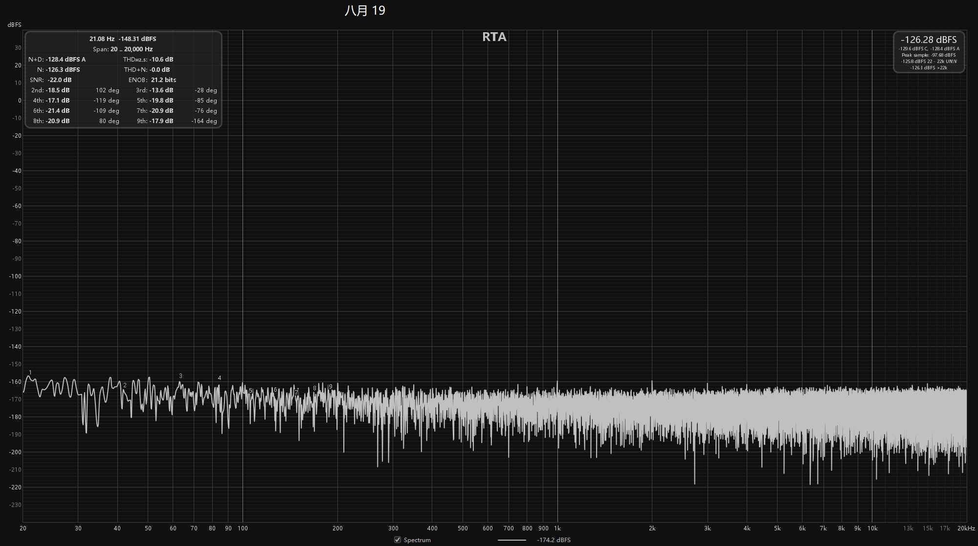

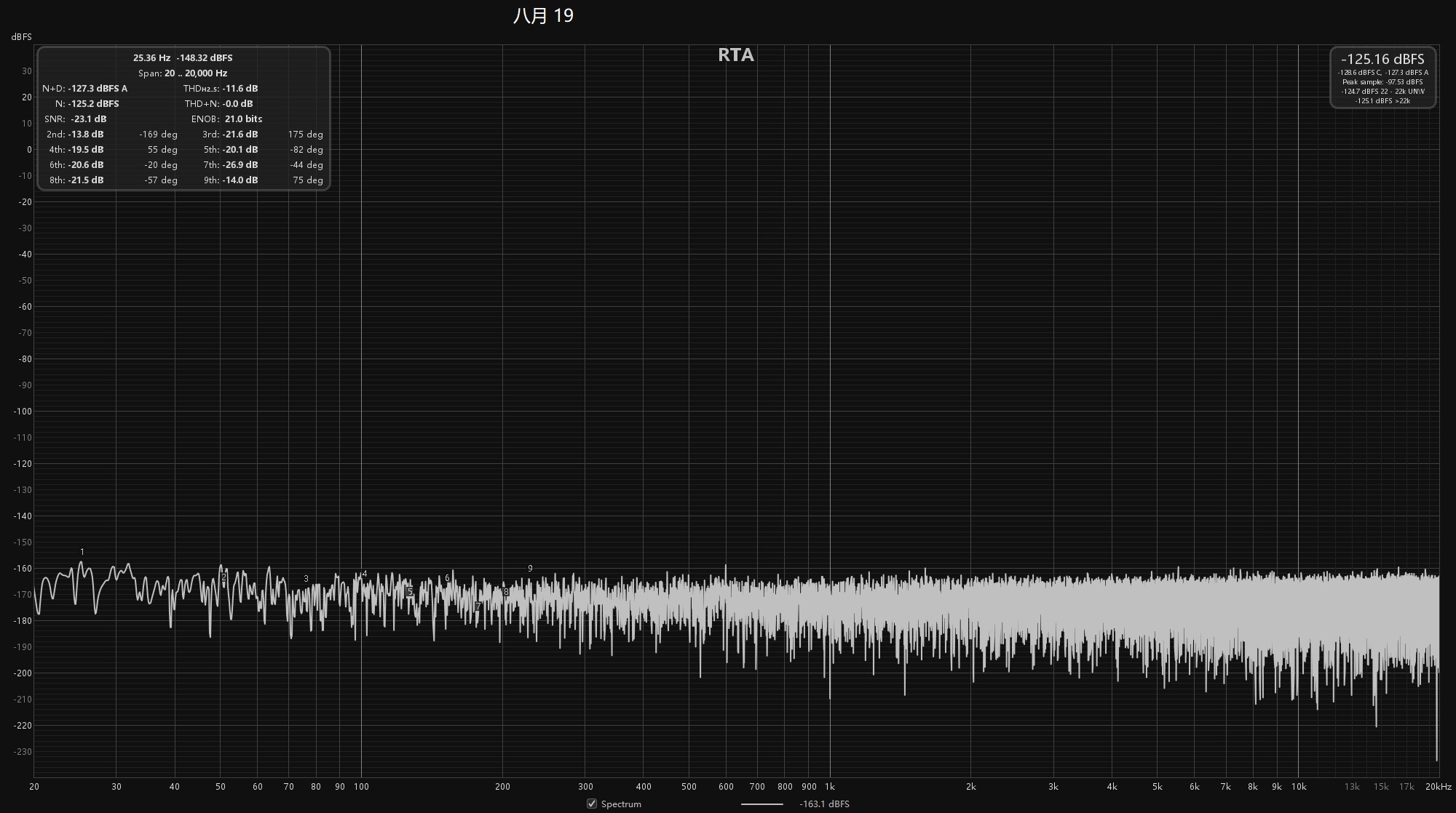

I bought the AR2 from someone recently and did few measurement.
The AR2’s input is shorted. Then routed to e1da scaler(fixed at 0dB gain) and then to ADCiso(6.7v). OP Amp used were opa1656.
0dB attenuation
-6dB attenuation
-18dB attenuation
-42dB attenuation
BTW, does anyone know if it is possible to make the autoranger target higher voltage level than 4v? E1da ADC can accept 10V input.
