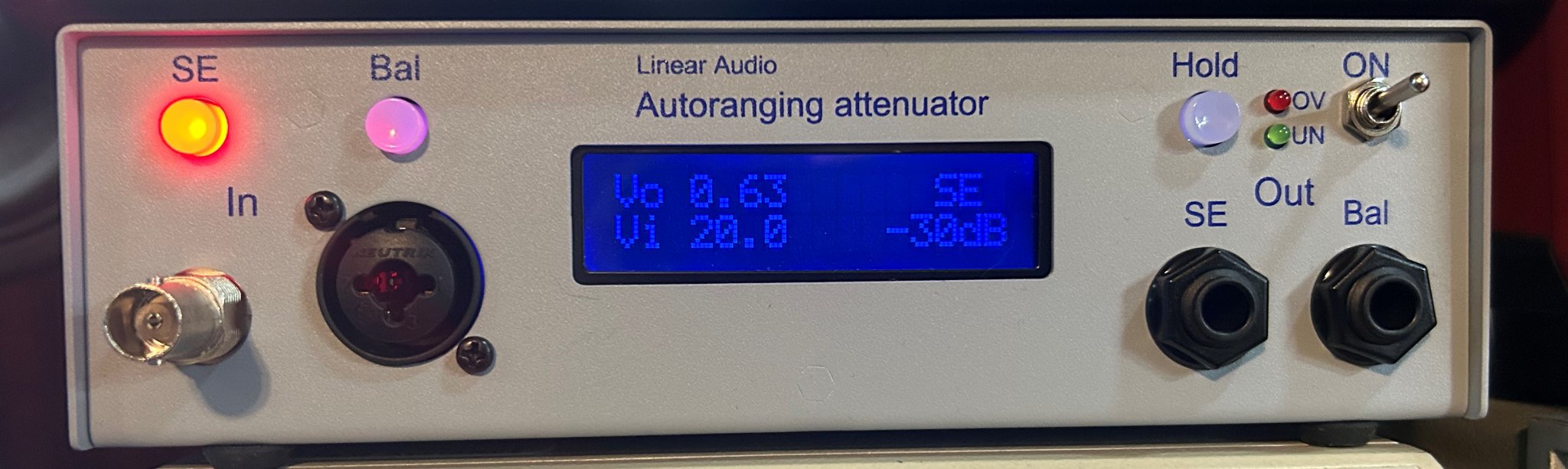

I recently completed assembling an Autoranger kit. I had an initial problem getting it working which turned out to be the LTC1968 chip not making connection on some pins. It seems to work OK now, properly autoranging when different voltages are applied - but what I am noticing is that Vi will stay at whatever voltage it peeked at...as shown in the image below all connections have been removed but it's still showing 20v input. Occasionally it does change attenuation and goes back to near 0 after input is removed or turned off - but usually it stays anywhere between 0 and whatever value it peeked at. If I press hold and manually change the attenuation to +18dB it goes back down to near 0, but doing this each time is a bit of a hassle. I asked my friend and he said his does not do this so I thought I would ask here if this is how it is supposed to work?

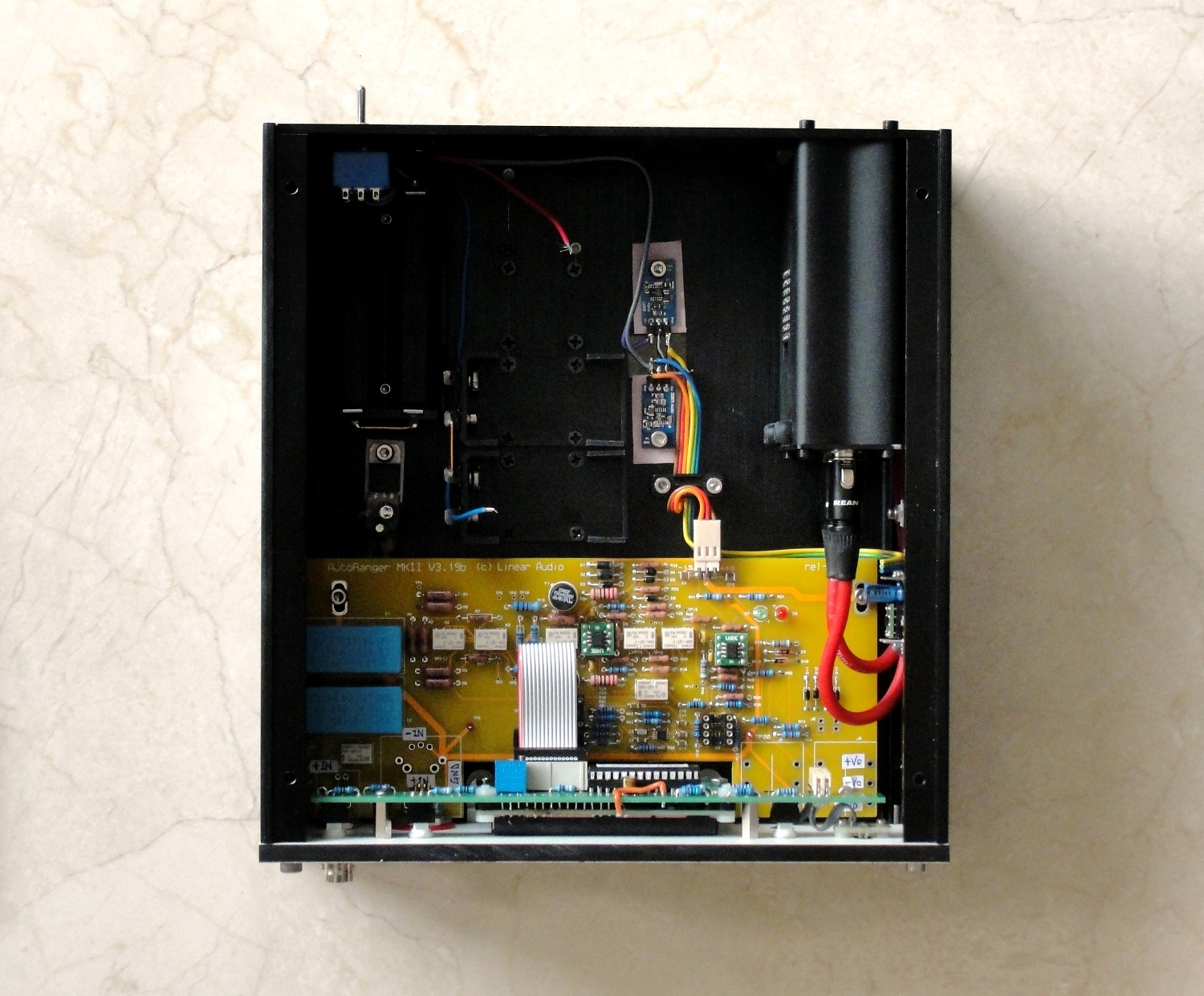

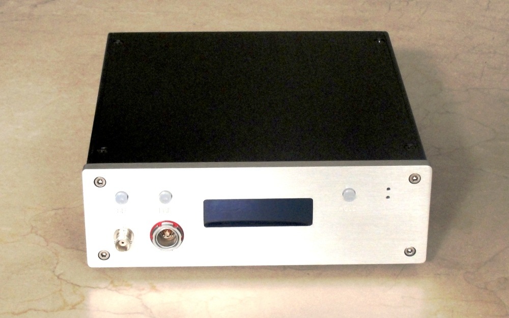

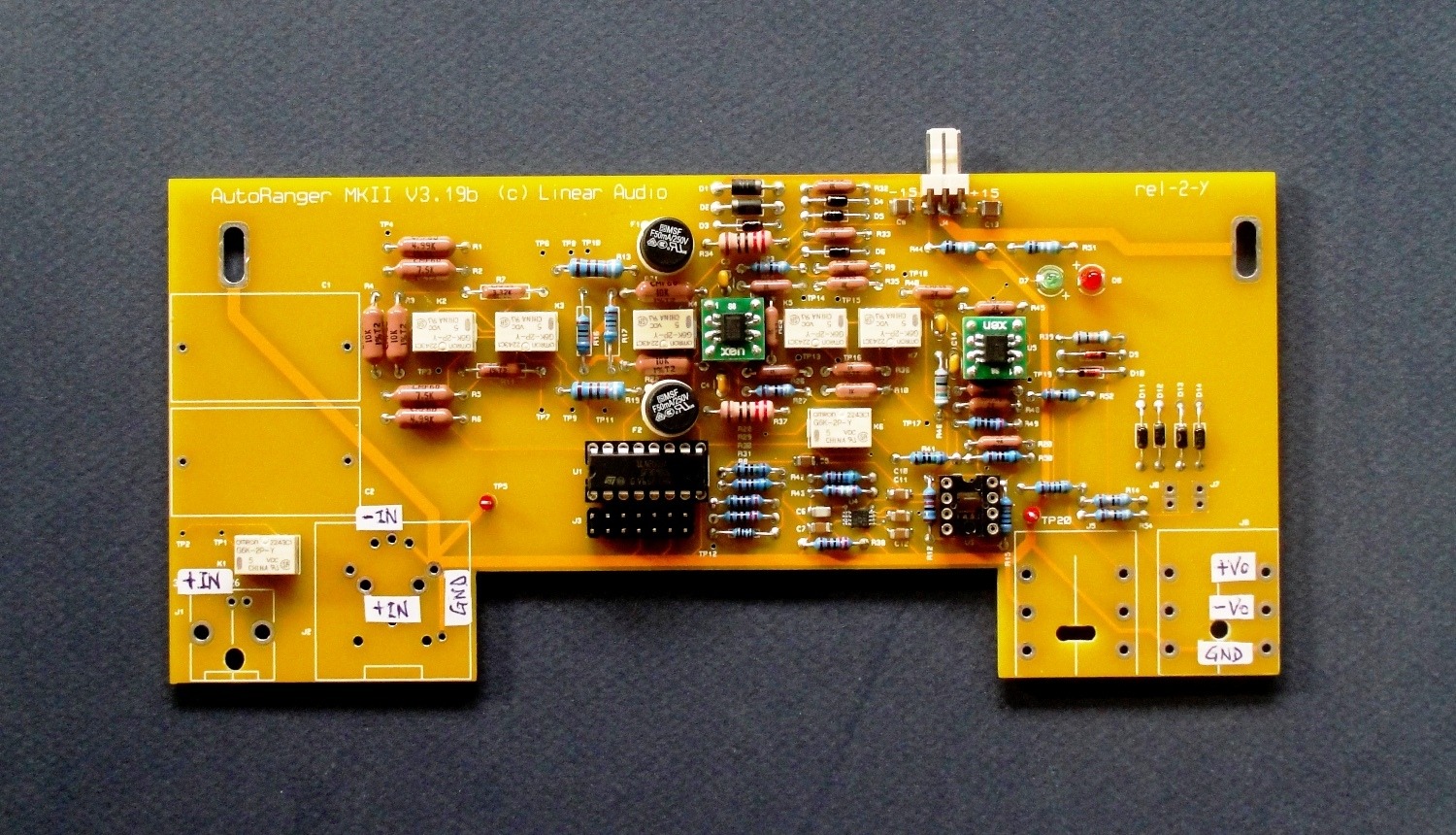

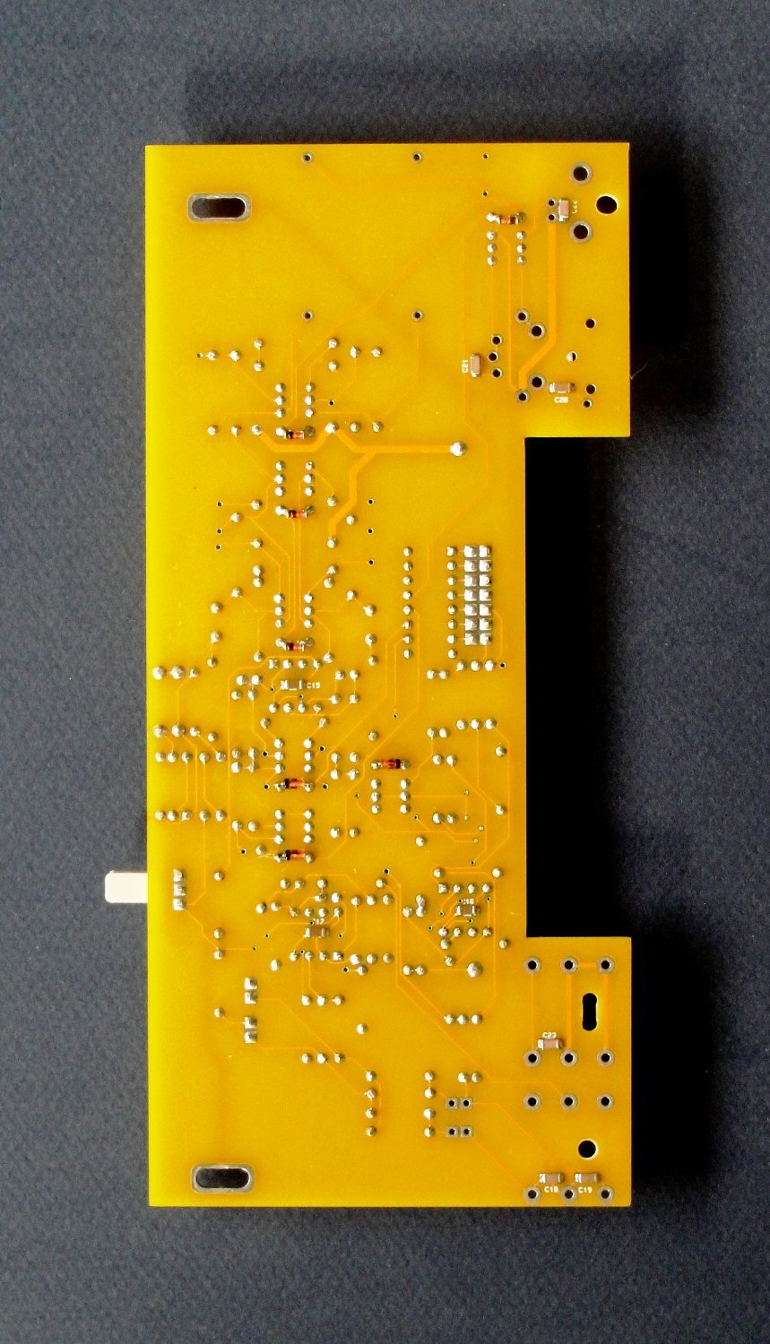

Seems there are no photos of V3.19b, so here it comes.
I am only using balanced output to drive a E1AD ADC via an OPA1622, both inside the same box.
So no output connectors.
Battery power for both 5V and +/-12V with post regulators.
Patrick
Patrick
Now with CNC machined front panel.
Patrick
Patrick
Congratulations. Excellent merging!
Now, show us the rear panel 🙂
George

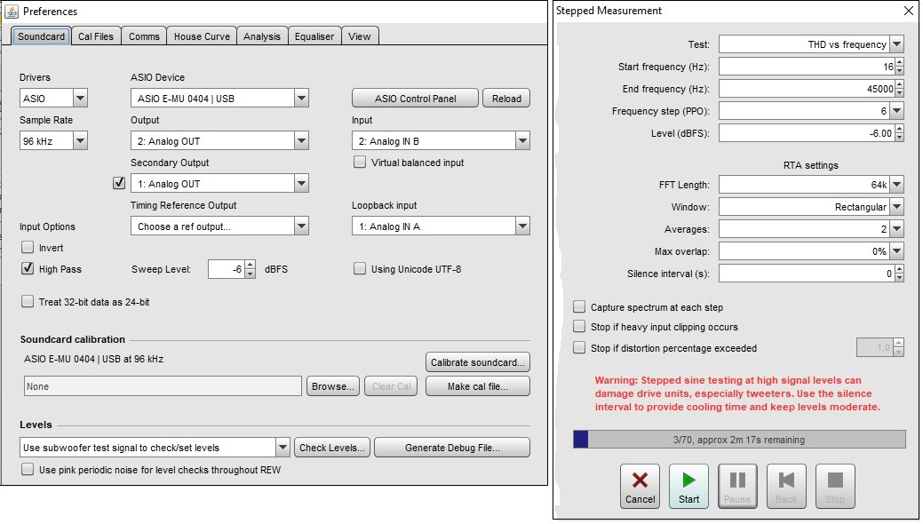

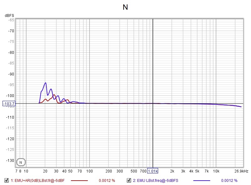

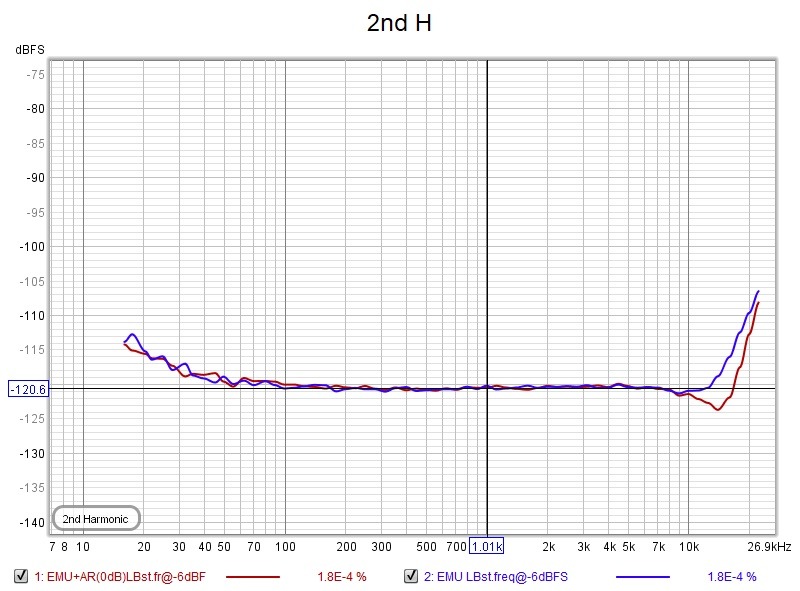

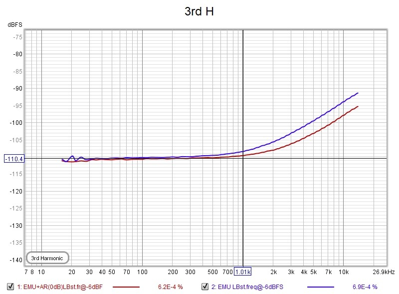

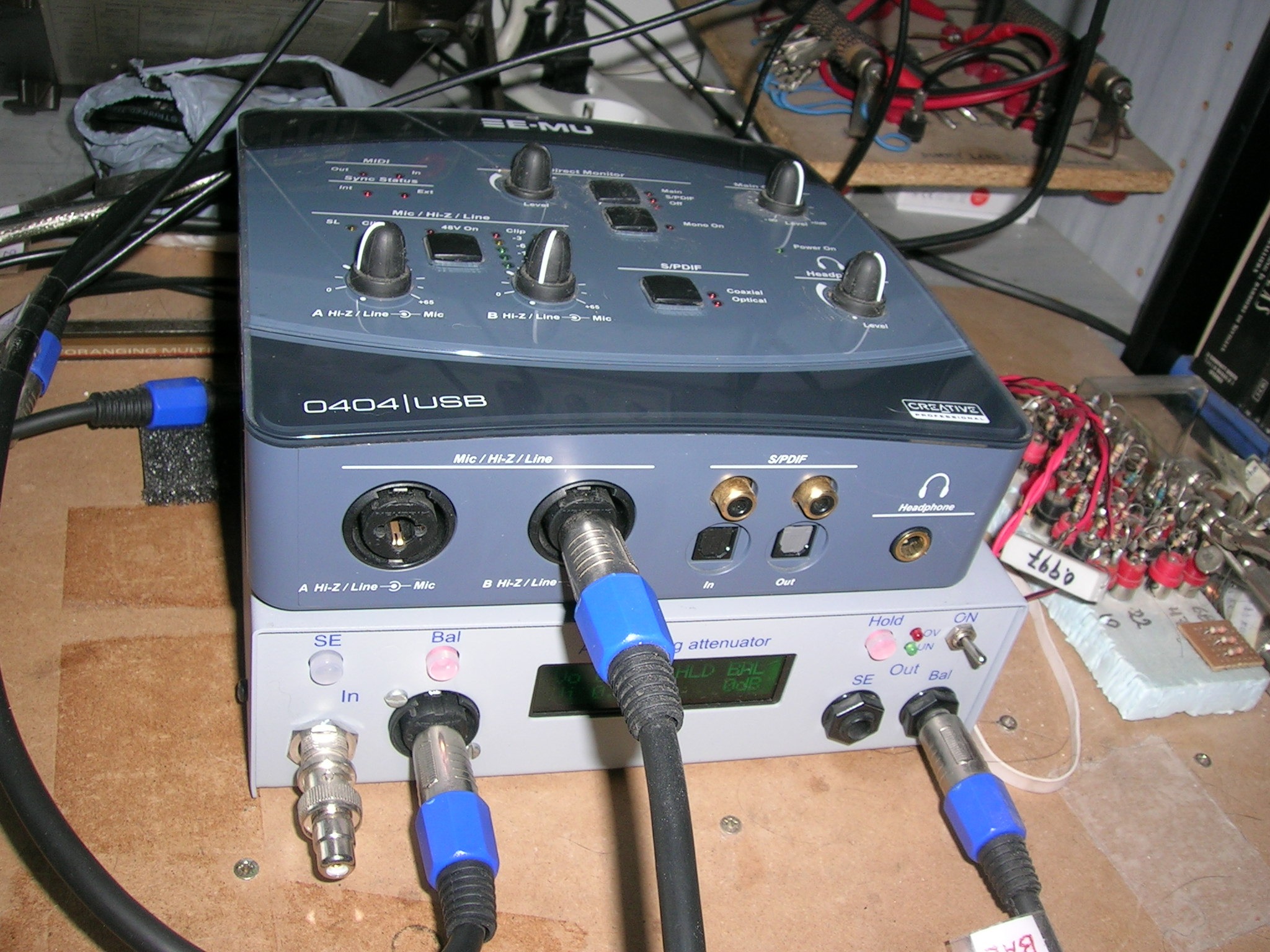

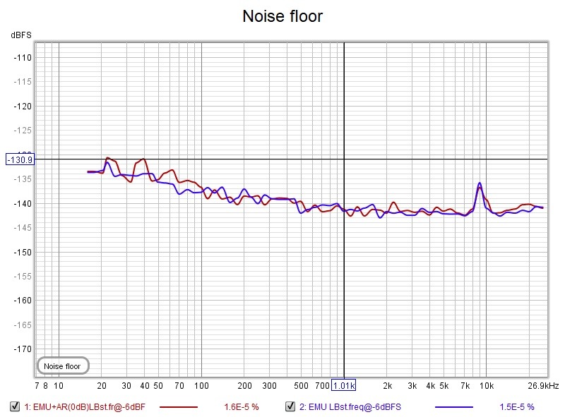

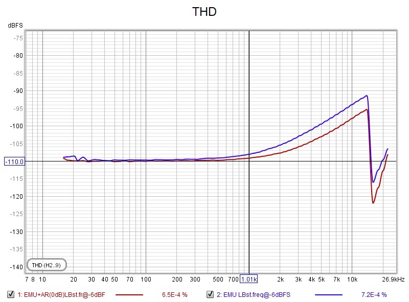

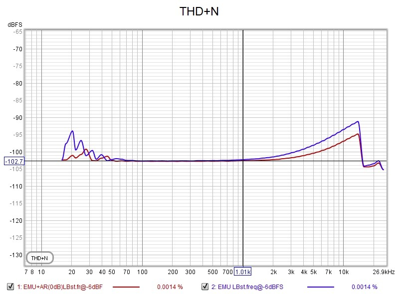

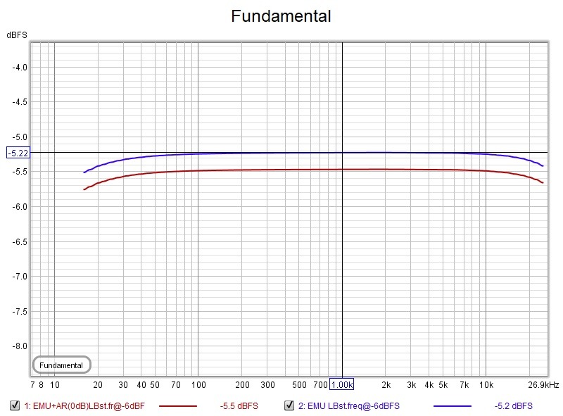

With my EMU 0404 soundcard (AK5385A ADC, AK3996VF DAC), Jan's AR seems transparent (see attachments, settings are close to Pavel's.
Please keep us posted with some measurement screenshots of your test set up 🙂
George

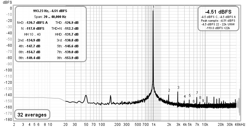

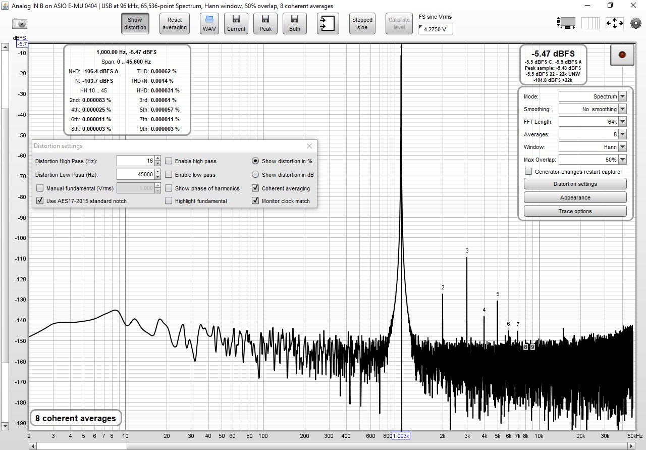

As requested, a FFT of the Viktor oscillator in single ended mode, through the AR, to E1DA.
Pretty sure those harmonics come from the opamps (OPA1656 + OPA1622) as the Viktor (latest version) is below -150dB.
So we can measure down to -120dB reliably.
Patrick
Patrick
