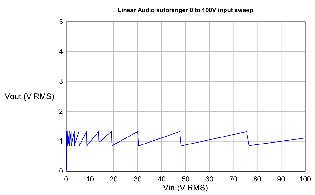

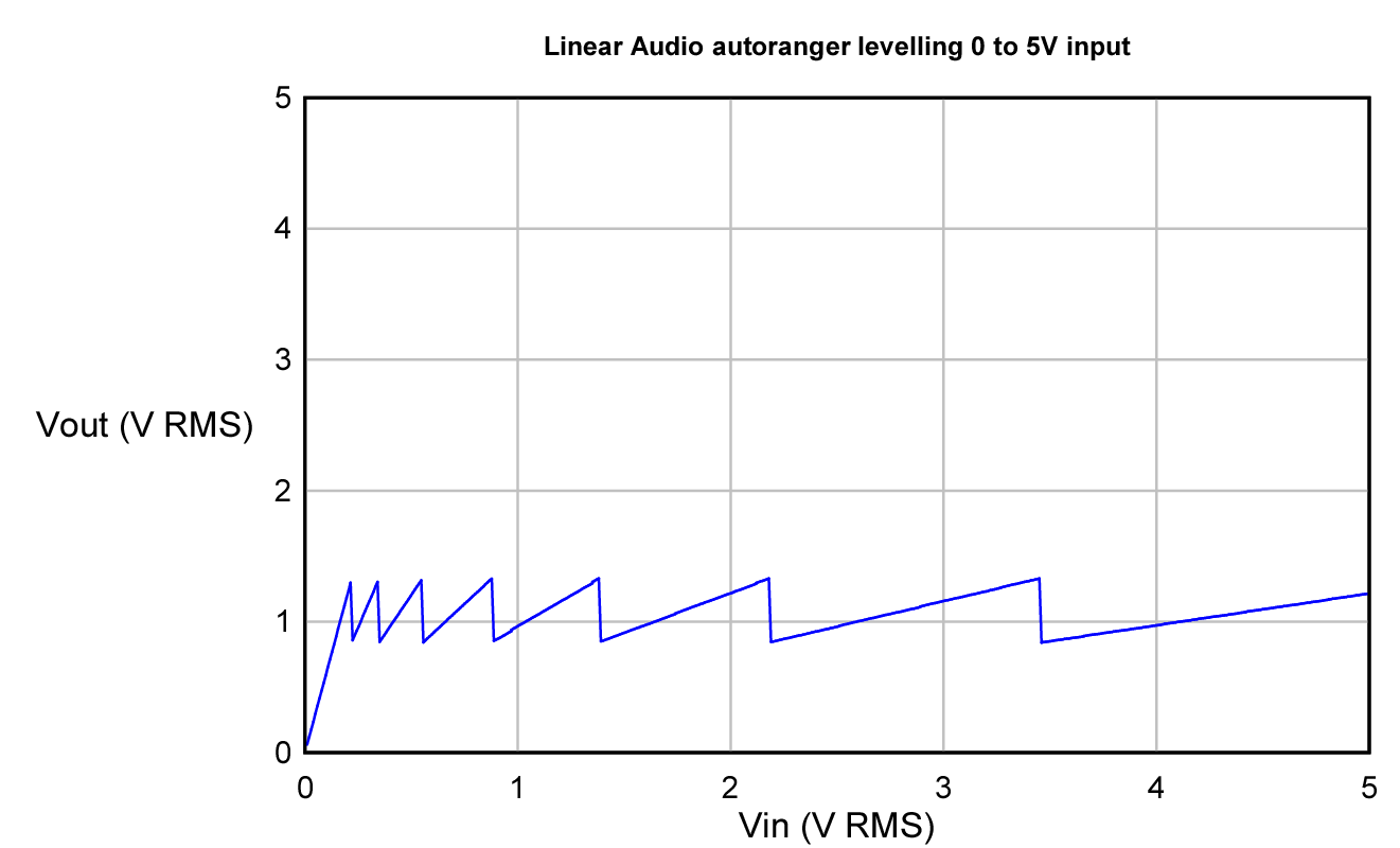

To wet your appetite, here is an input-output sweep of the autoranger with an input of 0 to 5V. and a sweep from 0 to 100V.

Nice.
What's the threshold 0.5V?
No, the overrange/underrage switching limits are like 1.3V and iirc 0.7V. It''s set in the firmware. I have one pin left for a jumper so could provide two ranges, jumper selected, in the final version.
Any ideas? Should be nominal +/- 30% or thereabouts.

How about using the pin to select between two different values of hysteresis? Zero hysteresis and 15% hysteresis, for example.
Then if the input amplitude wanders a few percent AND if, at the same time, it's right at a range switching boundary, the autorange won't oscillate.
