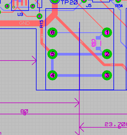

One question, as I intend to use the Auto Ranger with a Quantasylum QA40x, I could use a BNC as the single ended output of the AR instead of the Neutrik stereo jack? It is not clear. The hole size on the box is not a problem, the way it is connected instead is, I would use a panel mount and wire connections to the PCB - and in that case, an indication of what goes soldered where, would be great. And thank you Jan for all you help!!
Between (1) and (2), (2) being the BNC gnd. But isolate the BNC from the panel to avoid gnd loops!
Jan

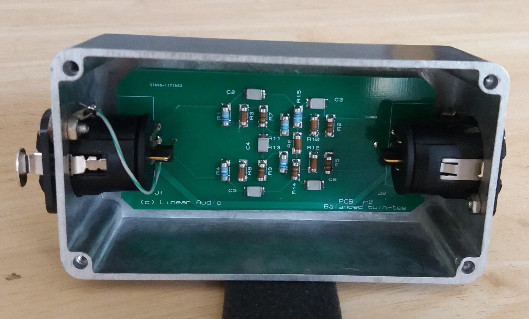

There a section on single ended and balanced twin T's around the Viktor thread.
Not my design but I designed a PCB for it based on Hammond case with all parts & connectors directly on the board.
It does not harm the performance.
Jan
Jan

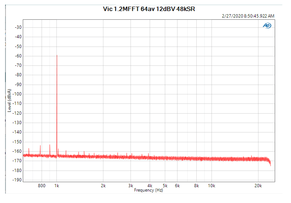

Example: Viktor's oscillator through balanced twin tee. Twin T has about 70dB attenuation at 1kHz. Clean output.
Jan
