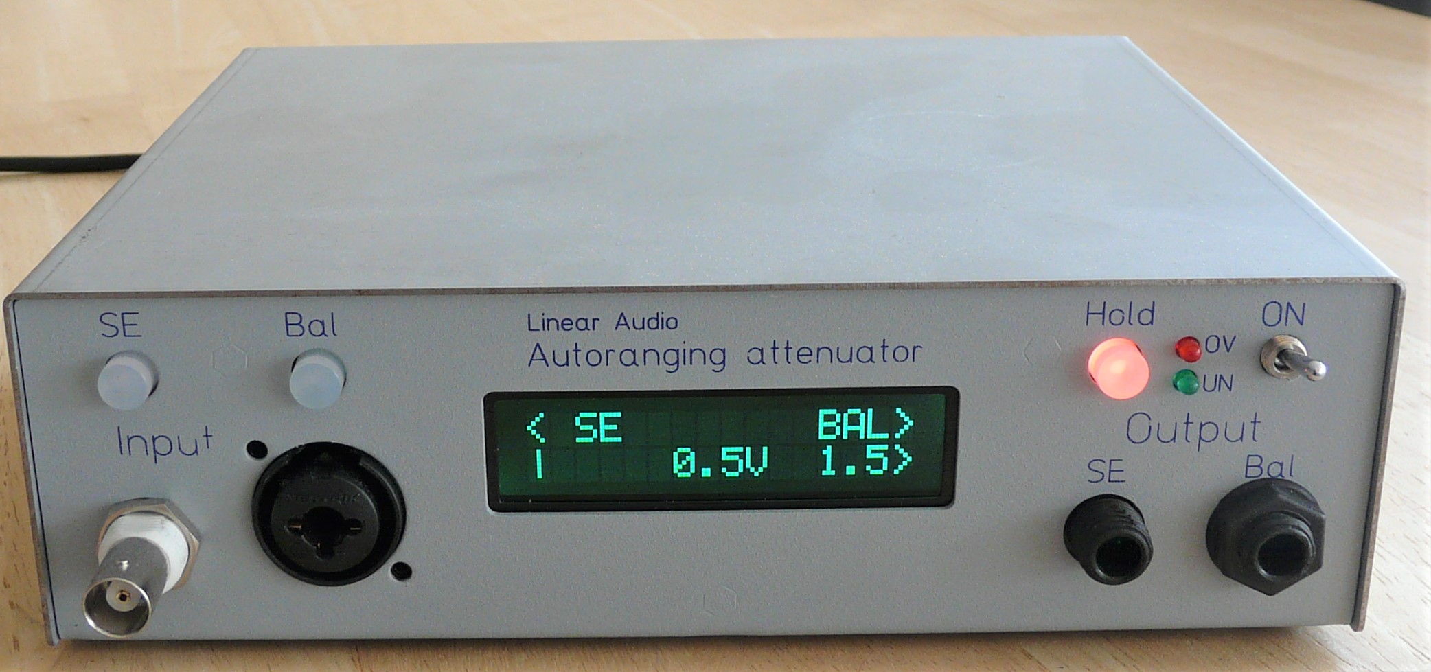

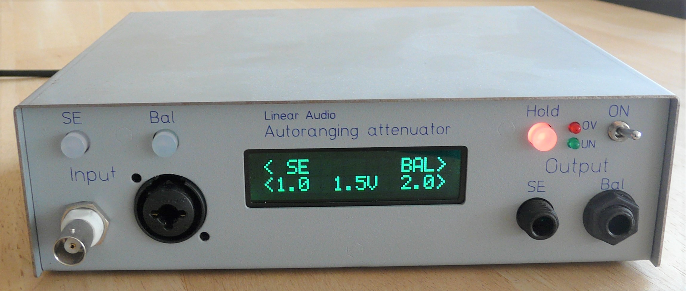

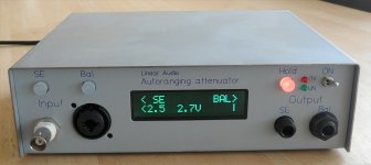

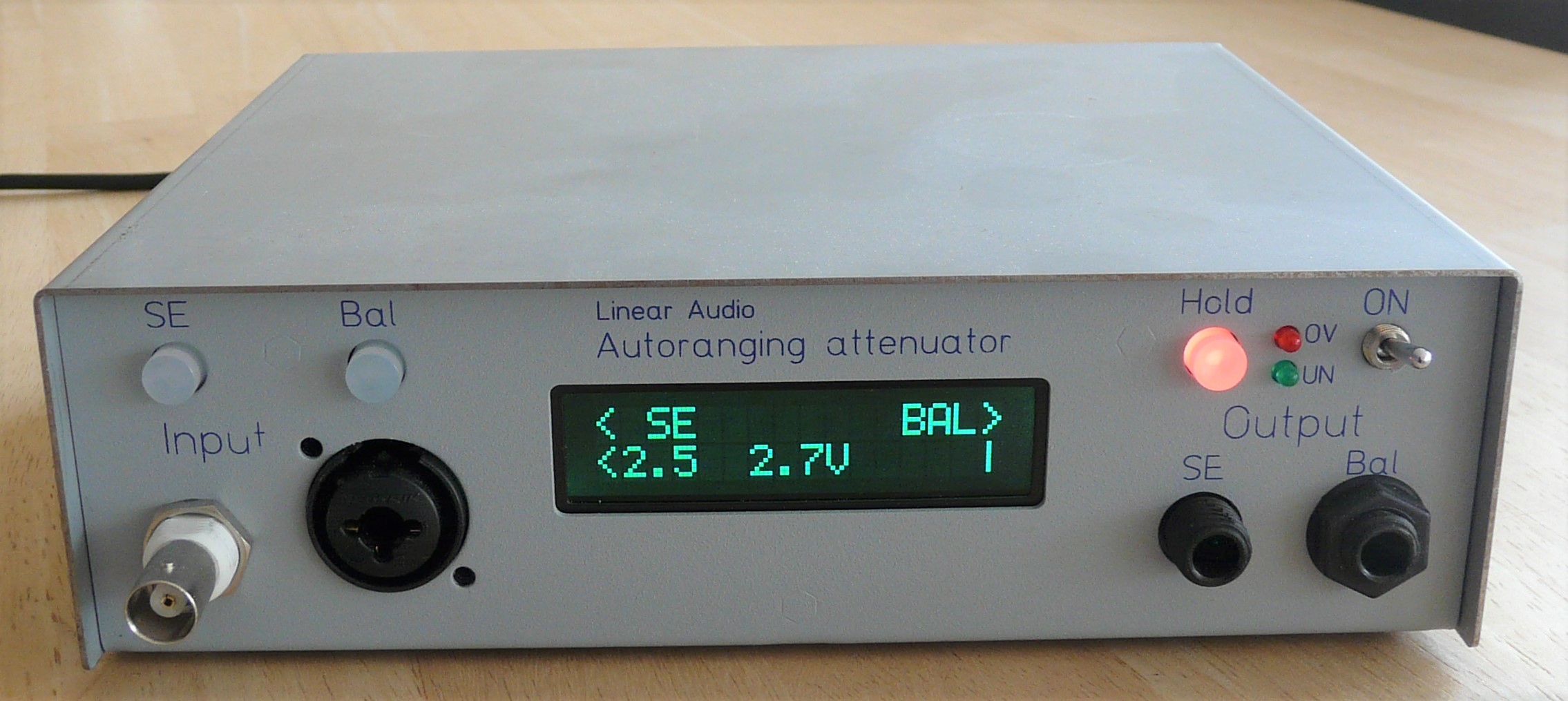

Several people have asked repeatedly for different nominal values than just 0.4V and 1.0V. I have updated the software to make it possible to select a value between 0.5V and 2.7V in 0.5V steps. The 2.7V is the max the existing hardware can handle.
The procedure is similar to selecting one of the values in the current software: switch on the AR while keeping the Hold button pressed.
For the new software (ARII-2-sel) you now get a menu, preset to 1.5V. Using the SE and Bal buttons you can step through the menu to select the value you want.
Attached are some pictures (I'm not a photographer as you can see ...). The 1st is the value set when you switch on with Hold depressed (1.5V). The next two show the max and min values that can be selected. Selections are kept when you switch off, until you set them to a new value.
For those of you who want the new version, I can send a new chip for € 10 including flat shipping.
