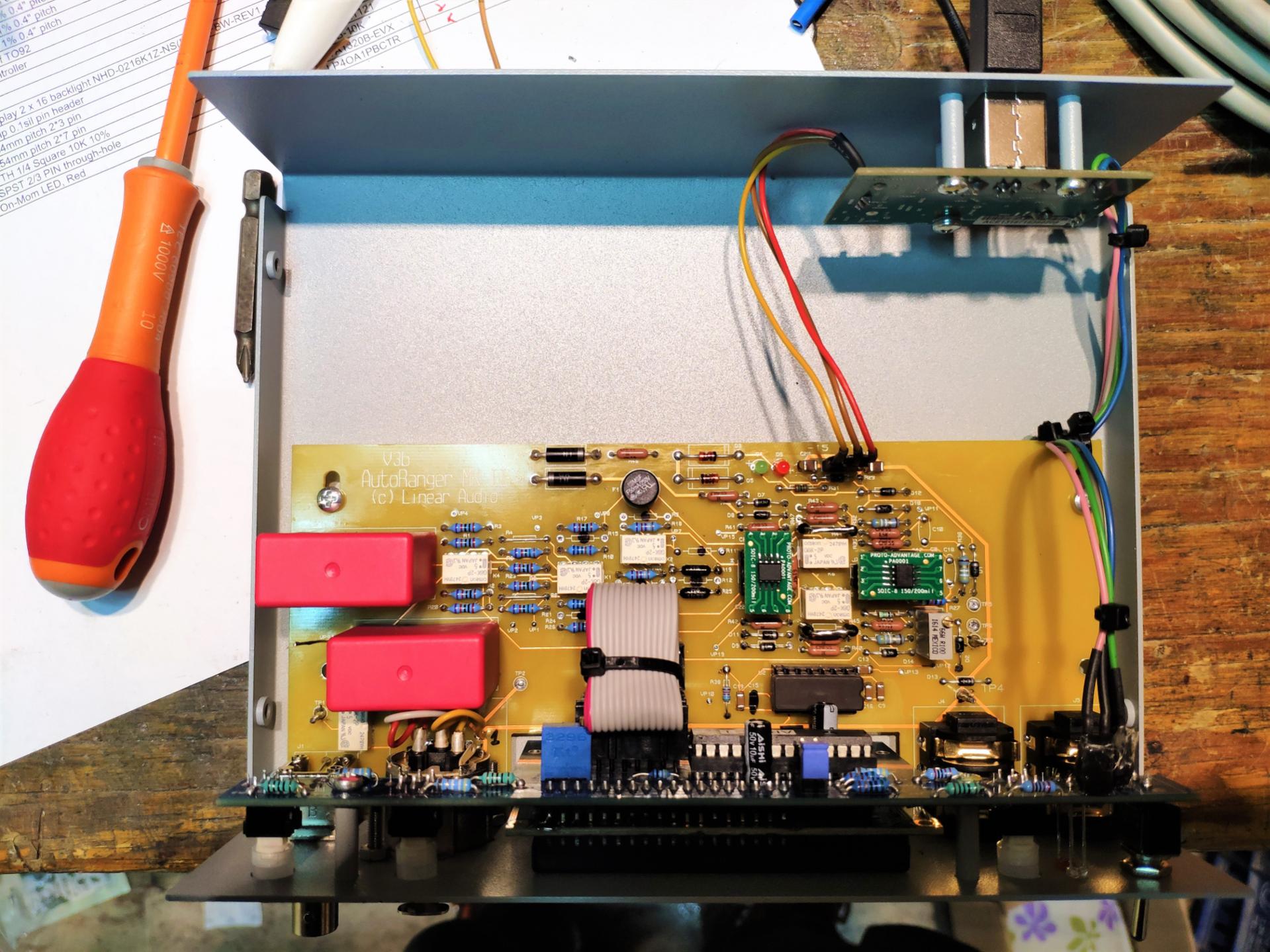

Unit complete
Hi everyone, a few days ago I finished assembling the MK2 Autoranger (20K ver.) I wanted to update everyone on the modification solutions in order to get the best performance from the interface, I modified the input capacitors (C4-C7) with WIMA MKP 4.7 uF to have a lower high pass cut.
The opamps I used are OPA1612 for double and OPA1611 for single, it is the best match I could have, I compared these opamps with LM4562, OPA2134, NE5532 and LME49860, in the single opamp I had only NE5534 as a comparison, the OPA1612 is a strange beast, if not properly compensated it gives catastrophic performance, inserting the capacitors C21-C22 (47pF) is the best of the lot, instead the OPA1611 using C17 (22 pF) turns out to be better than the NE5534.
By running a loopback to the system (0 db setting) I got almost -110db THD and almost -106 THD+N (1Khz tone, on modded ASUS STX mk1, REW and ARTA same results).
Instead I noticed a strange thing , the potentiometer for adjusting the CMRR has no effect, in any position my reading in mV rms remains the same and always below 0.2 mv rms.

Nice work!
What IC SMT adapter boards did you use? Are they socketed? If so, what DIP-8 sockets did you use?

Thanks Bob, I purchased the adapters from mouser, I have to say quite expensive, but good quality PCBs, the Chinese ones melt just looking at them, the kit arrives disassembled, it must be assembled later, reference code: 910-PA0001
