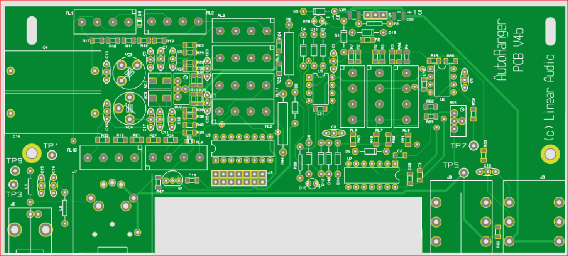

OK, here's the situation at this moment. I have collected all your comments and suggestions, especially from Demain (thanks Demian) on the output levels.
I have just submitted what I hope will be my last prototype to Eurocircuits (see attached).
I have modified the switching logic so that now the maximum attenuation is -48dB. There will be two software-controlled settings for the nominal output levels to the soundcard input: 1V (0dBV) and -8dBV (which is around 400mV).
That means that with the maximum input level of 100VRMS, the output to the sound card will be either 1VRMS or 0.4VRMS. The software in the controller will be updated so the setting can be changed from the front panel, no need to open the box to change a jumper.
I also increased the input coupling to lower the LF -3dB frequency from 5Hz to below 2Hz.
The other thing, strictly software, will be some improvements to the Vout level display but that has no hardware implications.
I'll keep you updated, as usual. My plan is to start a Kickstarter before the summer, and offer a half-kit (all PCBs with SMD fitted, the box, the SilentSwitcher supply and programmed controller) where you only have to fit the through-hole components and put the assembly together. Of course I will supply a full detailed BoM.

Hi Jan,
Your autoranger looks like a nice solution. But, why DIP for op-amps and not SOIC?
Btw, SOIC>DIP adapters looks so ugly...

I believe it would be much more expensive. There are a lot of unusual value 0.1% resistors which are relatively expensive in singles or duos. For say 100 pieces that is much different.
Jan
Hi Jan,
Many DIYers still prefer DIPs where the device is available in DIP and space is not an issue. Working with SOIC is a pain for most DIYers, including myself. Jan is wise to include SMC for resistors, etc., as long as he provides them pre-mounted on the PCB.
Bob
Bob
Hi Bob,
I can understand your point. But, for ultimate performance I believe that we have to adopt SMD where SOIC is the least challenging dual op-amp form factor.
Btw, SMD op-amps can be pre-mounted too.
Regards/ Anders

However the OPA1622 may be a good choice and they are really DIY hostile. We will see more of this impossible for human packages in the latest generation of parts since the market is cell phones.
If there is a DIL socket, anything can be used with an adapter and there's always people who want to try different opamps! Go to SOIC or smaller and you're stuck.
Jan
