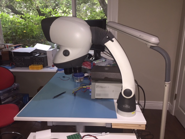

Woo hoo! I won this eBay auction and purchased a used Mantis Elite microscope for $1236; they sell for $4100 new. Dave Jones of Eevblog has one and he likes it very much. Dave says it's the perfect thing for SMD soldering and rework.
Here is a photo; you can see that I bolted it to my super inexpensive white lab bench from Ikea, with two thicknesses of 3/4" plywood underneath, for greater rigidity. The blue stuff is an antistatic mat.

Those are great. I'll need to wait until I find one at a fire sale since my limit for this stuff is $300. I'm using one of these for now: American Optical AO Spencer Stereo Binocular Microscope Complete 10X Eye Pieces | eBay Accessories are pretty cheap on ebay as well.
