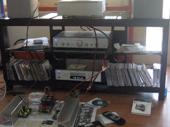

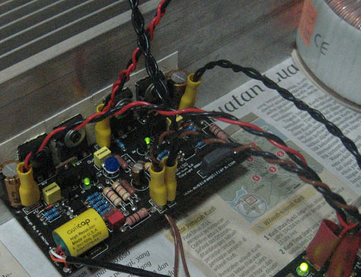

Dear Mr. Holton,
Please Help me,
I've a pair of NX150 Synergy and PSU Three, I used :
- 500VA 2 x 40V Toroidal Transformer
- 6 x 12.000 uf/63V
I tested PSU Three and i have 56 V/Rail and then I put 10R 5W across each fuse, I adjust P1 clockwise until i get 0 ohm and I fired up my NX150 Synergy and I turn P1 until i get 1 volts BUT when i checked output stage my multimeter give me 36V
... and IRF9610 is getting very hot. I checked everything and looks fine.
Please..... give me some advise what should I do.
Many.... Many.... Thanks in advance
Regards
Jopie
Please Help me,
- 6 x 12.000 uf/63V
Regards
Jopie
Hi Jopie
OK, first adjust the trim pot back to zero and turn the amplifier
back on.
Now measure each 1 watt Zener ZD1 and ZD2 for around 14.5-15.5 volts
There are 2 on board, one next to the IRF9610 and one next to the IRF610
If one of the zeners is showing almost zero volts then replace this zener.
If these measure OK then measure across the Gate / Source pins of each IRFD110 and IRFD9110 devices Q1, Q2, Q3, Q4.
These will vari a bit from around 3 volts to 3.5 volts each.
It is possible you might have a input Fet that is current hogging
and will need to be replaced.
Please get back to me ASAP with what you have found and I will advise you further. 🙂

I should also note for help for any one, NEVER connect a speaker when doing this, that will cause a big load. Never connect one till the amp is runing perfectly and no dc offset, ( or very minimal 🙂
Thanks Mr. Holton,
After I measure and this is the result :
- ZD1 and ZD2 are 14.9 V
- Q4 pin1 and pin2 are 3.2V
- Q2 pin1 and pin2 are 3.3V
- Q3 pin1 and 2 are 5.4V
- Q1 pin 1 and pin 2 are 5.3V
Should I change Q1 and Q3?

Hi Jopie
Ok can you do some more measurements for me.
What is the voltage drop across R21, 22, 23, 24?
Also R10 and R13?
They may be some problem with one of the current sources
most likely Q6 and Q7 need some further investigation.
Anyway if you can get back to me with those measurements that would be great.

Dear Mr Holton,
I change transistor in Q6 and.... everything work fine! DC output stage only 7mV amazing!
My wonderful NX150 Synergy is ALIVE now.. and I very happy with this.
- Thanks to my Lord, because You give me a change to have this wonderful power amps.
- Thank you very much Mr. Holton for your support.
- Thanks to my friend Bonie Bong for your help
- and Thanks to you Jeff.... I remember when you push me so hard to try this...ha..ha..
Can you beat my power amps Jeff? ha...ha....
To everyone want to build power amps, I'm strongly... strongly... recommended NX150 Synergy to try, you will not disappointed.
Jeff, can i post my NX150 into your thread? maybe your thread should be official thread NX150.🙂
