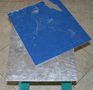

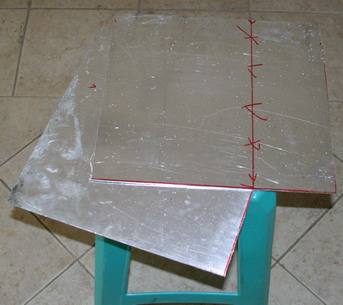

Wrong measurement
At the first time i plan to use 02 mm for up & bottom
but i make mistake in measurement so i can use this
( Minus / do not include top side of heatsink )
But its ok i can use this in other project letter 😀
Wrong Measurement Again ???
After my friend make some picture about casing
and replacement for all member of amplifier
i found that my new up & bottom is minus 20mm
Grrr Blarrr Grrr ... Bang ... Bang ... Bang :hot:
But its ok i can use this in other project letter 😡
(This realy ... realy emptying my saving )

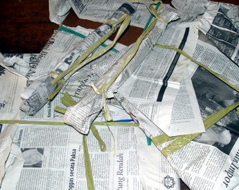

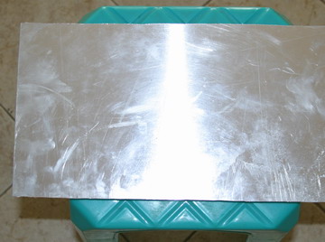

All the plate i have are full with scratch
No one look a normal plate
this will add my job :xeye:
For make them all in one unit include heatsink
i use solid stainless stell, this is raw material
I must buy another Bottom & Up plate again
the market place was terrible traffic jam :bawling:

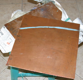

Copper Plate
So i buy the copper plate for 36 x 35 mm
The cooper condition is the worst from
the other and the price was bad (US$ 45)
When i buy this copper plate i forgot something
Yes i forgot to buy the alumunium for up plate
I must go there once again :bawling:

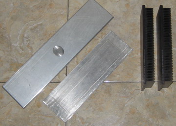

Start work for the casing
Hii
After all my office finish so i start to work
my front plate, back plate and heatsink.
:smash:
There a little mistake on the front plate
so i will "drilling" it again, make it perfect
:hot:

This is my front plate, backplate and heatsink
this casing i use for my Prototype I Amplifier
I use secondhand heatsink, not use condrad
if some works fail so i can put it on trash can

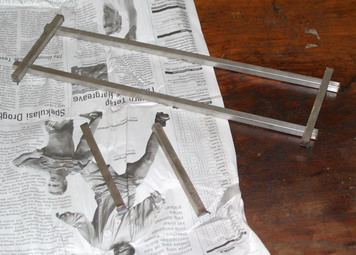

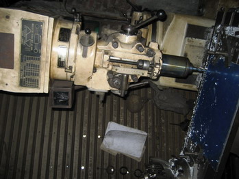

This is my “Up Plate” in the spindle machine
I don’t have the spindle machine myself so
I take all the part of casing to the workshop :hot:
This picture caught when they make it to real square
They cut the size maybe 10mm in every side
Hmmm Looks the professional audio shape now 😀
