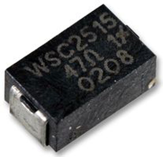

Or with some vishay smd
they are expensive too
