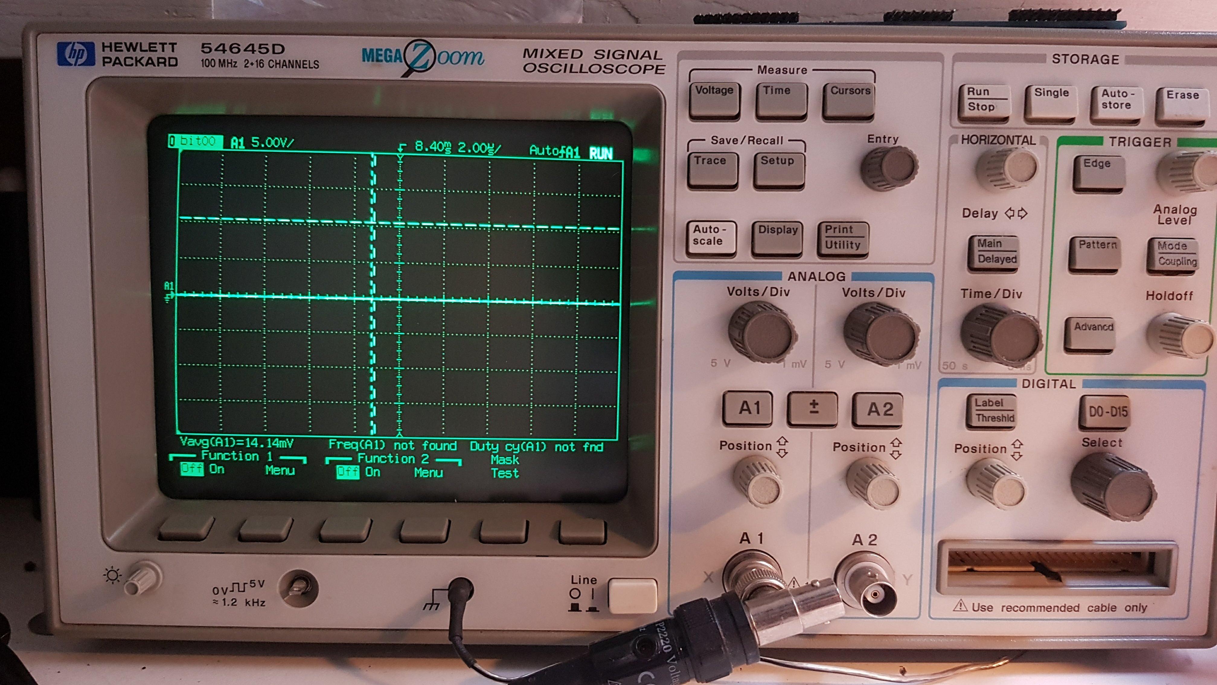

On the photo 1 you see the result of pressing button A1 or A2 (Ch1 and Ch2).
Pressing on that button makes it possible to change the coupling, inverting etc.

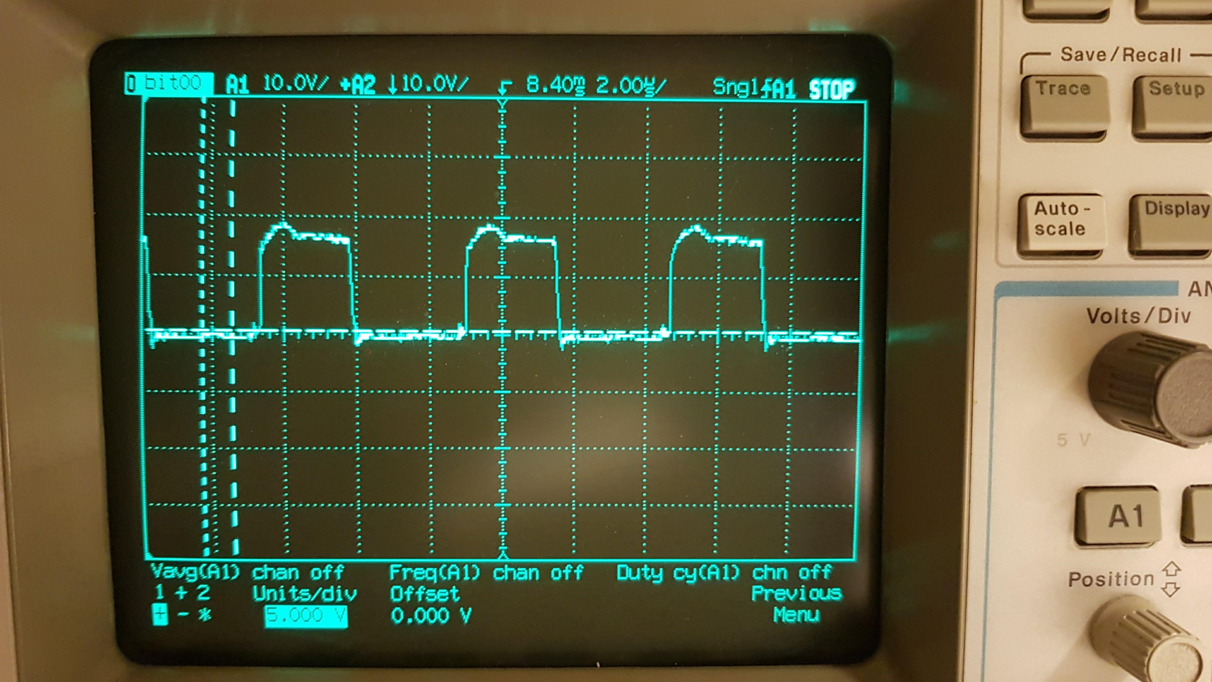

On photo 2 you see pressing the button +-

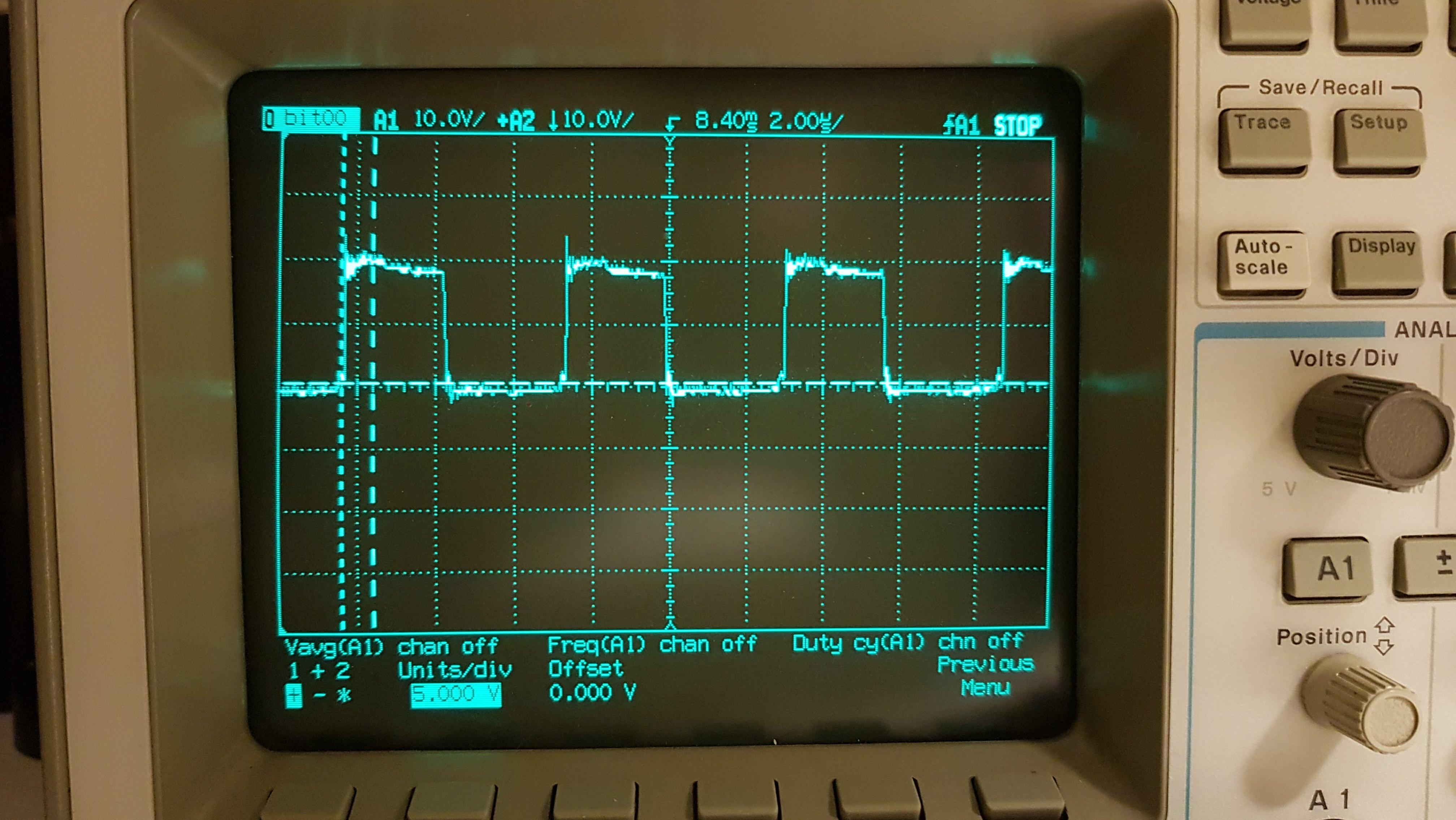

On Photo 3 you see clicking on function menu 1

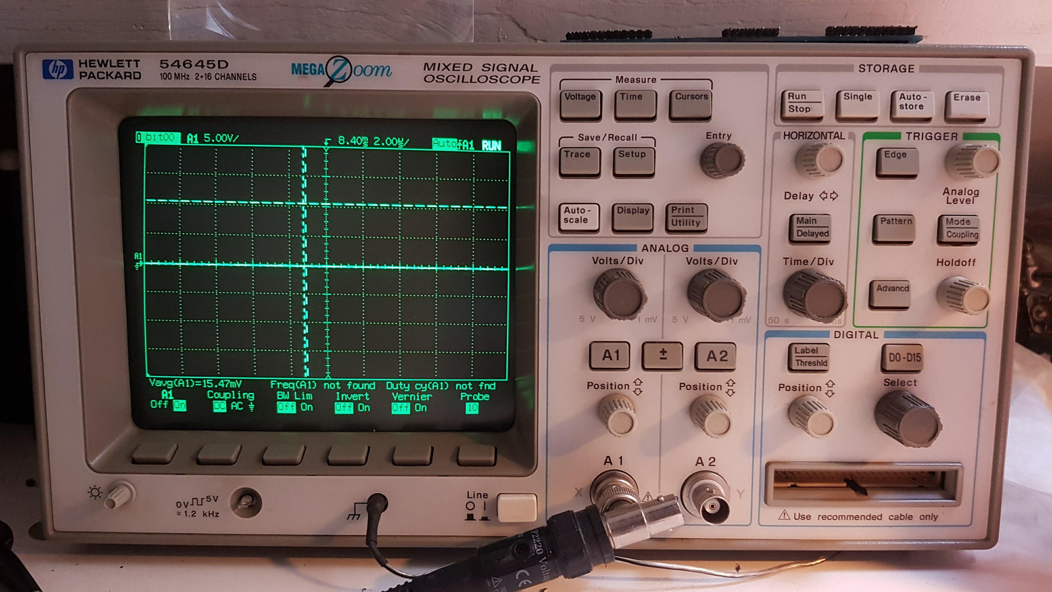

On photo 4 you see clicking on function menu 2

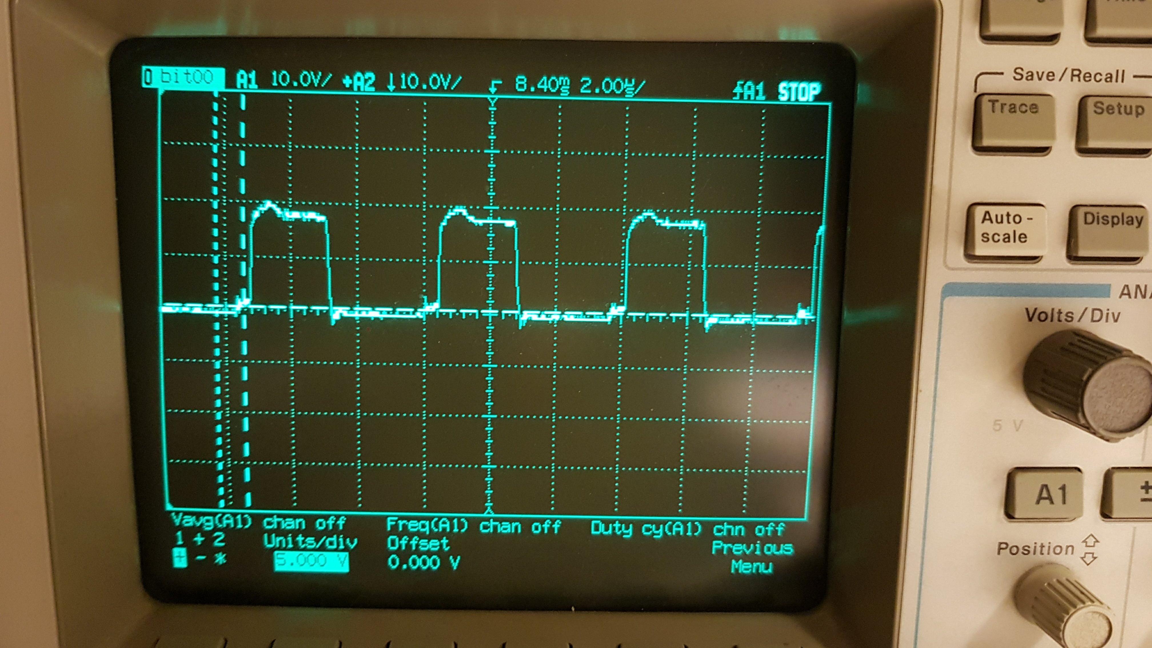

For image 1, switch to ch2, DC coupling, inverted, 5v/div and probe on the 12v PS positive terminal.

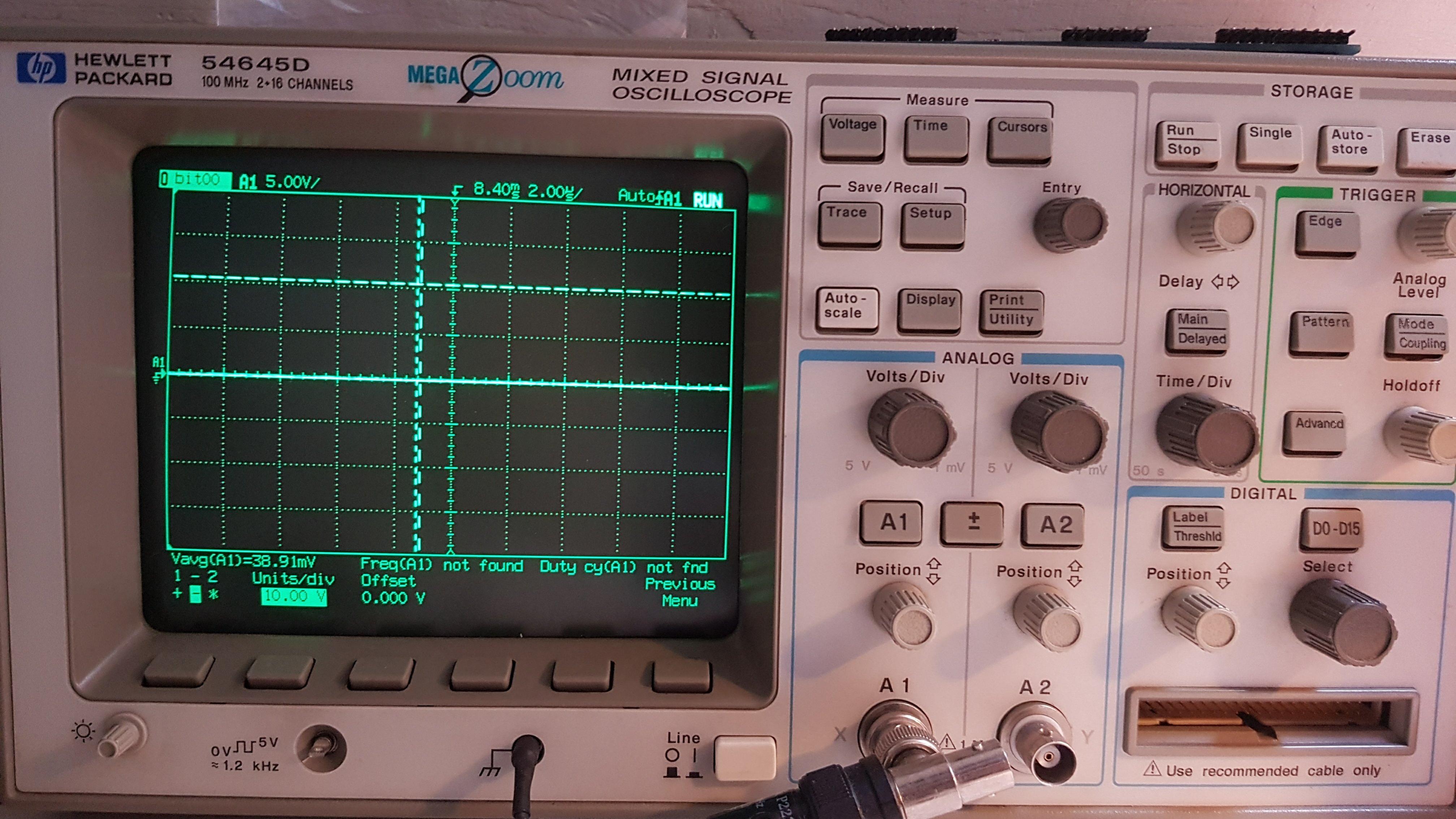

Took some time, but I found how to measure differential.
What excactly would you like me to measure?
I found out some more information. When starting up with a floating power supply on high-side HCPL3180 Pin5 and Pin8 it works perfectly, also after disconnecting the floating power supply while operating it works perfectly.
It seems like it only has problems when starting up without a floating 15v supply.
Without the 15v supply, what does the signal look like across pins 5 and 6 of the high-side optocoupler?
With or without output fets?
With output fets installed and without 15v supply it has a very high current draw on the high side output fets and a hard to trigger signal. Hard to measure precisely.
Without the extra supply.

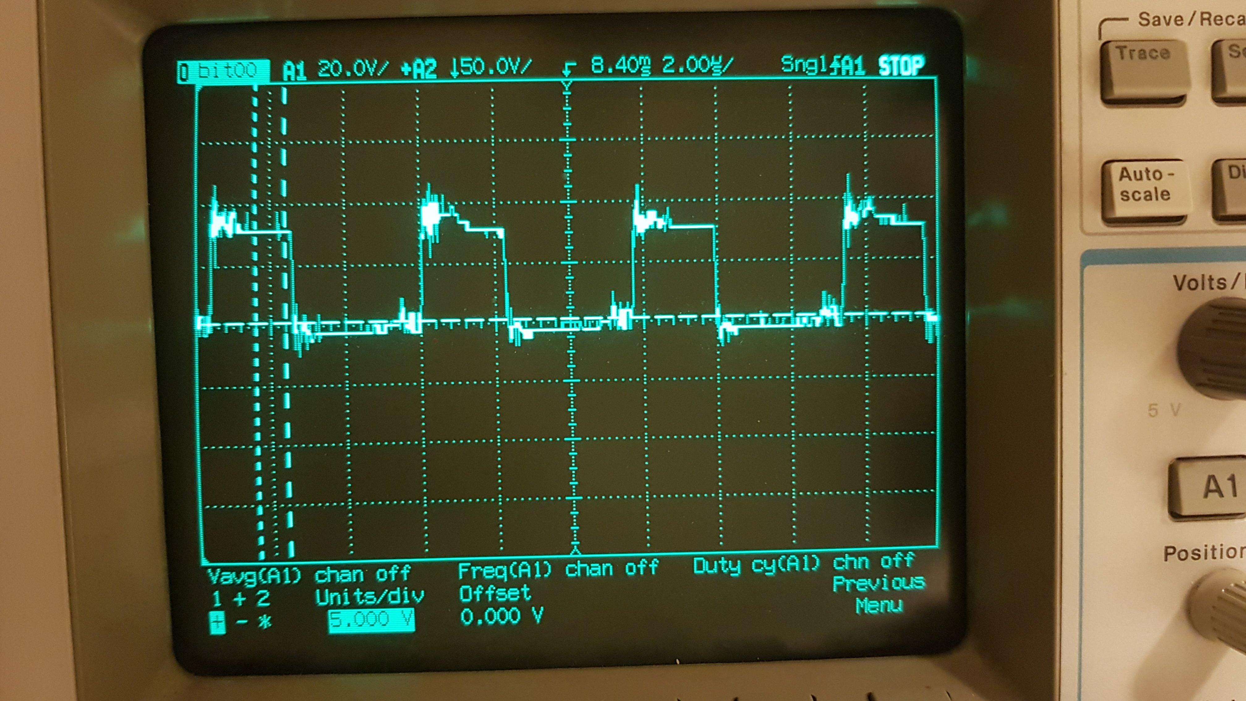

Set everything up and power up just long enough to get a photo of the waveform before anything overheats.
The two channels need to be on the same vertical amp setting. 10v/div should be enough to prevent the waveform from going off of the display.
Make the same readings on the bases of the drivers and on the emitters of the drivers. Place ch2's probe on the source leg of the high-side FETs for both tests.
Those look OK.
With the ch2 probe on the FET source again. post the waveform on the gate leg of the high-side FET. Confirm that both are the same.
