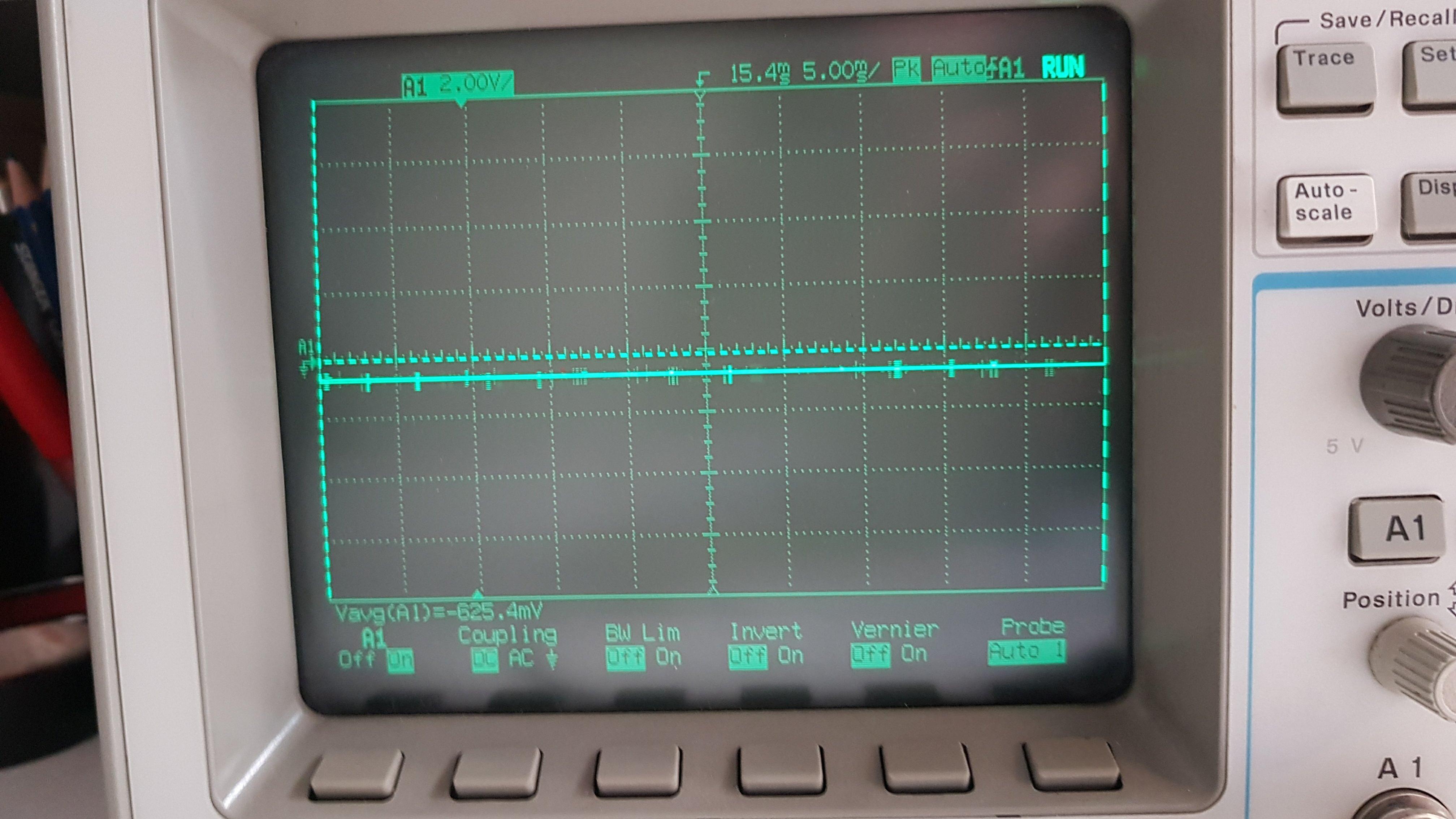

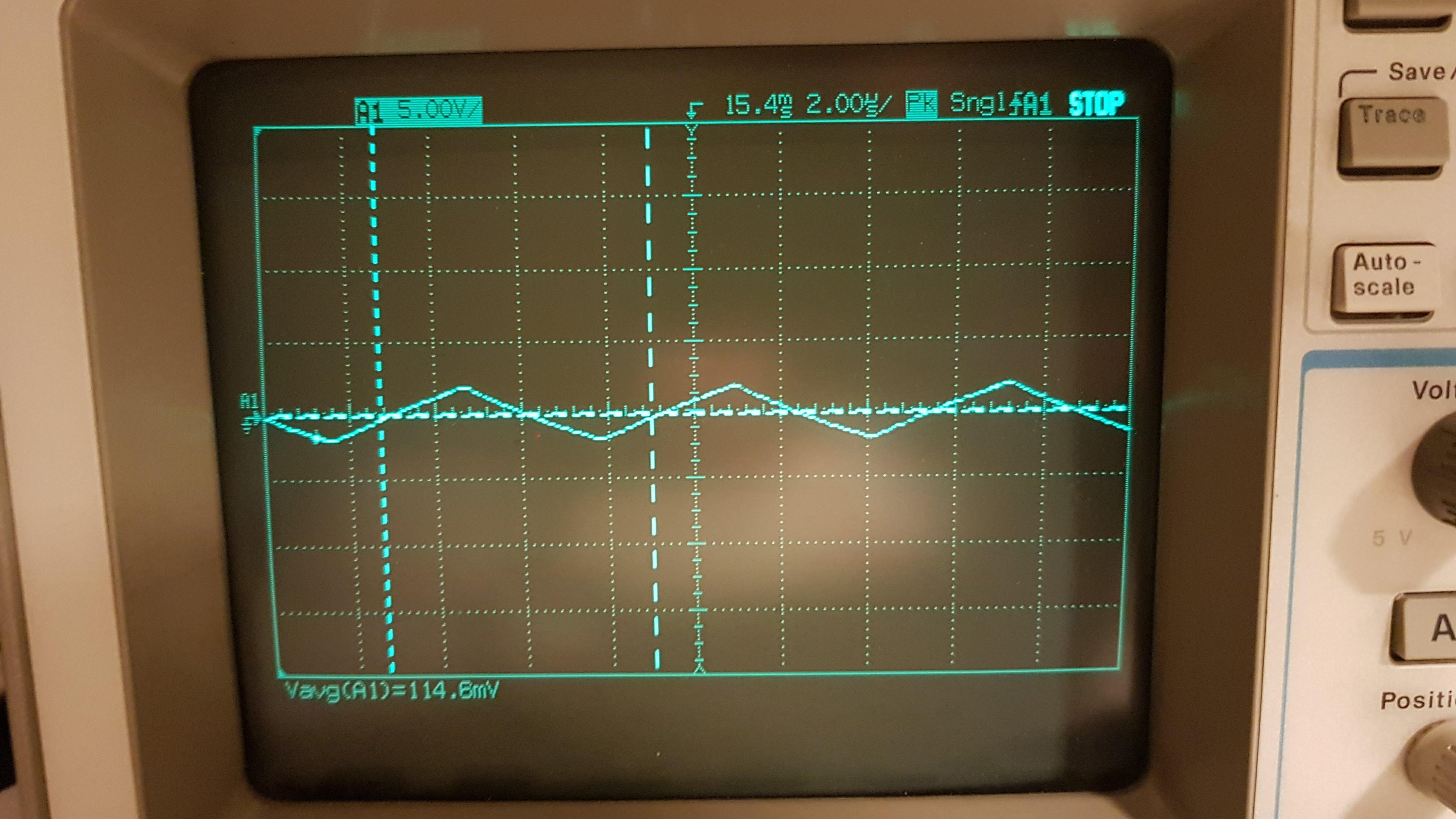

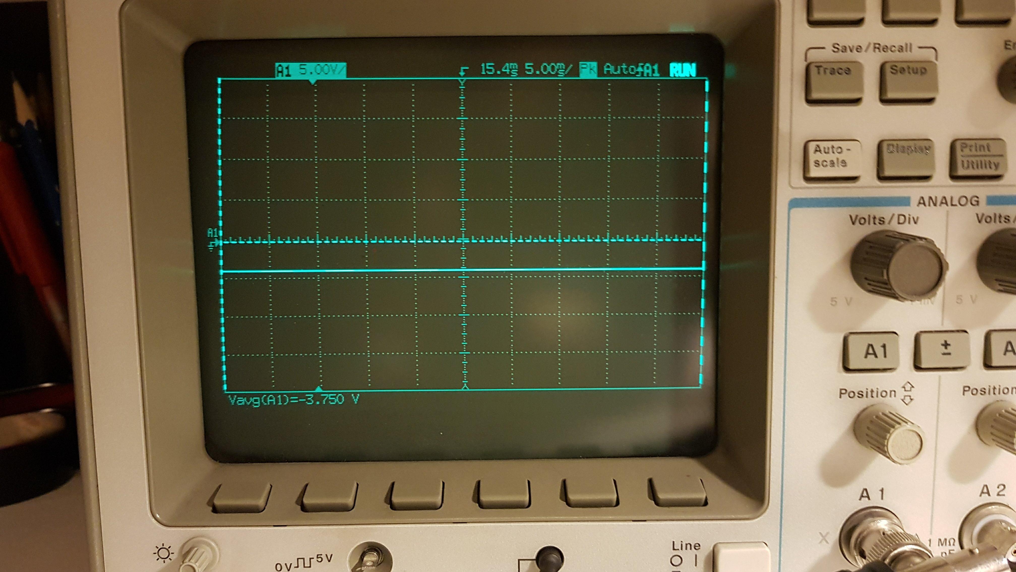

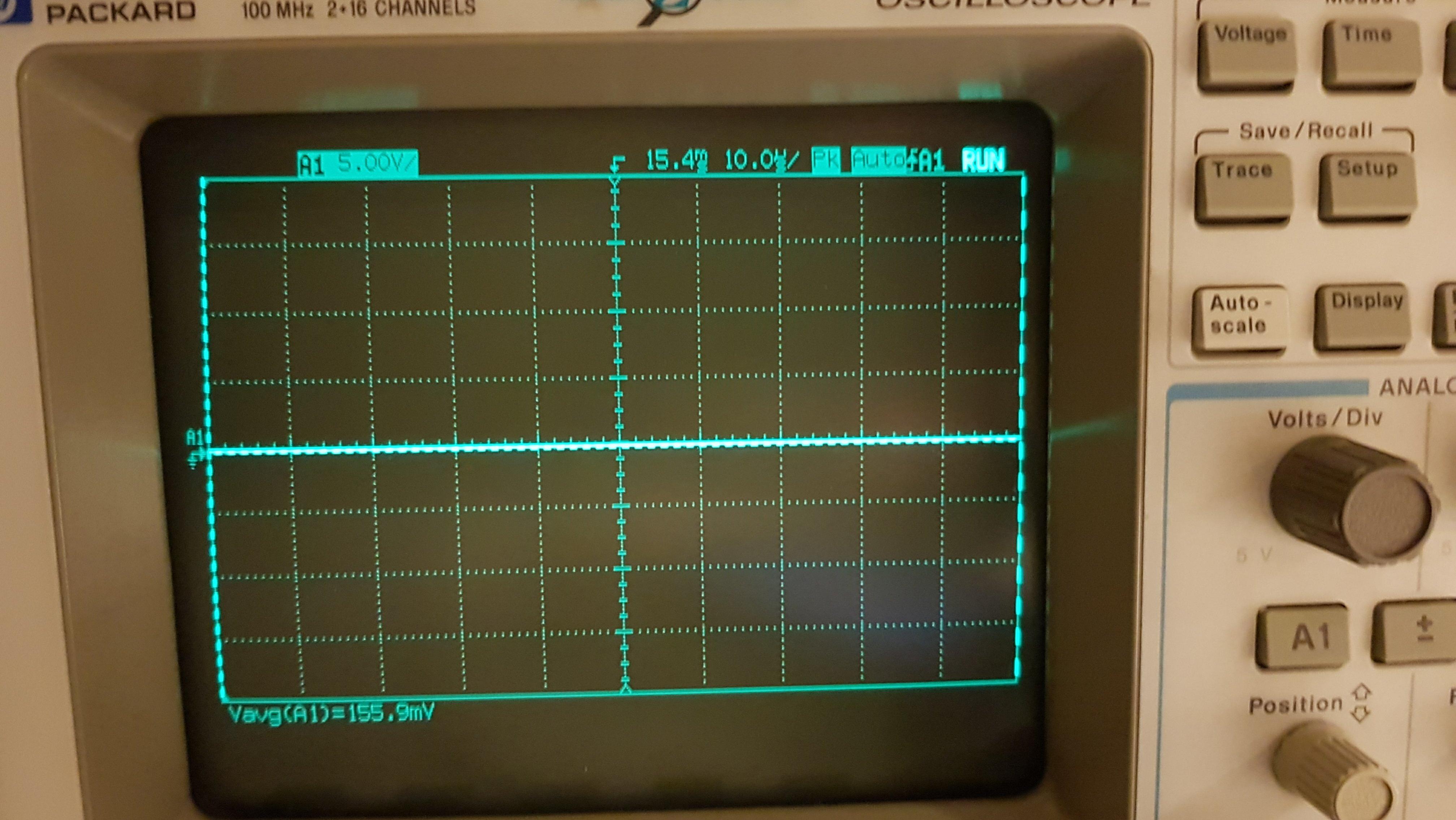

There is no signal, just a -DC voltage (probes in 10x)
On LM319 Pin12 -625mv
On the input via from the driver board 100mV
Post the signals on pins 4 and 5 of the 319 with DC coupling. set the scope to 5v/div and whatever timebase it takes to display about 3 complete cycles on the display.
There are no drives/cycles without RCA signal, only on Pin5.
Photo 1 Pin12
Photo 2 Pin4
Photo 3 Pin5
Photo 1 Pin12
Photo 2 Pin4
Photo 3 Pin5
It appears that there is something that's causing the voltage on pin 5 to have offset. I've run it through a simulator. Compare the waveforms to your amp. Do you see significant offset on any other terminals?

I was probing around to seek for DC offset causings, but Pin5 seems to be very healthy, nothing has strange readings and it seems to function properly.
I found out the secondary GND is at 4.6v referenced to PS GND.
LM319 Pin5 reads close to 0V when I DC measure with my multimeter between secondary GND and LM319 Pin5.
Should I solder my oscilloscopes reference GND to secondary GND and make new photo's?

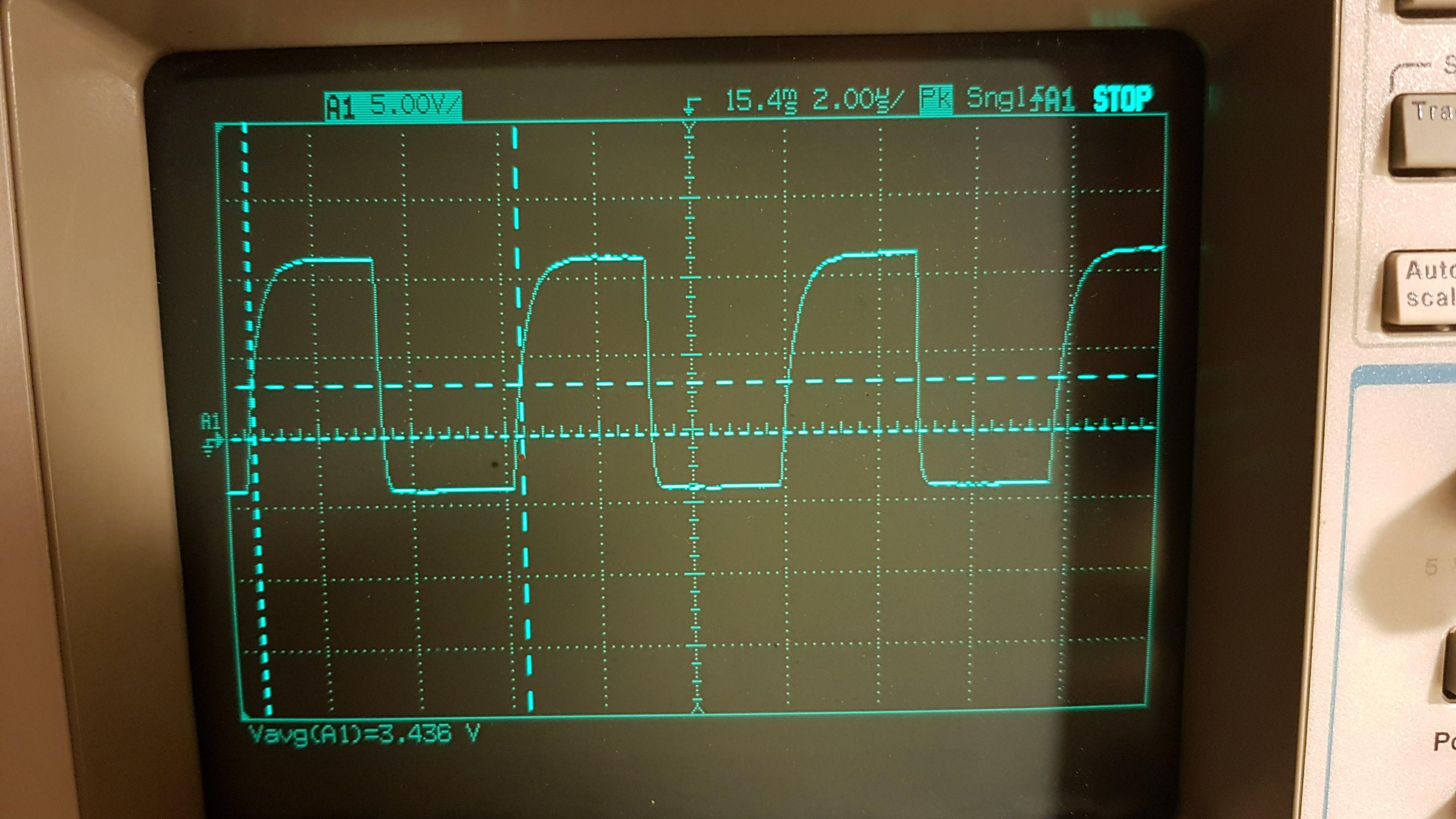

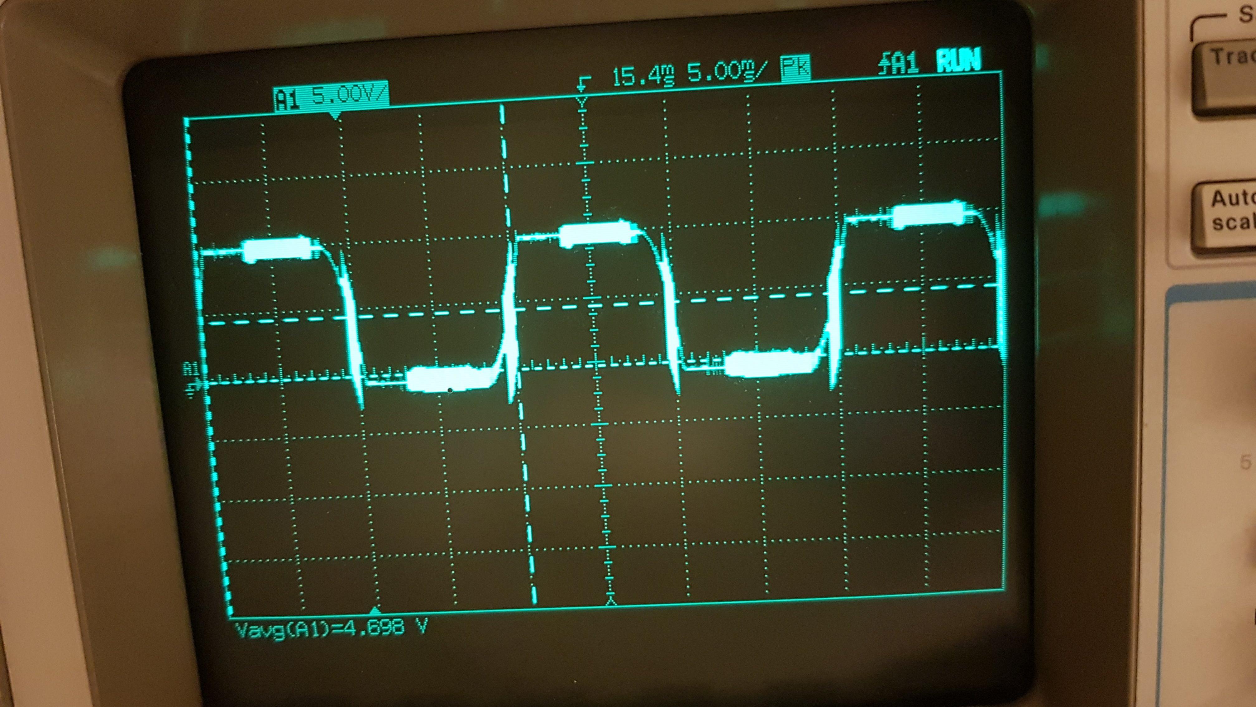

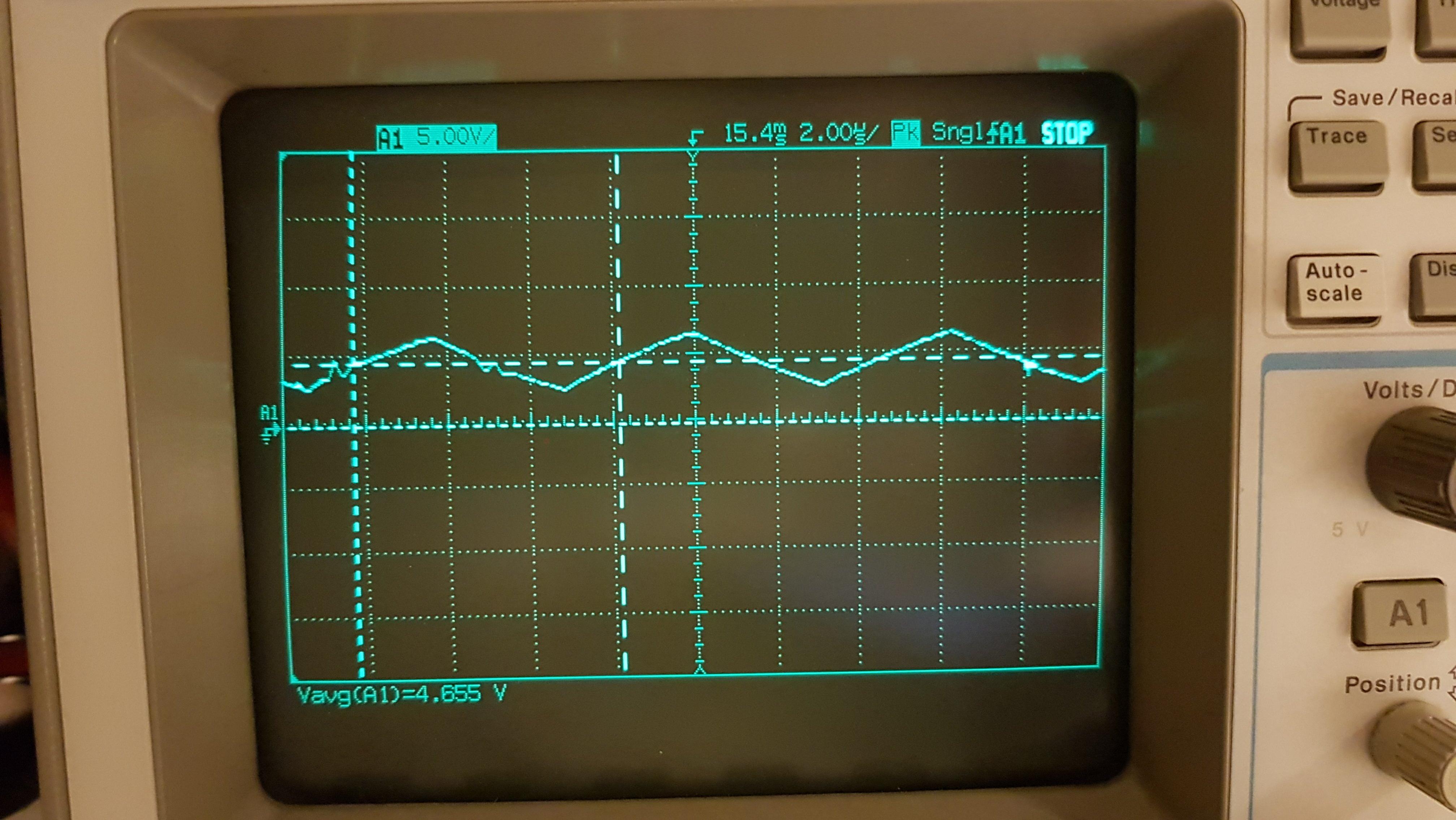

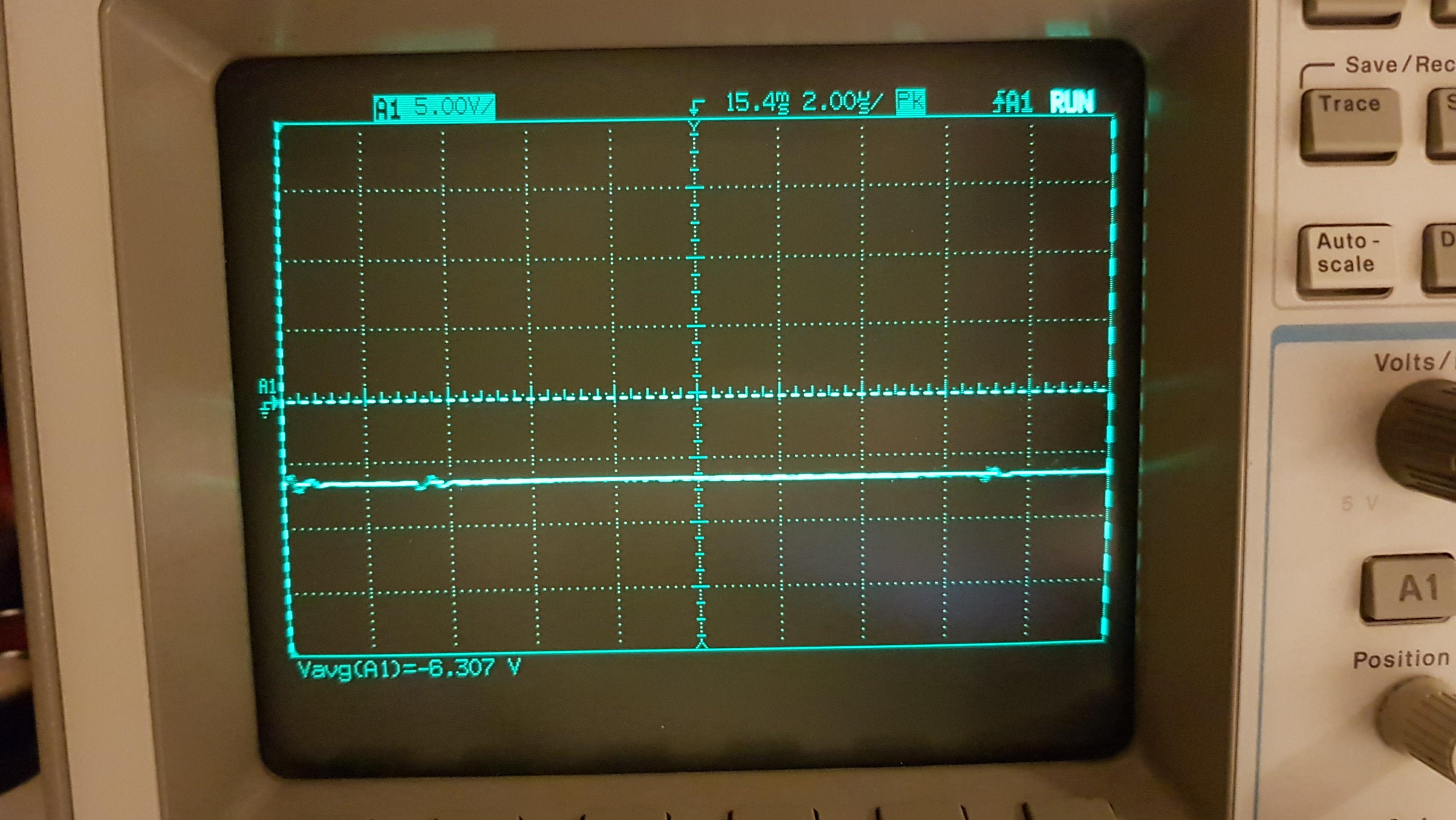

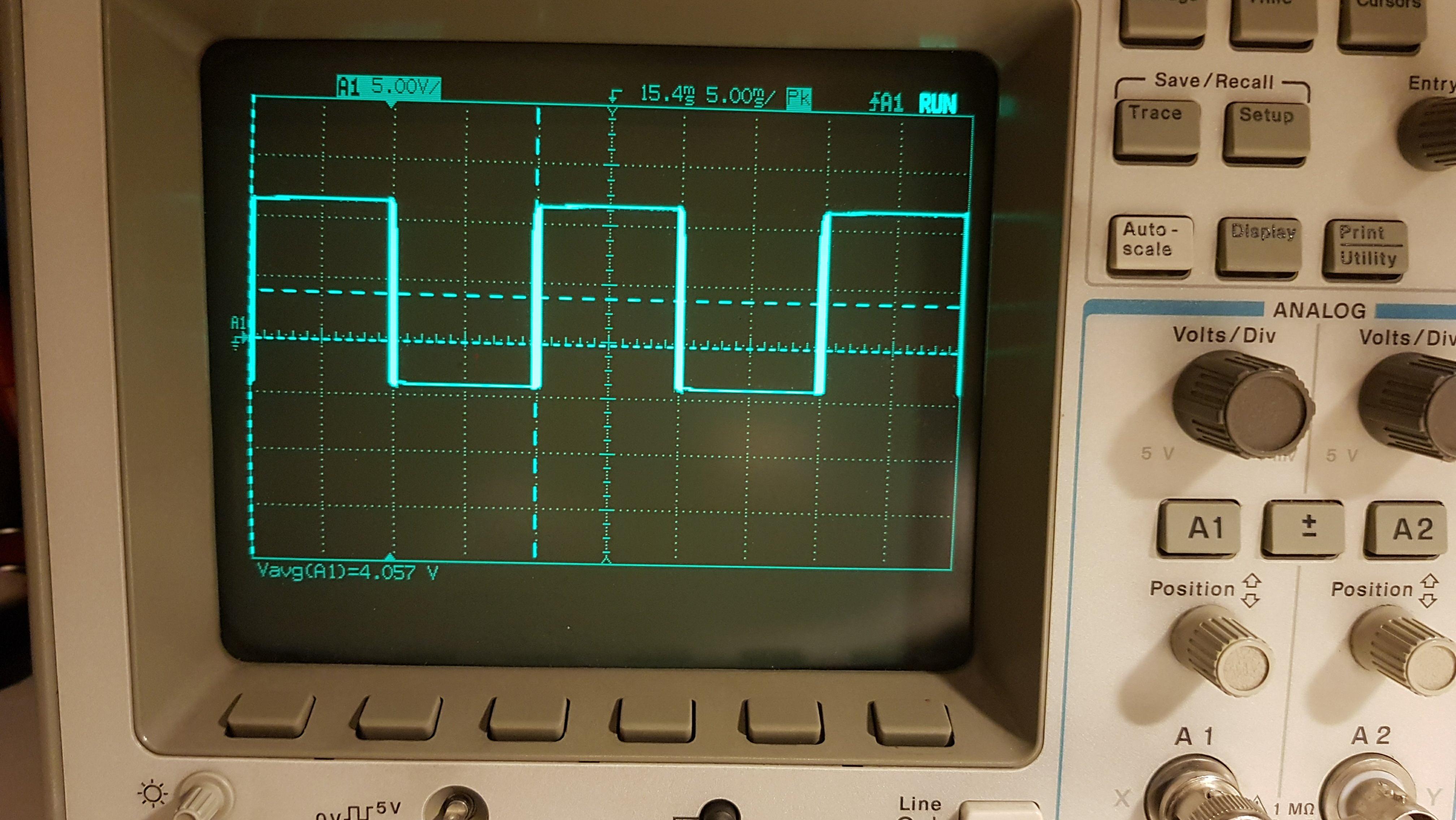

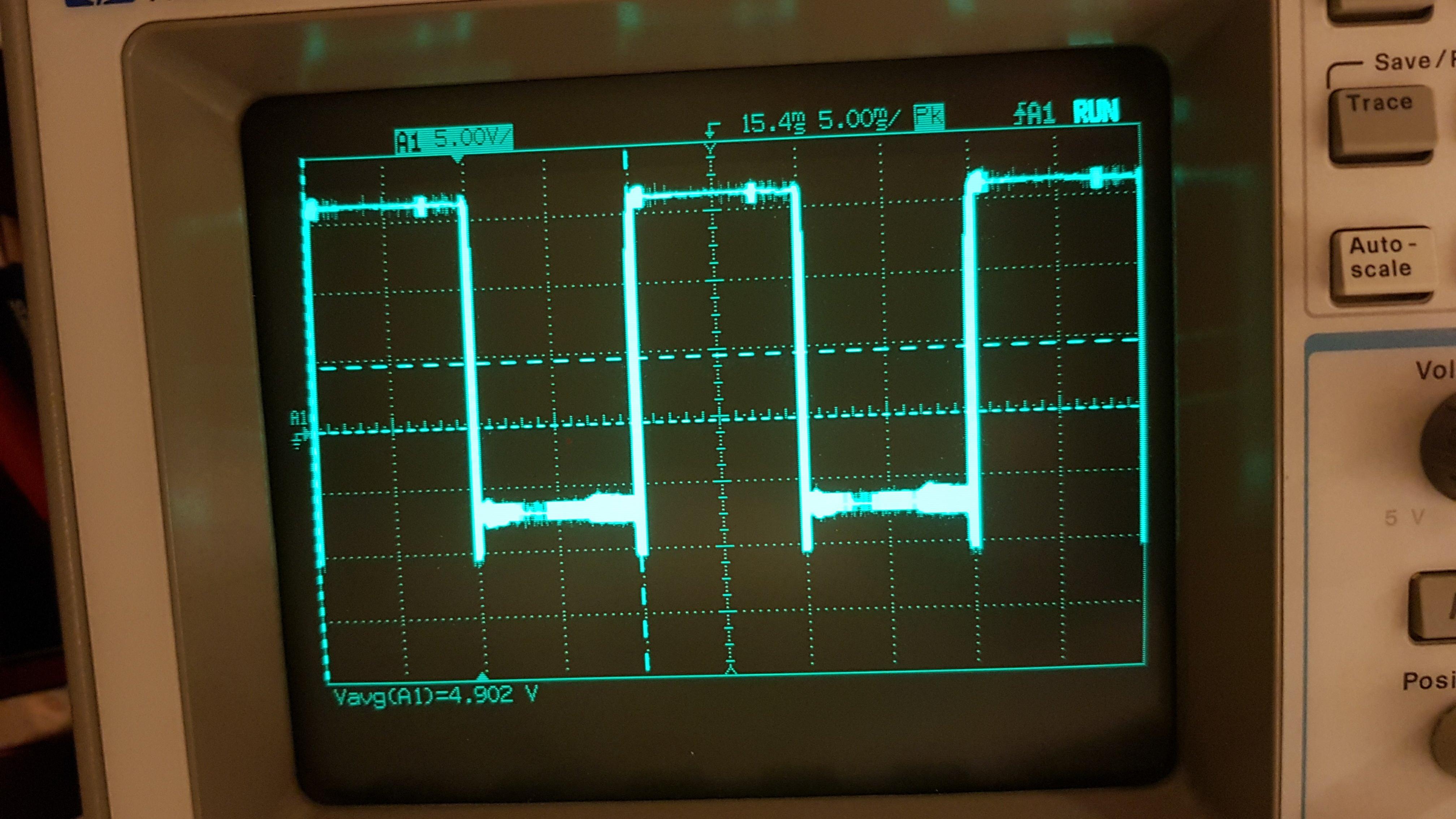

I referenced the scope to secondary GND.
Photo 1 is Pin5 with signal
Photo 2 is Pin4 with signal
Photo 3 is Pin12 with signal
Photo 4 is Pin5 without signal
Photo 5 is Pin4 without signal
Photo 6 is Pin12 without signal
This seems to make more sense, and doesn't look too bad I suppose. Pin12 is pulled down to -VCC without signal, and has a clean square wave with DC right at GND.
The optocouplers from the driver board were OK, the SMBTA92 driver transistor on the driver board has been changed after the crash.
Resistors have been checked.
