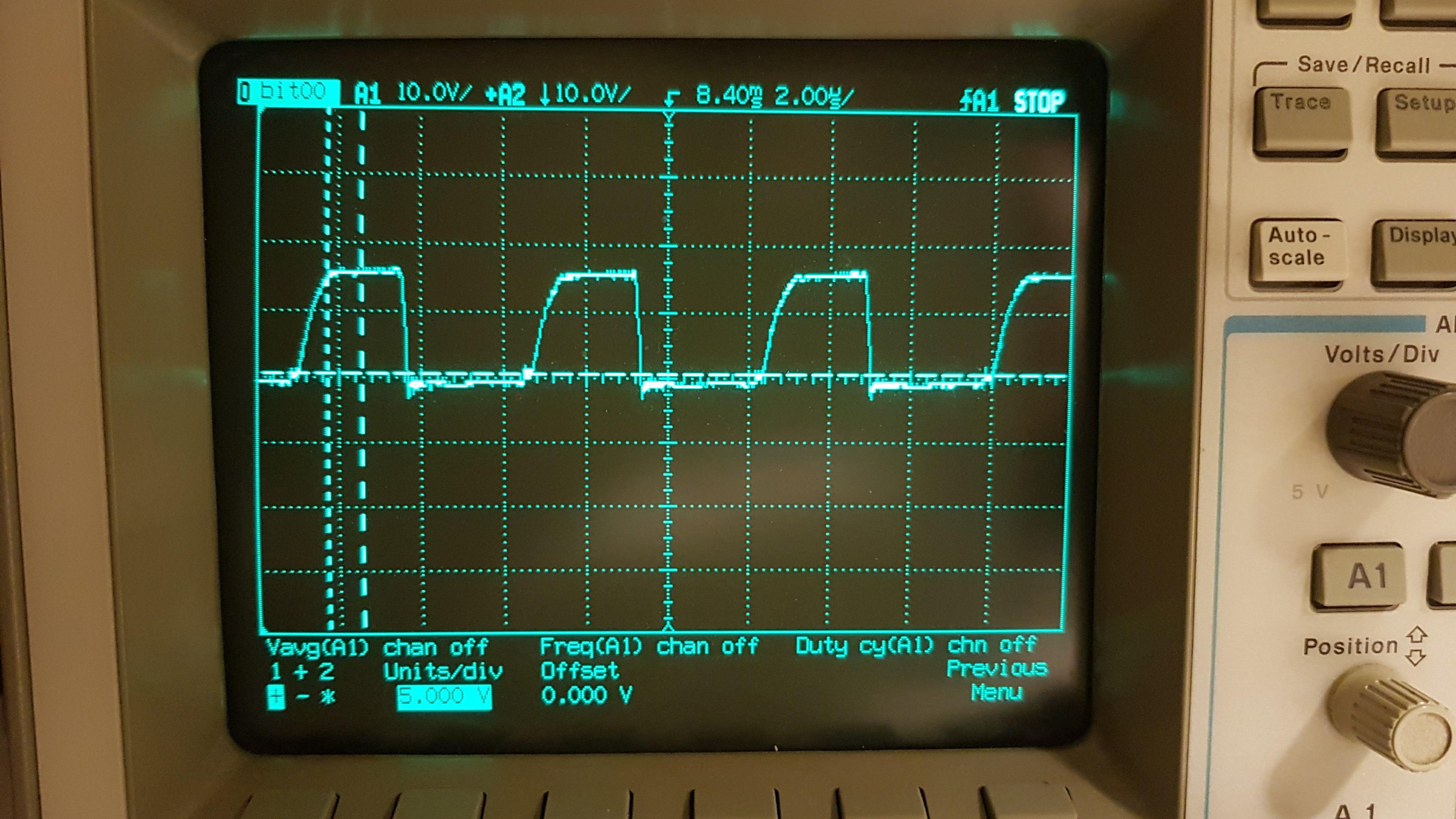

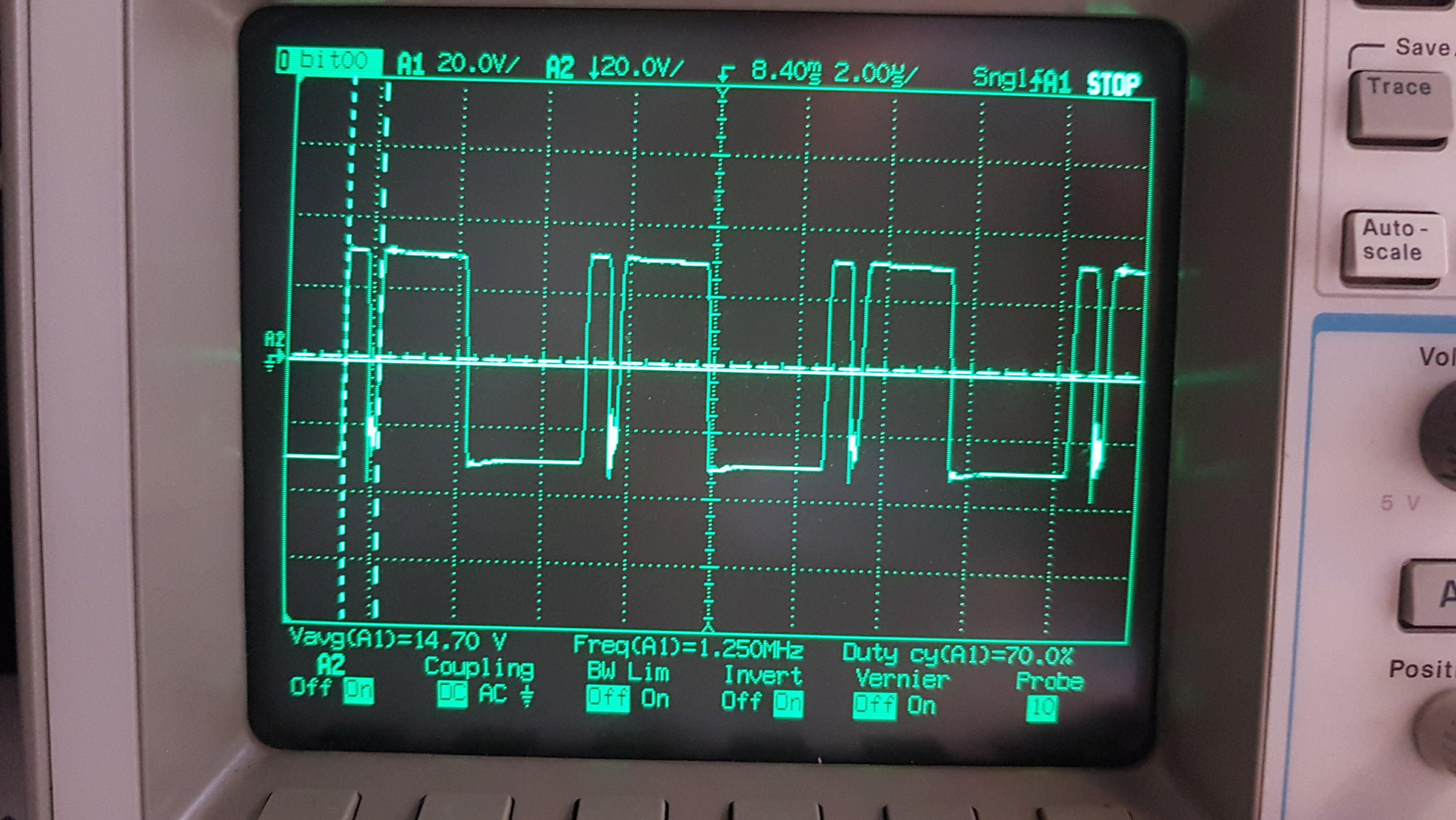

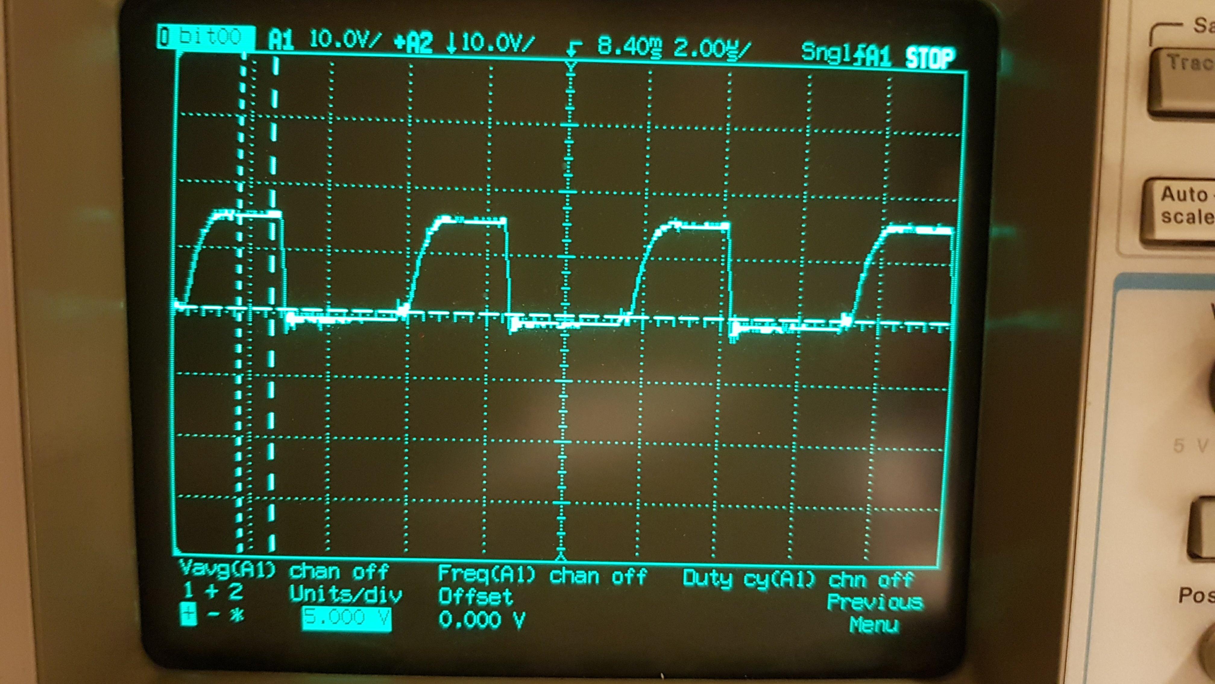

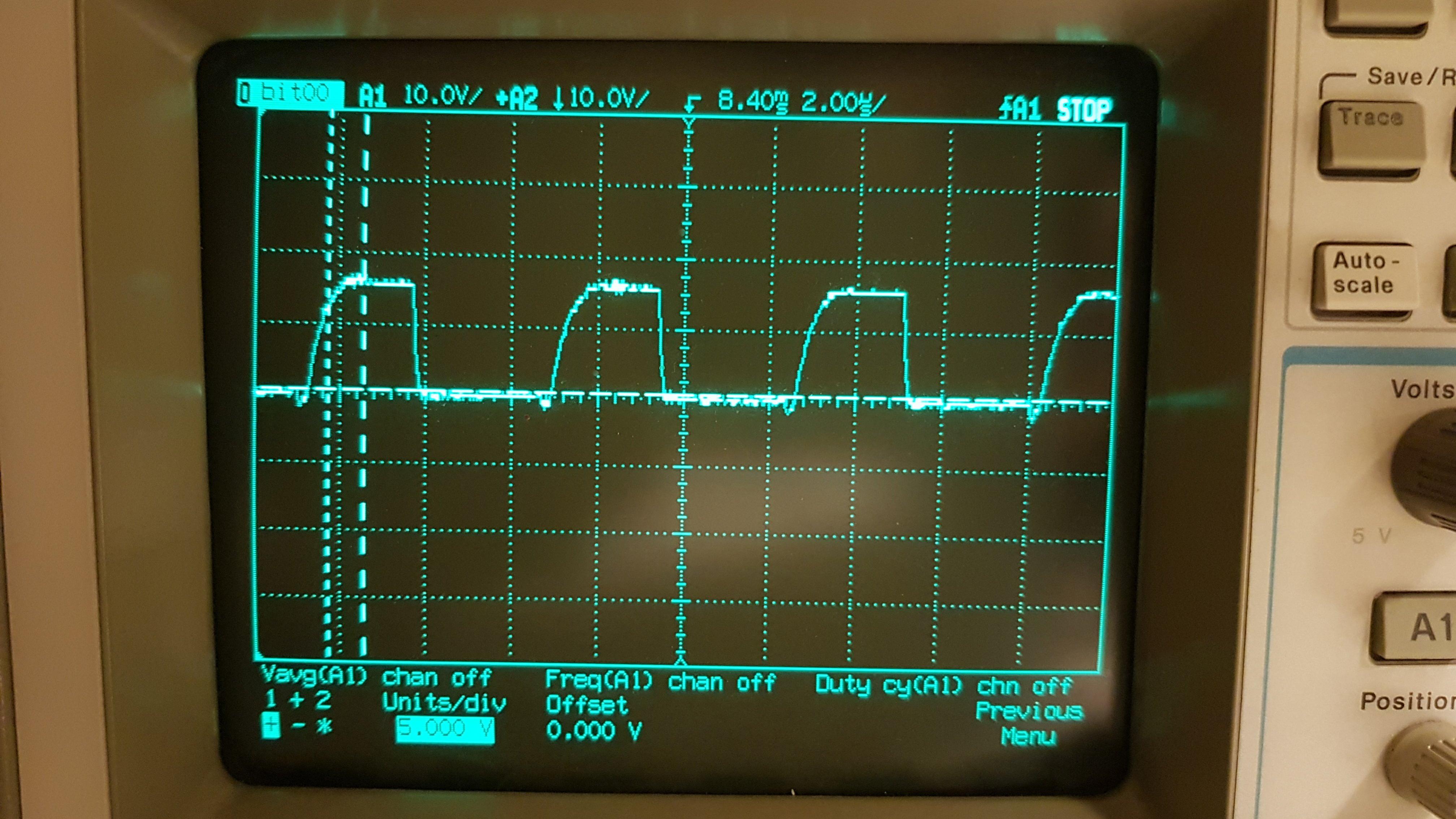

Those look OK as well. Does it possibly oscillate at a different frequency when using the 15v supply?
What's the difference in the drive signals at the output gates when using the external supply and it's not used?
I'd expect the only difference to be amplitude for the high-side FETs.

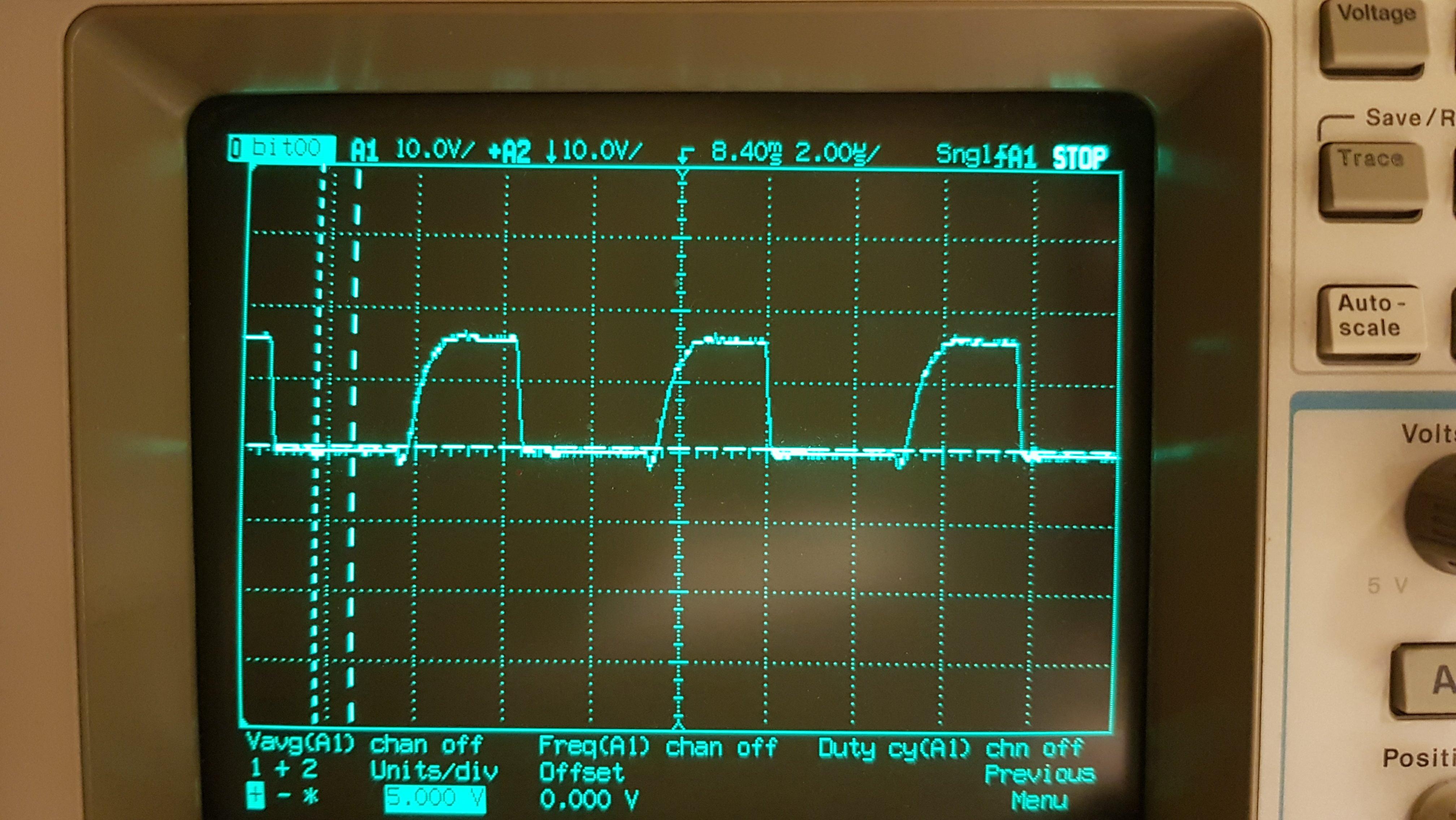

I also notice that during the startup without supply, the signal is very distorted. The clean photo's from previous posts are not constantly this clean.

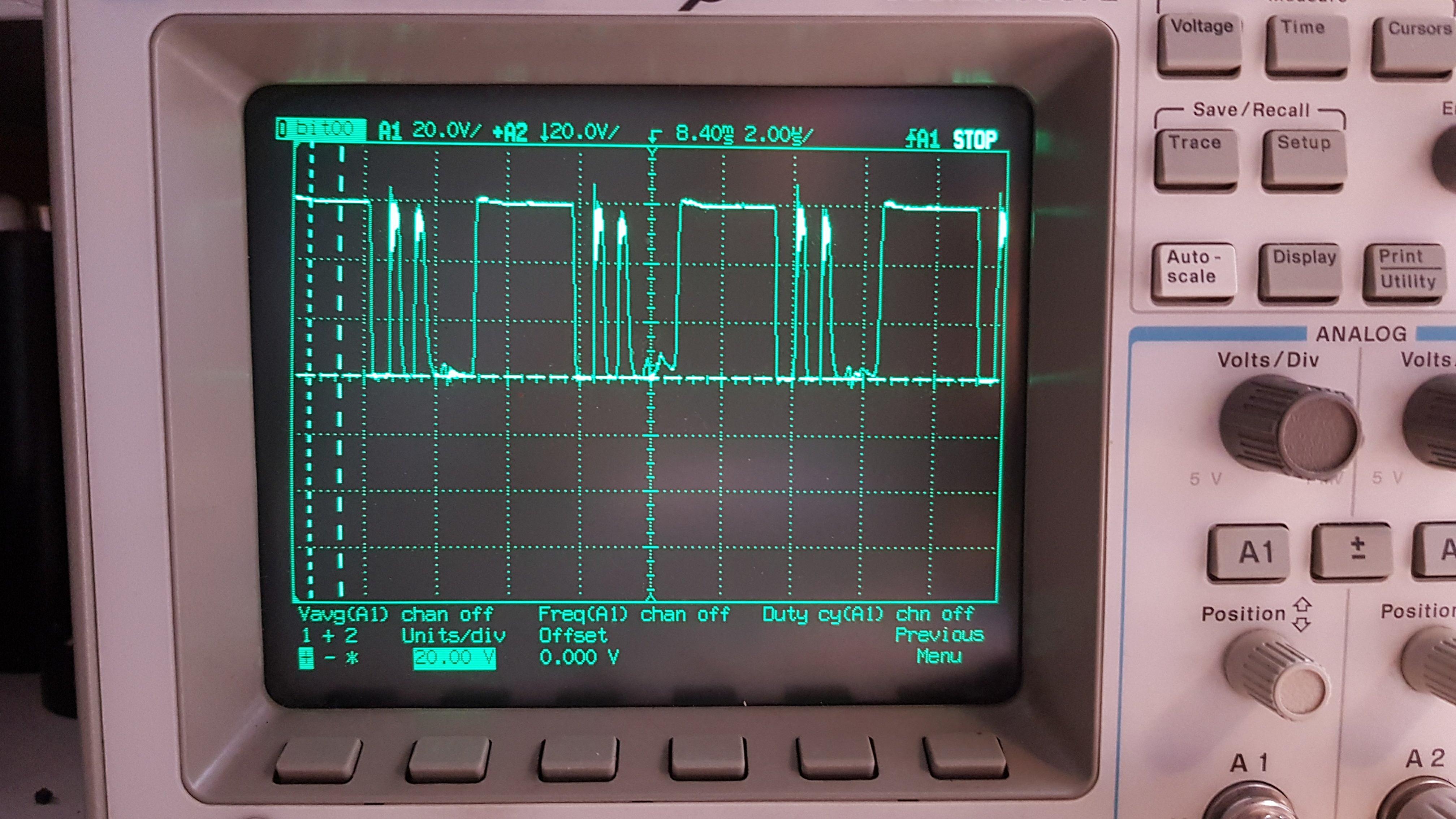

All photo's taken are from single screenshot made with the oscilloscope. In real life the waves are very glitchy.
They also look like this, I took different screen samples from the same measurement: (output fet referenced to secondary GND)

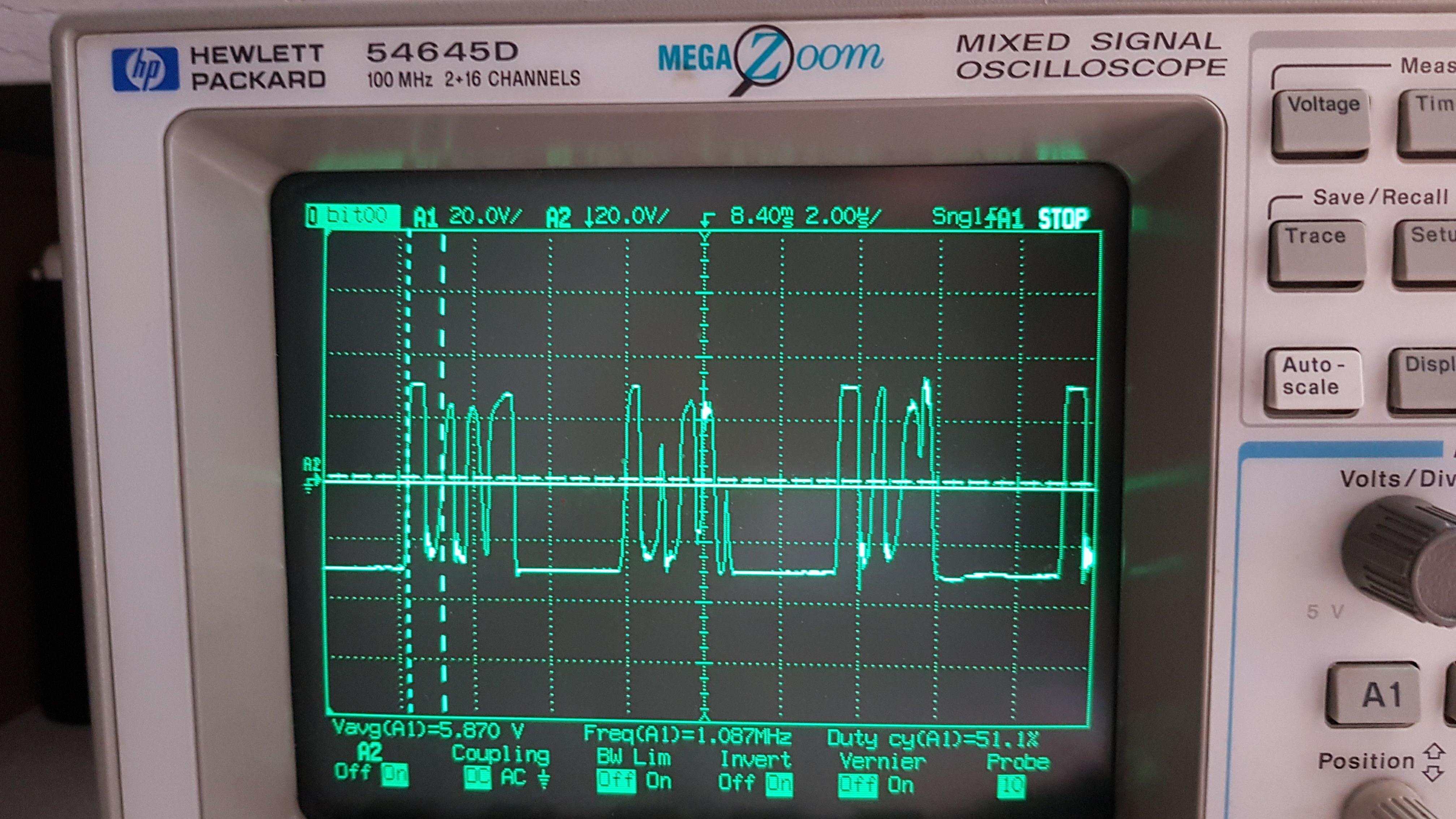

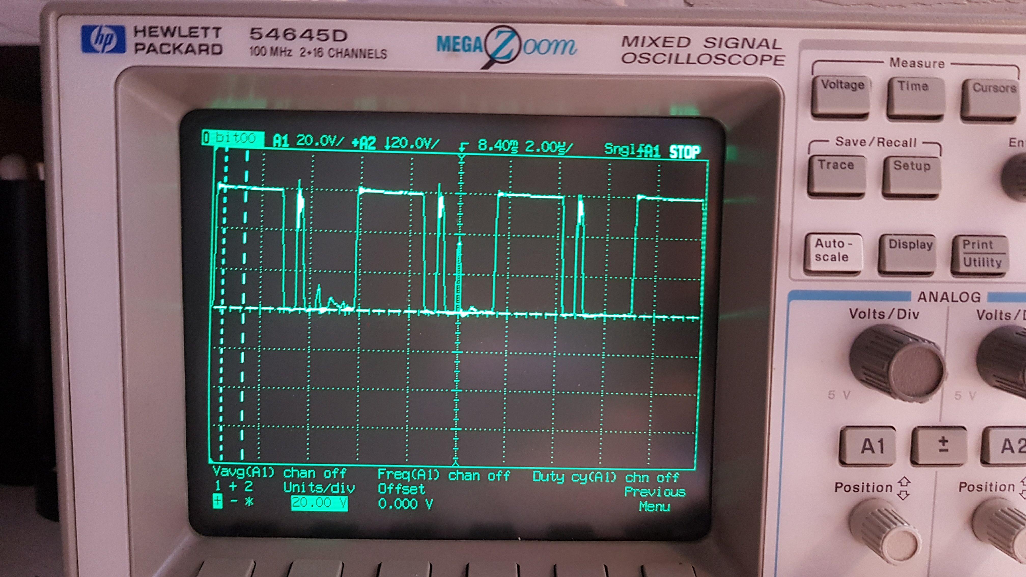

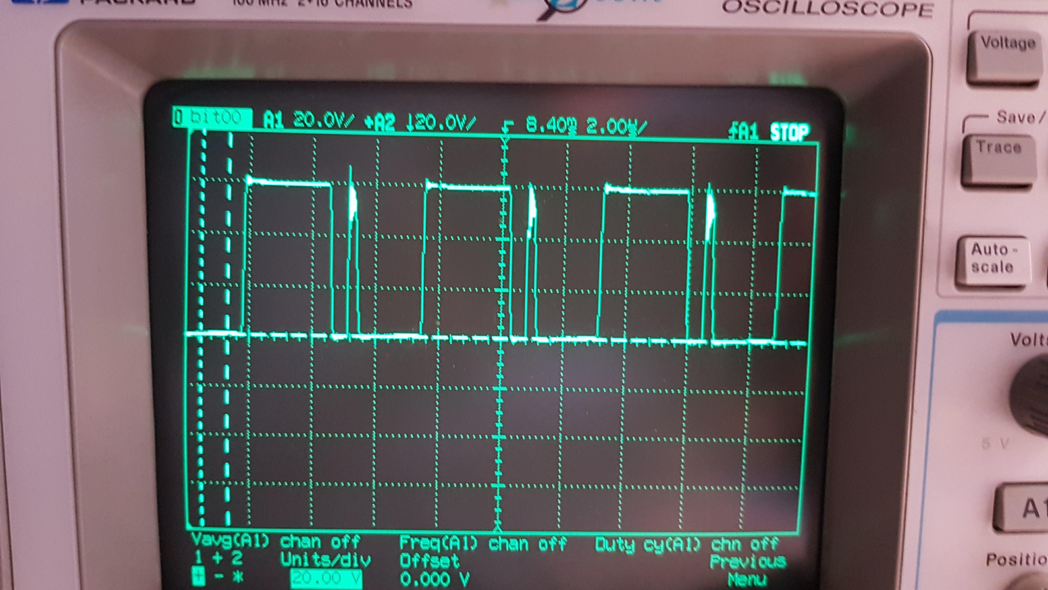

Took some differential measurements between the High-side fets Source and Drain.
Different single shot photo's from the same measurement.
There are ON spikes during the periods the fets should be OFF. I'm not sure if this is a unstable signal glitch or a real signal. I know this scope can take a LOT of samples in each single screen shot, so I don't think it's a scope glitch. Maybe this could be the reason of the extra current draw. The signal is unstable
Correct, with supply there are no ON pulses.
The random pulses seems to be present 90% of the single screenshots.

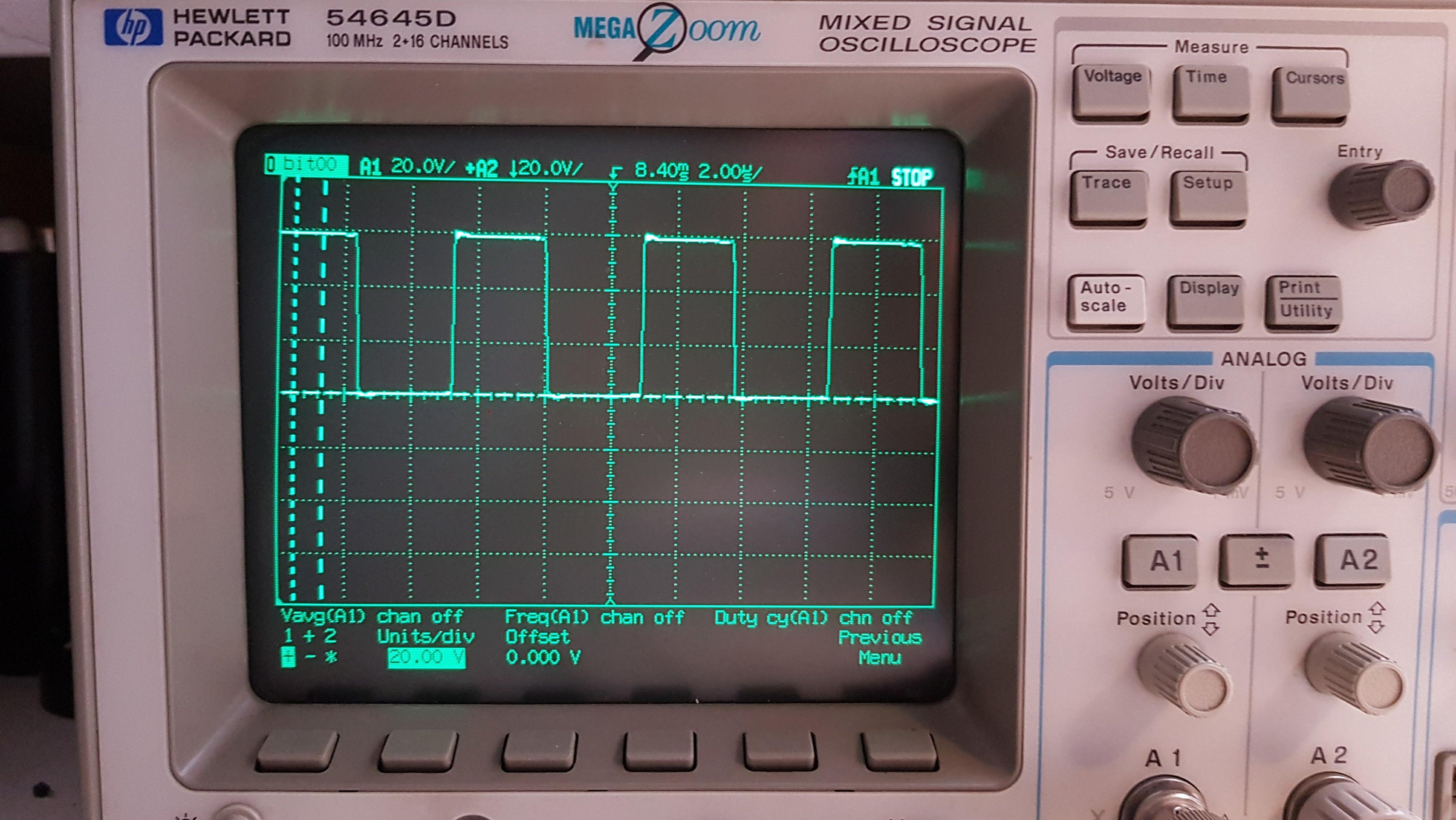

Well, I have to say that I'm confused by your scope images. The spikes I see, in no way, correspond to the drive signals. There is a tiny glitch on the edges of the drive signals but they aren't likely to cause the spikes so far from where they are.
The output fet drive signals are glitchy as well. The same unstable glitch signal is present at the gates of the output fets.
The LM319 Pin12 (goes to the input pin of the driver board, is a clean signal).

The differential signals with the scope free-running never show the spikes. The spikes should show up if the current draw is constant.
